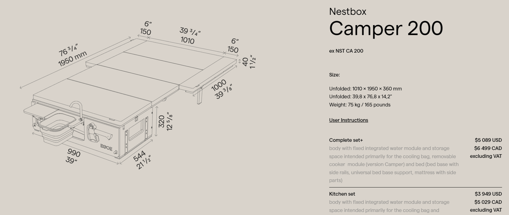

Has anyone tried the Egoe Nestbox Camper Conversion? Their smallest module is listed as fitting the Escape, so it would seem it might fit the BS too. Though the BS is a bit shorter, so it might not fit, but looking at their list of cars, it seems just as likely that they just haven’t updated the specs. If it does fit, this seems like a good alternative to a RTT. Thoughts on feasibility?

Thanks for sharing the dimensions. Agree, looks like the 6” flaps might not be able to fold down but otherwise, looks likely. Only dimension I’m not sure about is the depth. Haven’t received our BS yet, or I’d take measurements myself.

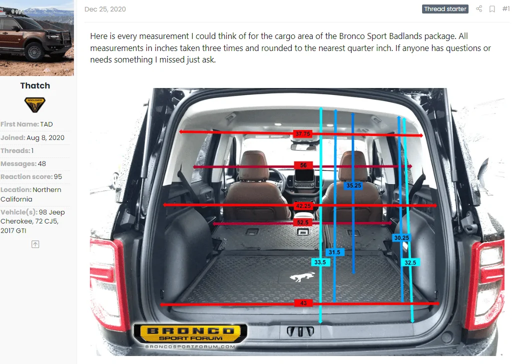

The depth is what I referred as length which is 76” is likely to fit. Click the link. That thread has all the dimensions shown.

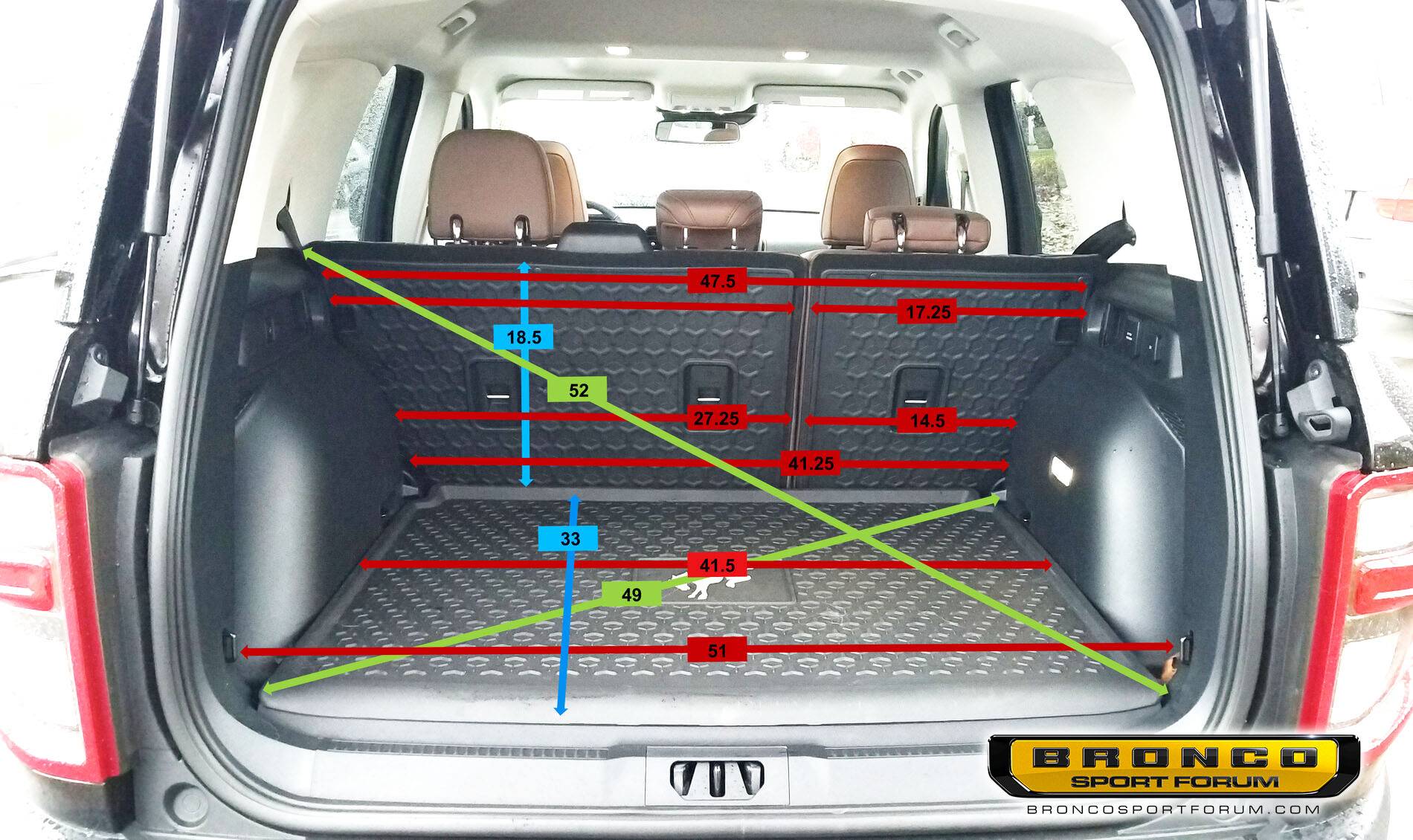

The dimensions not shown are the width between the wheel wells and the width between the ledges for cars equipped with the cargo management system. The ledges on the wheel wells that hold the platform for the cargo management system are around 10" off the cargo floor, and the distance between them is 39".
Dimensions between the wheel well seems to be 41.5"

and yeah, the CMS shelf ledge will take away about 1" on each side. so the narrowest point of the rear trunk area would be about 39"

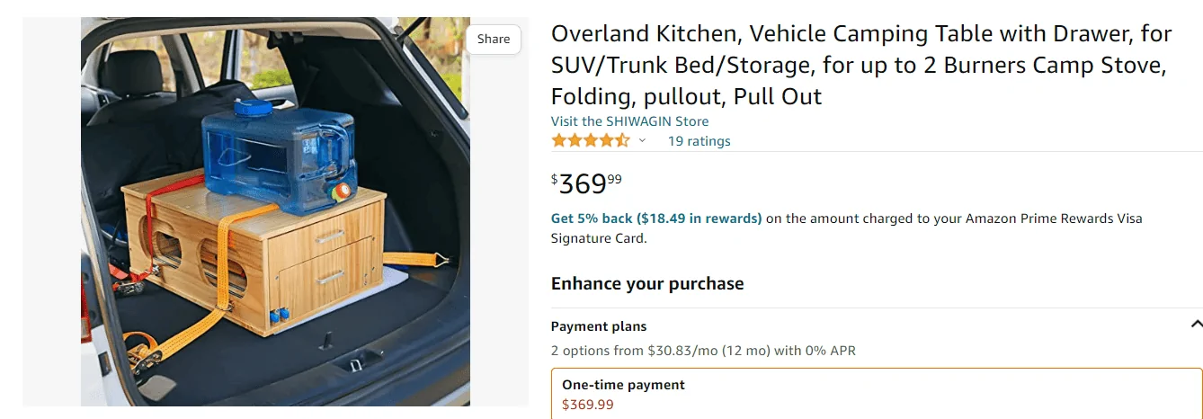

but how about this?
Ford Bronco Sport Nestbox Camper Conversion ⛺️ 1666232656330
https://www.amazon.com/Overland-Kitchen-Vehicle-Camping-Storage/dp/B09XQ2MQGV/ref=sr_1_1?crid=149HM9SAU4L1J&keywords=car+camp+kitchen+in+trunk&qid=1666231940&sprefix=car+camp+kitchen+in+trunk,aps,174&sr=8-1&ufe=app_do:amzn1.fos.ac2169a1-b668-44b9-8bd0-5ec63b24bcb5
it takes up exactly about 1/2 width of the rear area and a Deepsleep mattress solo can fit on the side. Perfect for solo sleep in the car.

Thanks everyone for the measurements / responses. Super helpful. FYI, I did reach out to the manufacturer and they said the BS isn't listed as compatible because they haven't tested it, not because it doesn't fit

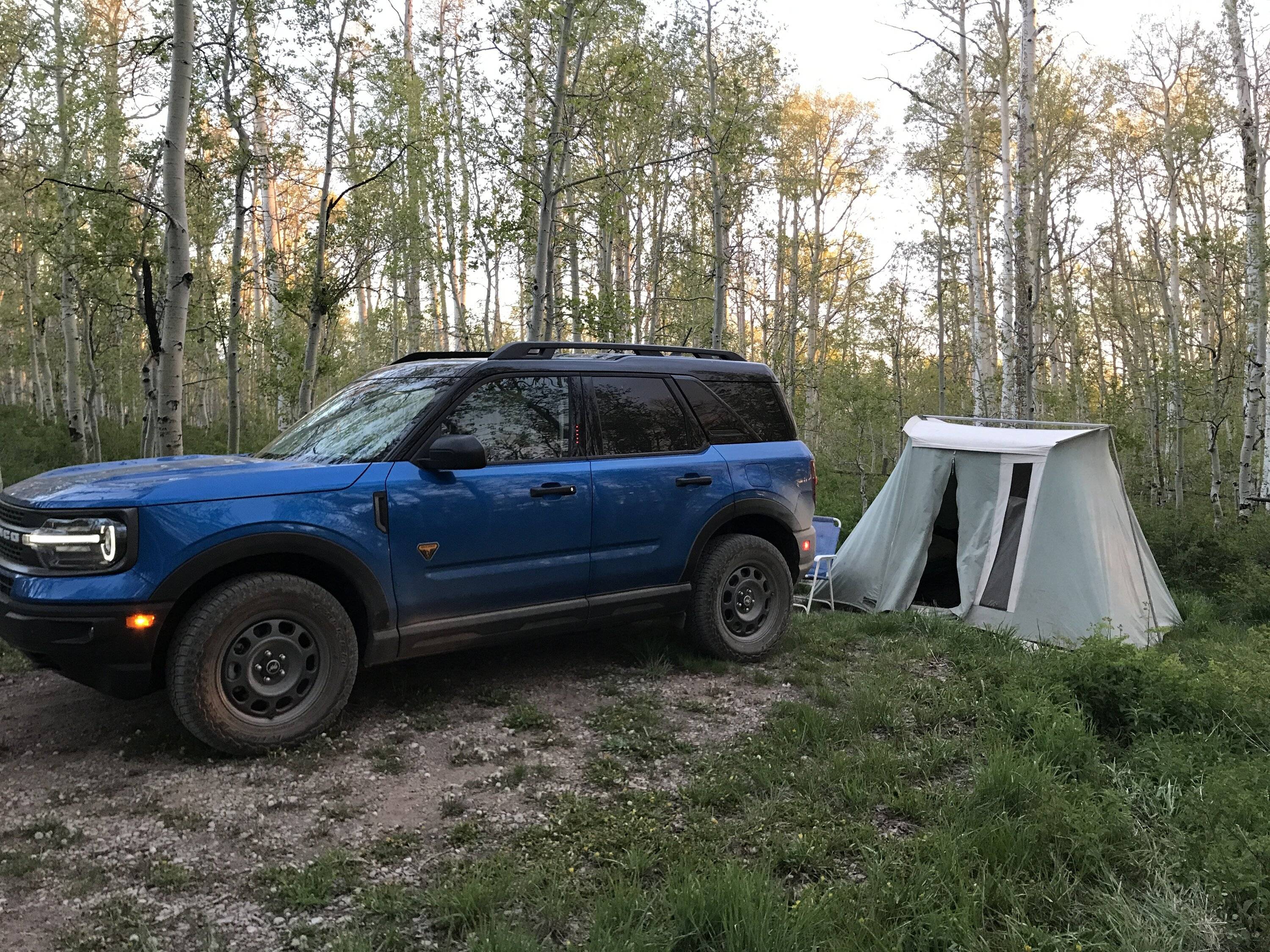

Wow! That is cool, but the price is out of this world. I have camped in mine a few times in the desert. It is o.k. for just an overnight in warm weather, but I had to hang mosquito netting over my bed. It was too hot to close the back and doors, and my feet got a bit wet when it rained.
I have a small (7x11') canvas Springbar tent, which is big enough for two cots and a small table for cooking. Tall enough to stand up in, holds up in 50 mph wind, and has good ventelation and mosquito netting. It is by far the easiest tent to set up I've ever seen or owned. It has held up to snow, rain, and hail without a drop of water inside. When the weather is cold, rainy, or windy, it is so much better than sleeping and cooking in the BS.
I picked up one of those fold-up kitchen table set ups at Saver's for $16. After a little repair it works great. It is compact and fits nicely in my tent.
