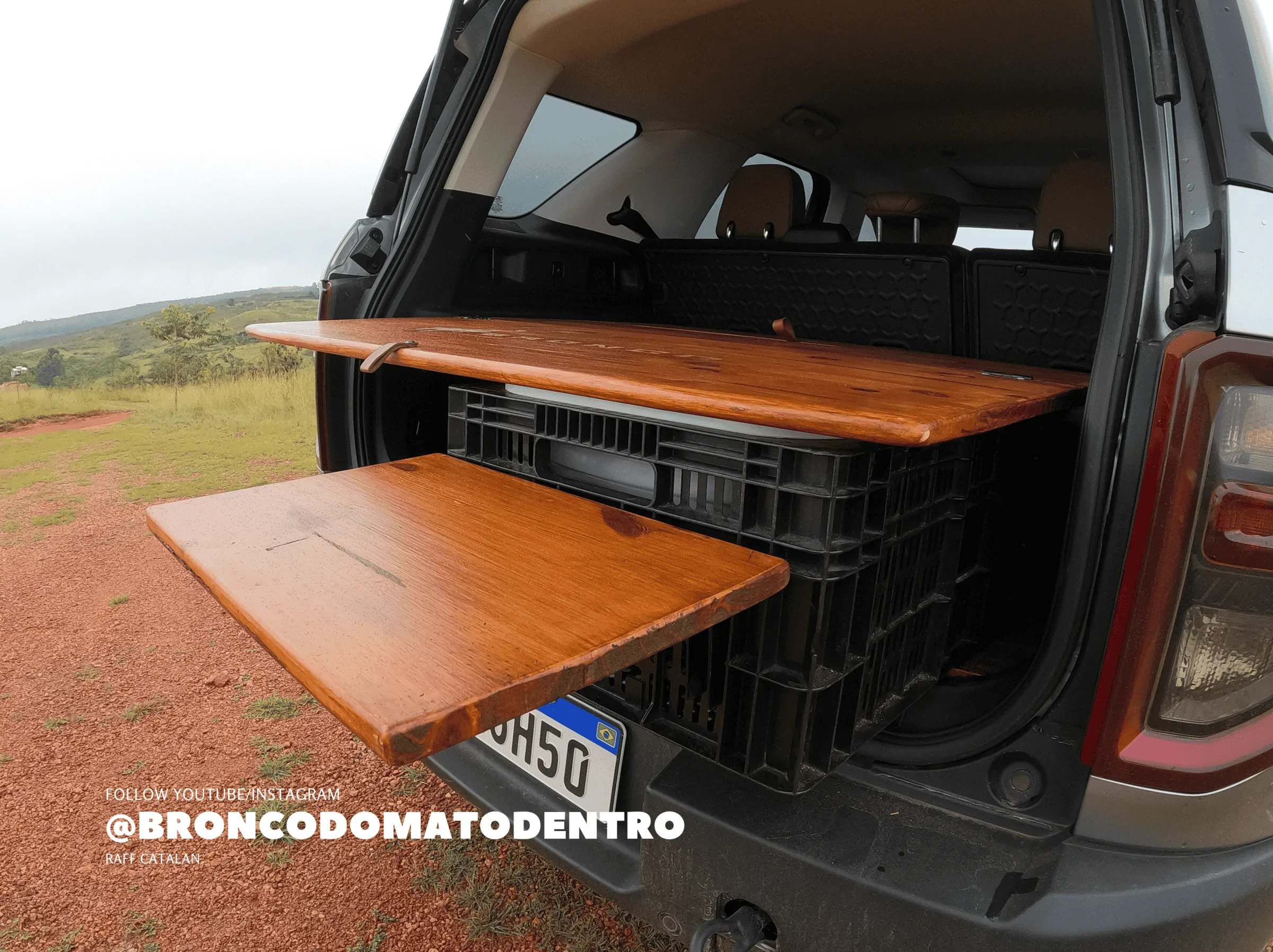

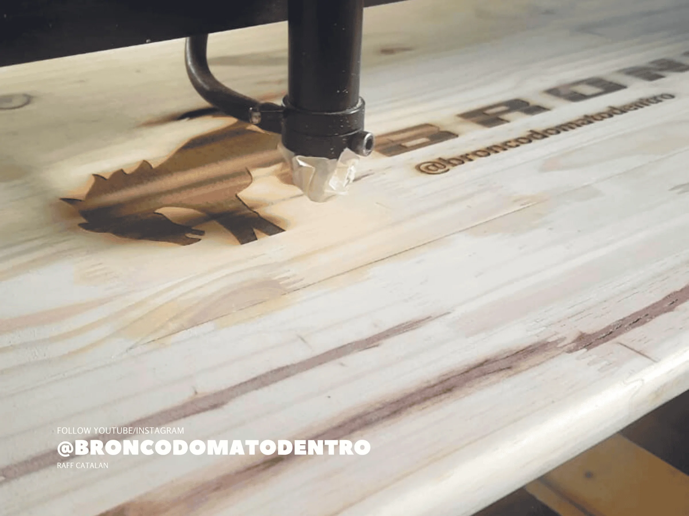

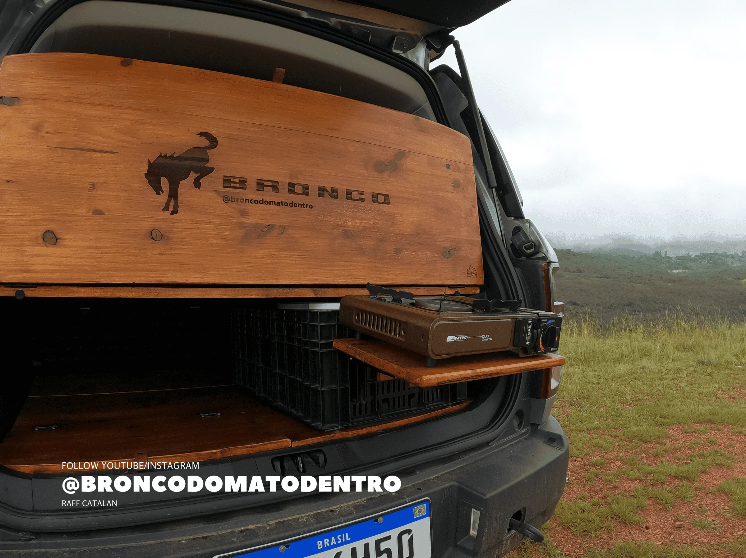

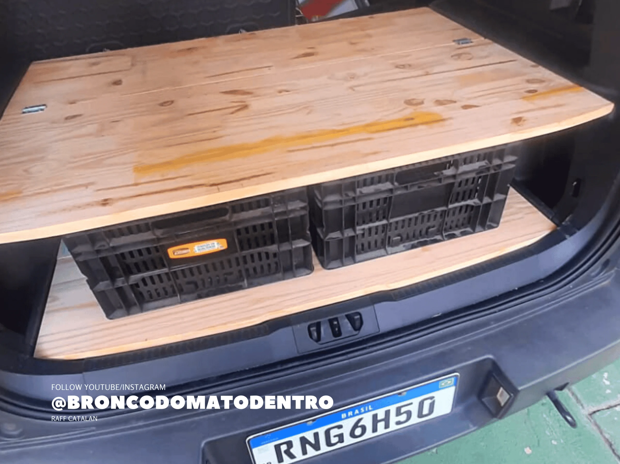

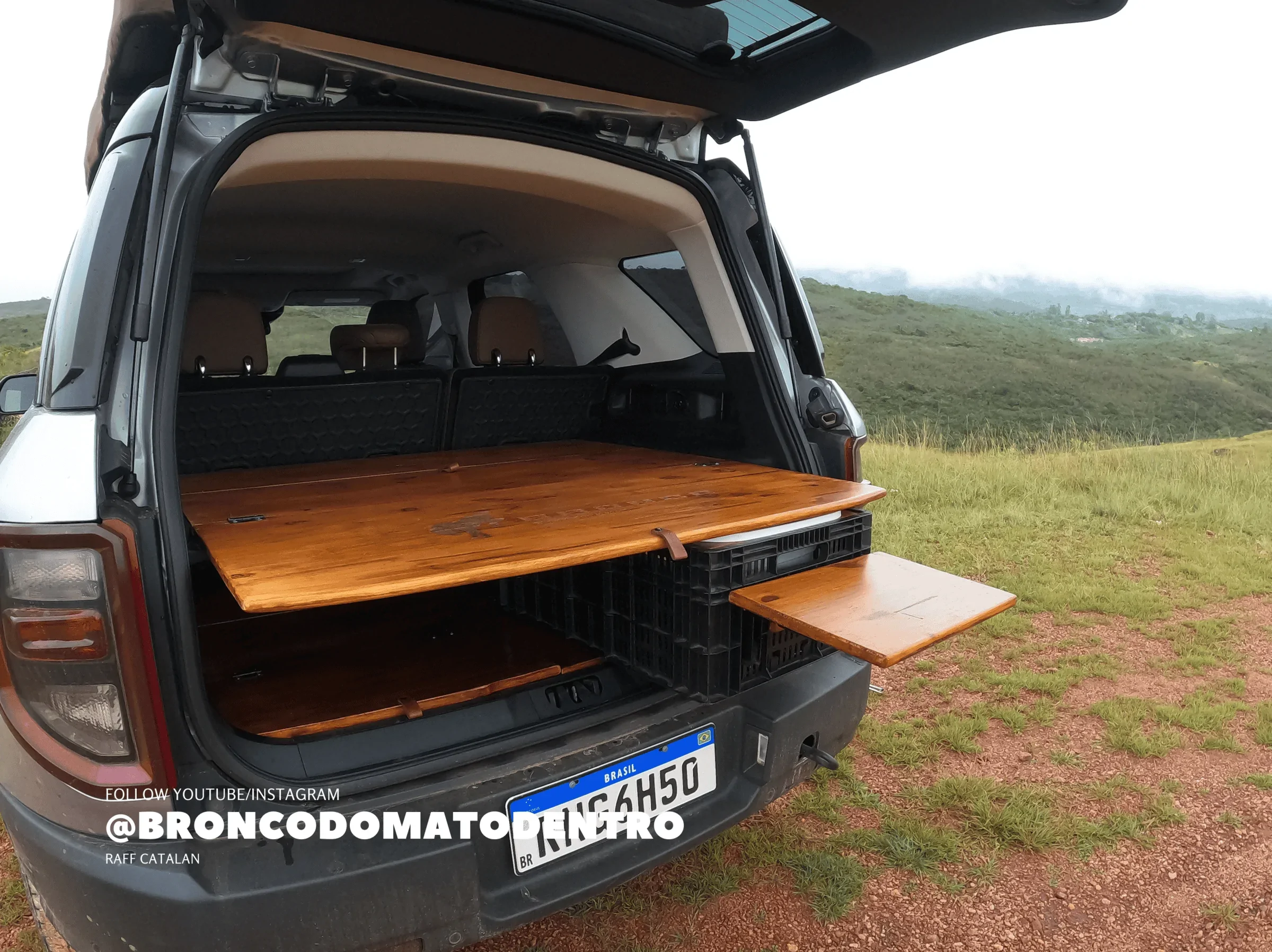

Now I'm going to show you my project.
My project is to transform Bronco sport trunk in an overland trunk. I used Wood Bronco created in 1974 as a reference. This model has the same wooden parts that are similar in my project.
if you need click to translate video subtitle to english.
So.

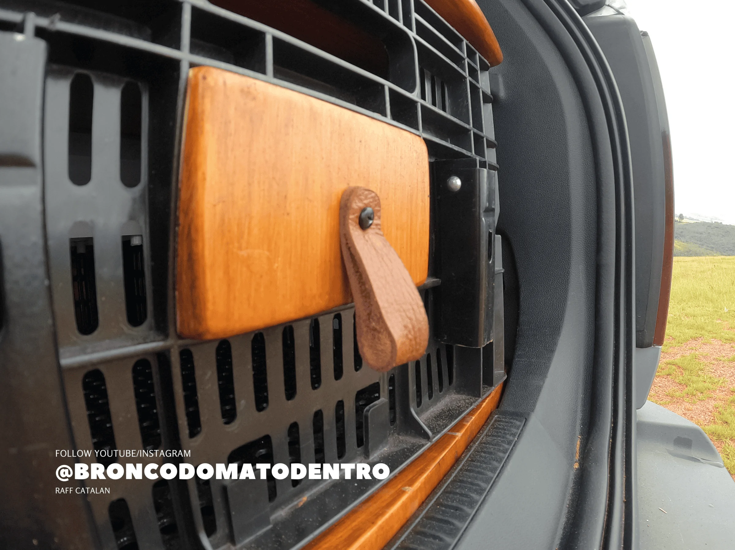

I removed all the original table parts of the trunk and changed them for wood but didn't lose adaptability. And it even created new possibilities and modules to use in overland situations.

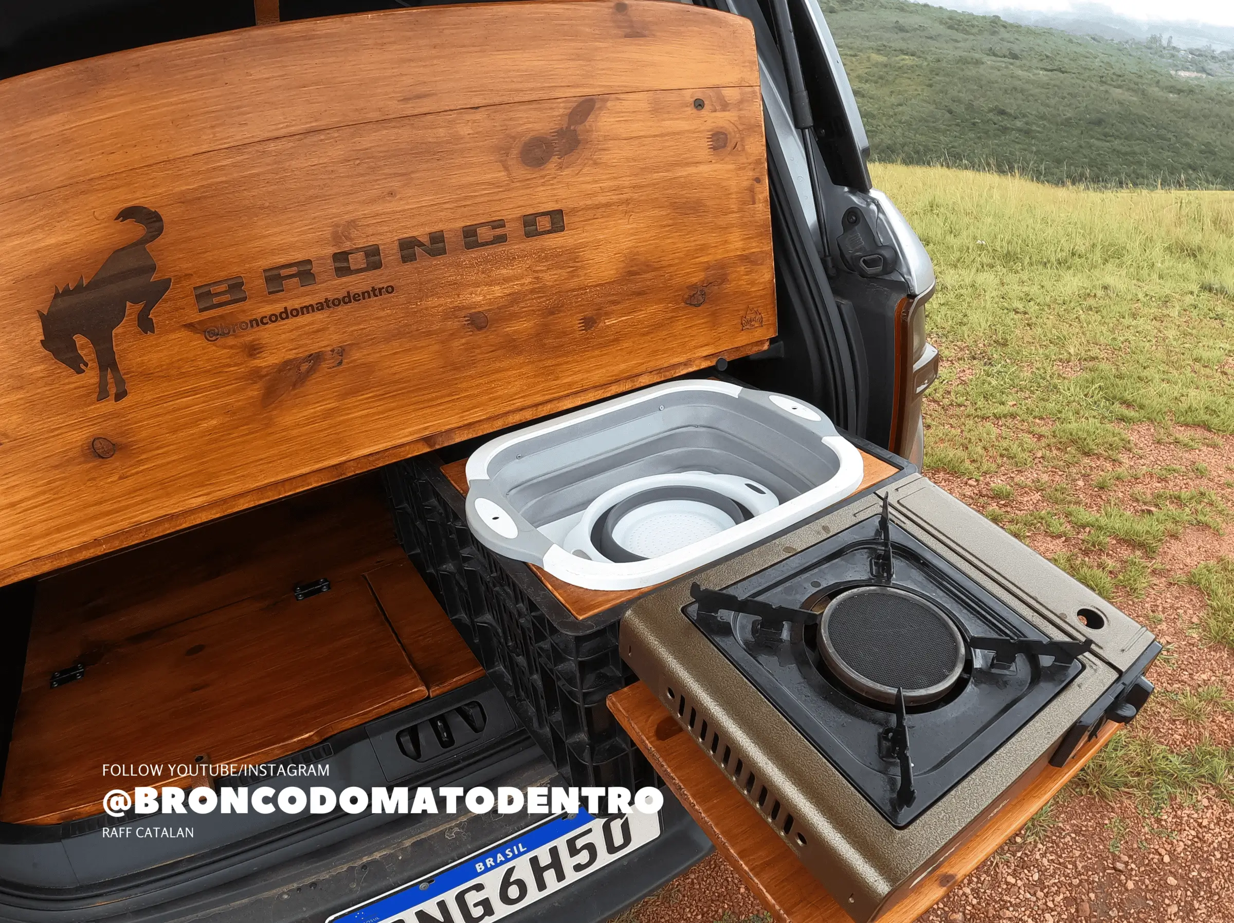

In my overland car, I use a simple cooker and I need food to prepare, for that I use a plastic supermarket box to put my things in and to create a drawer. This drawer is also used to support the cooker.

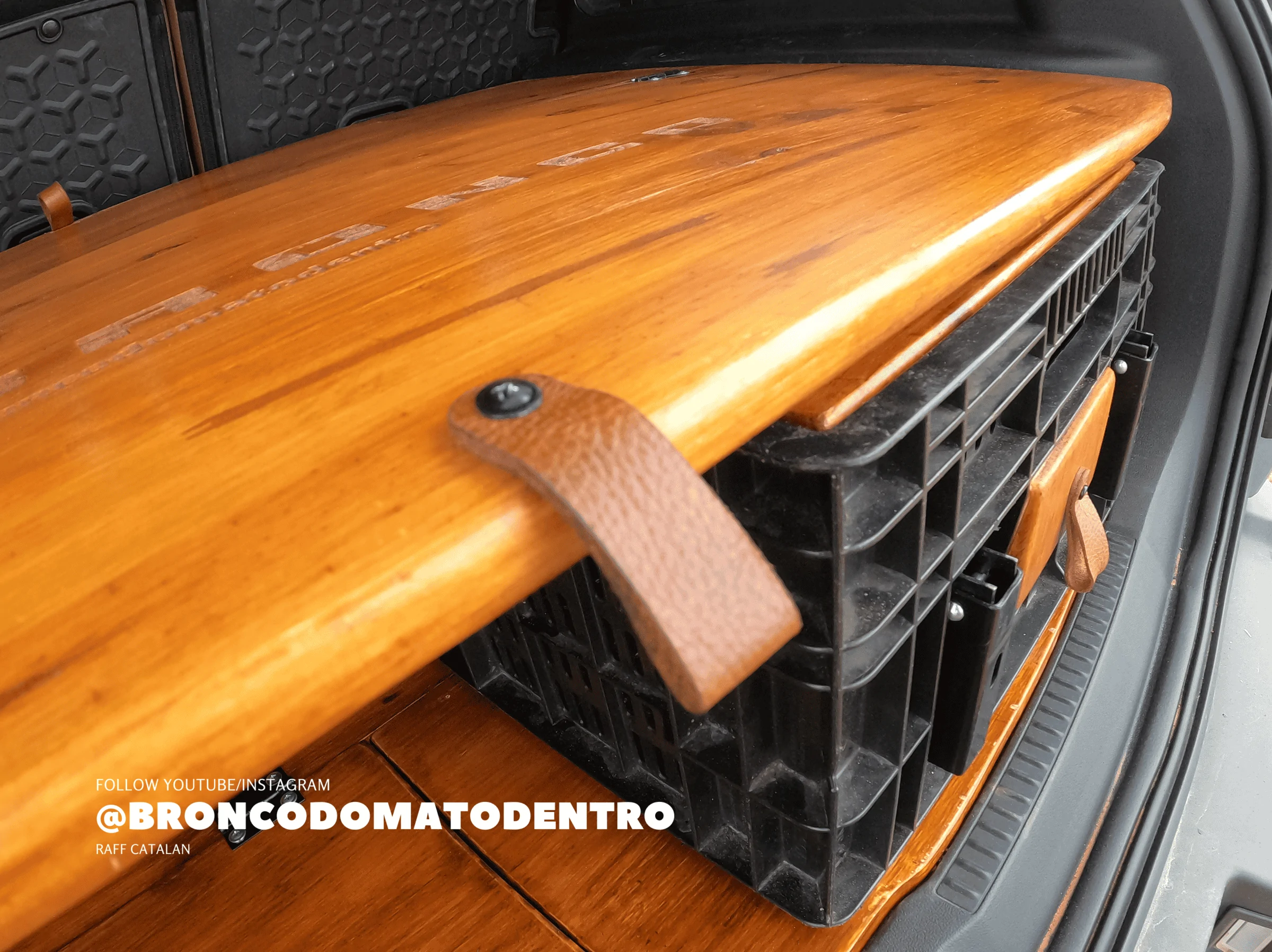

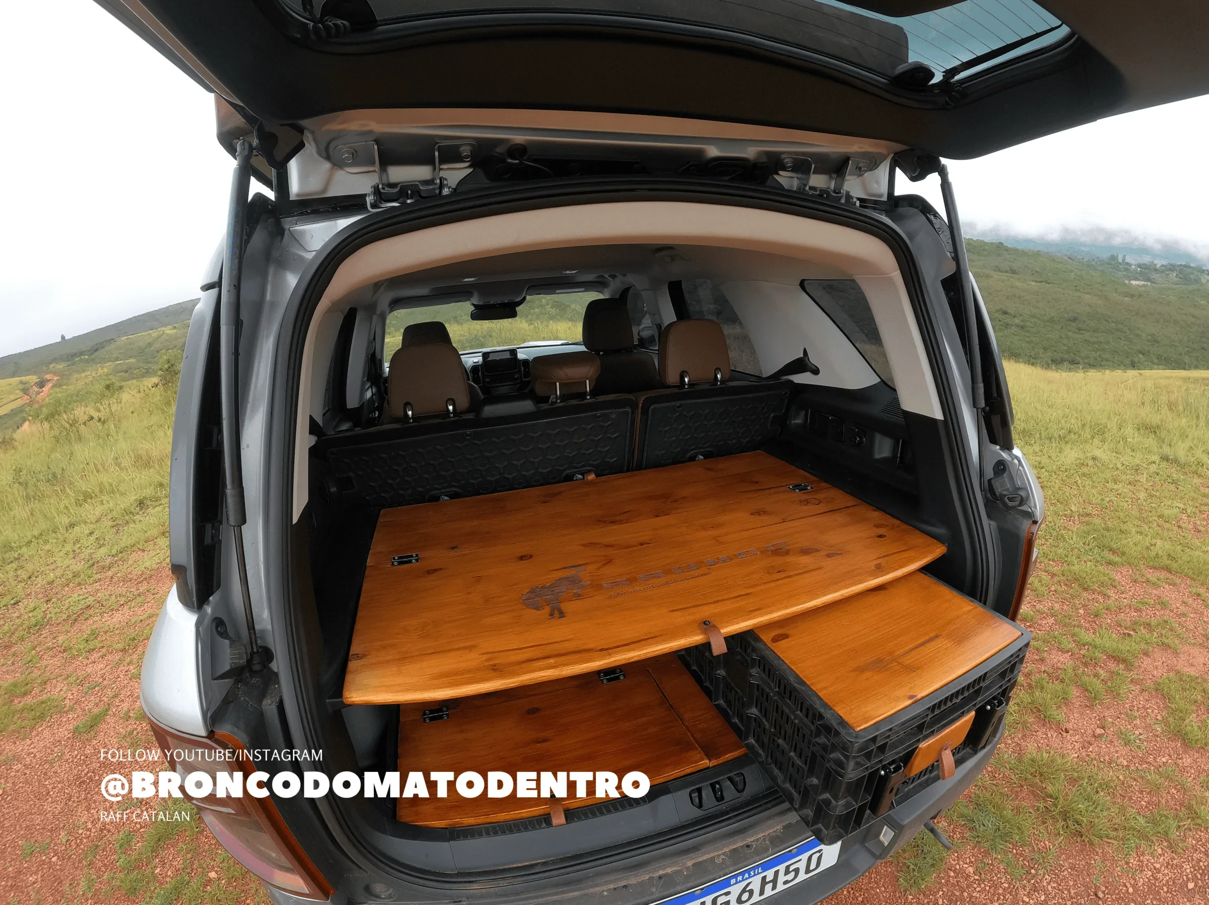

At the top, I used 3 wooden parts 1,10x30cm to create a new table. Under this part, I used 3 more wooden boards to create a table similar to the original.
When opened my new table I gained another 35cm and I don't need the bottom support of the table, as in the original.
Then, I made a support to transform box into a drawer… We'll see it later.
To use my table, I only need to pull the parts up and out, doing that, it's possible to get 35 more cm than the original table and I don't need the table legs to suport it anymore.

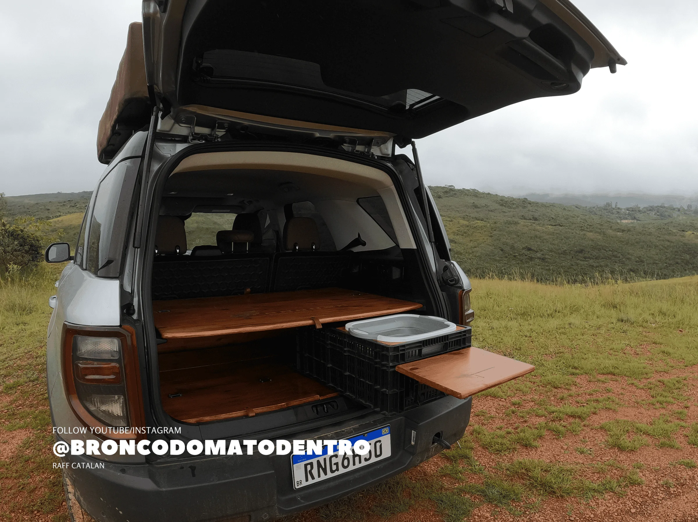

I removed this part to create an external suport for the cooker or a suport for other things and I put this other part to use for washing things, like a sink.
See how it turned out and if you want to see more details, ask me!
