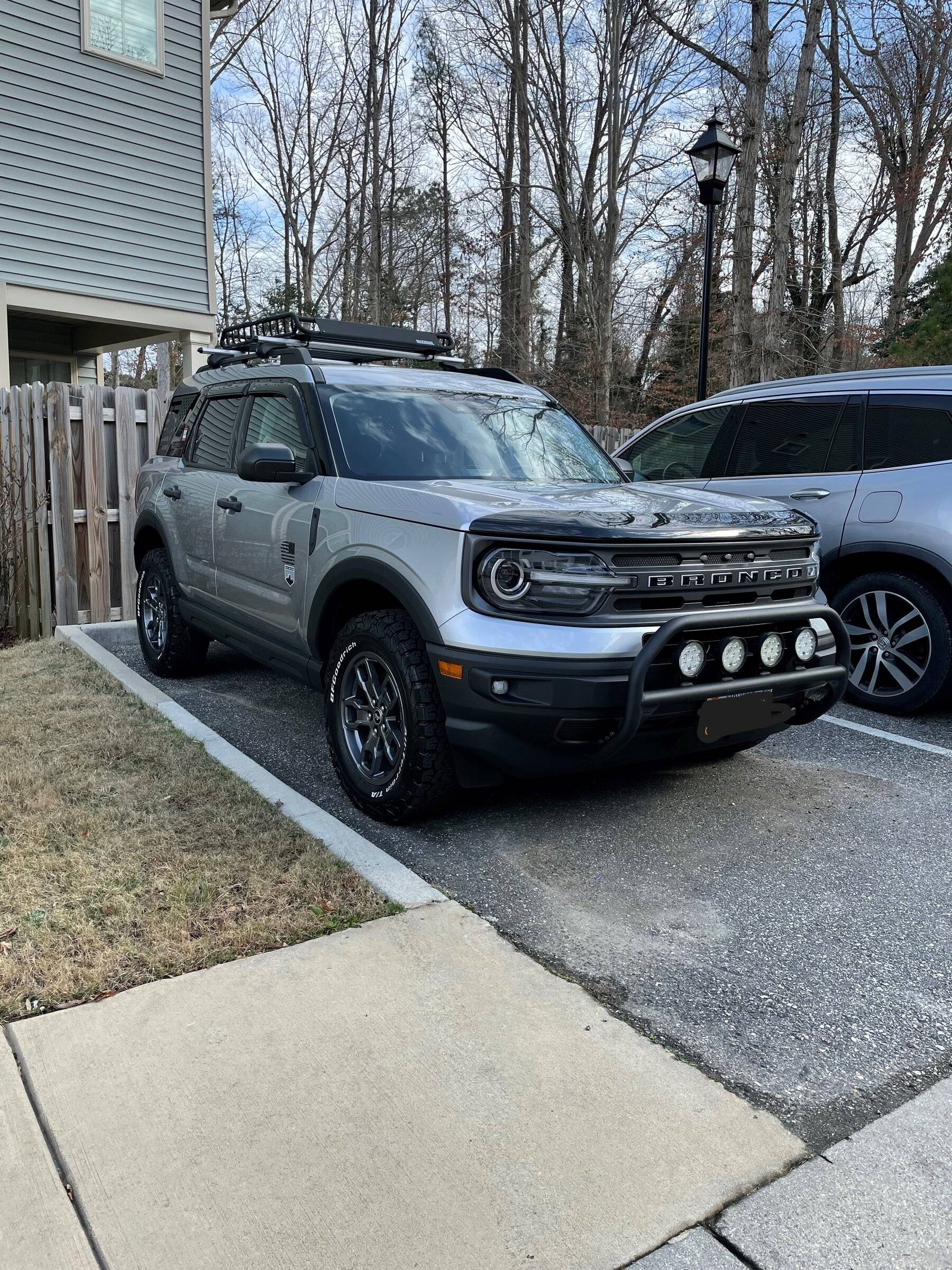

Looks GREAT! Do you have a lift and or bigger tires? Where did you get the black bronco letters and would you recommend them?
Yes, it has the Rough Country lift and a set of BF Goodrich 245-70-17 tires. The Bronco came with white letters on it. I was not a huge fan of them, so I purchased a kit of black vinyl letters to augment them a bit and mute them.

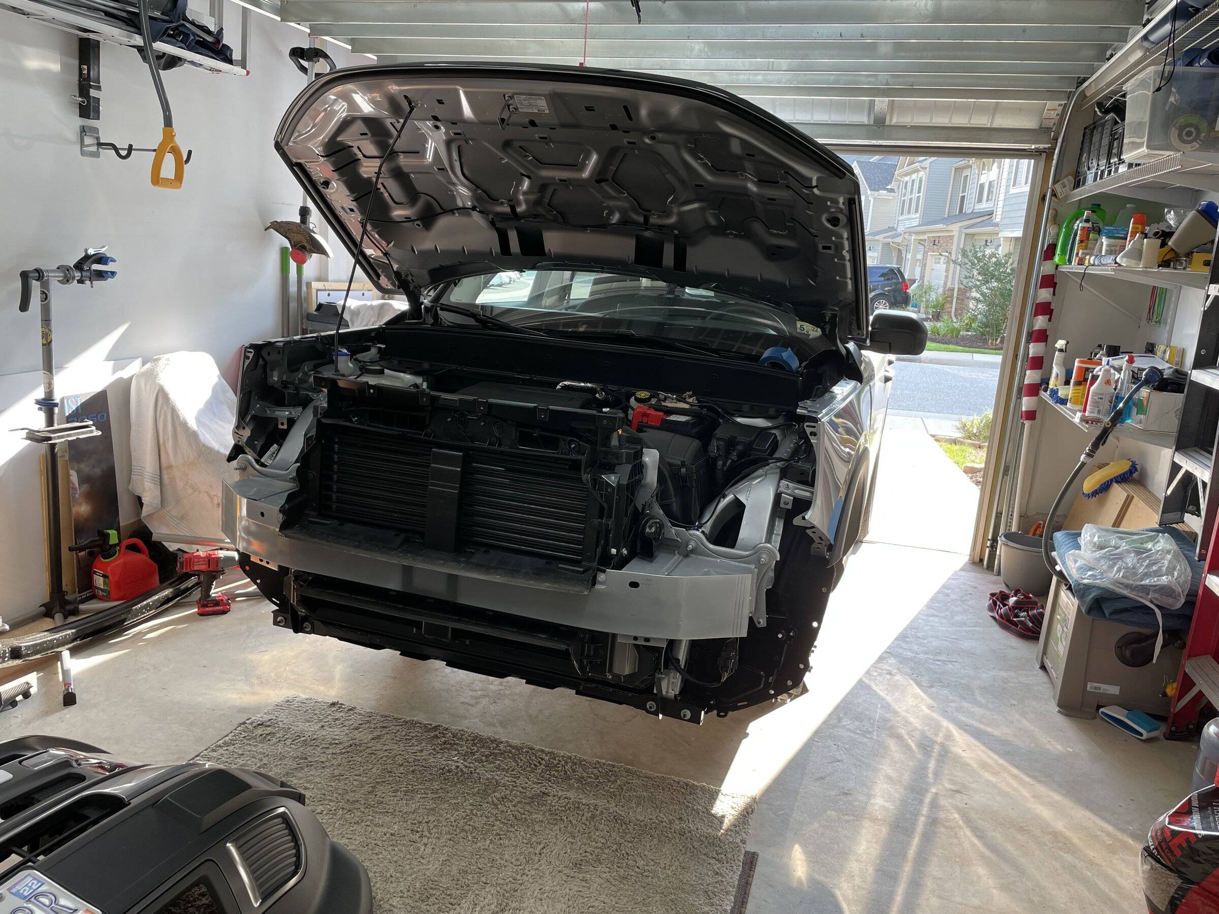

Love the light bar. I’m interested in a nudge bar without lights myself but don’t want to have to weld or fabricate just want to pop it on.
This one is from Rough Country (https://www.roughcountry.com/ford-nudge-bar-51040c.html?find=2021-ford-bronco-sport-4wd-759082)
I wont lie and tell you it was easy to install. You have to take the entire front of the Bronco off the vehicle. Once off you can mount the steel mounts to the frame. You also will need to cut two 4" x 1/2 inch slits in the lower valence to allow the mounting bracket to pass through. It then mounts using 4 bolts to the nudge bar. All in all, it took me about 3 hours to install in my garage.

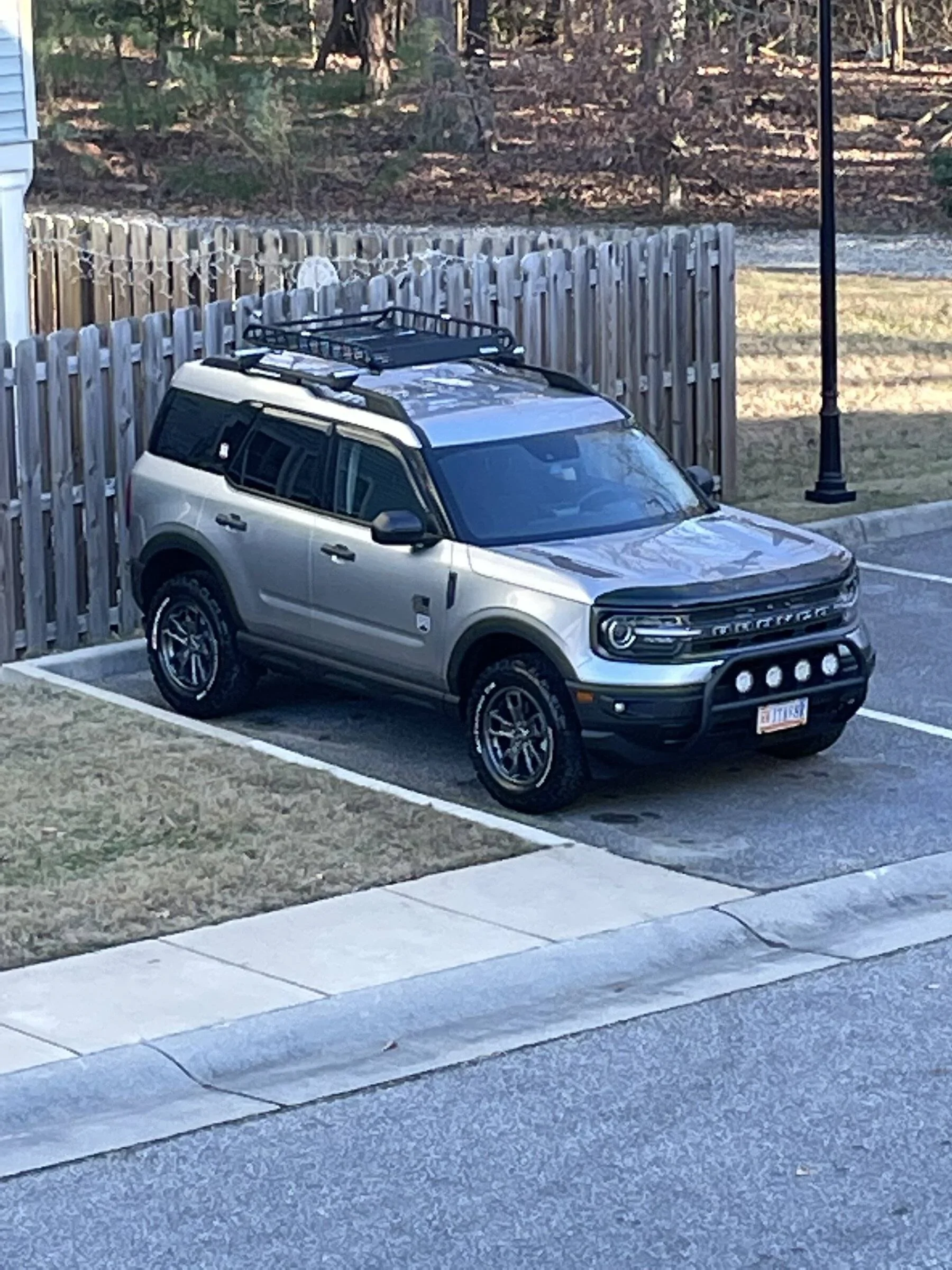

any rubbin with the 70 series tires? i'm getting new rubber this weekend (245/65/17) and was really contemplating a 70 series .....
Do you think there 247/70s can fit without the lift? Any rubbing? Maybe just at full?
