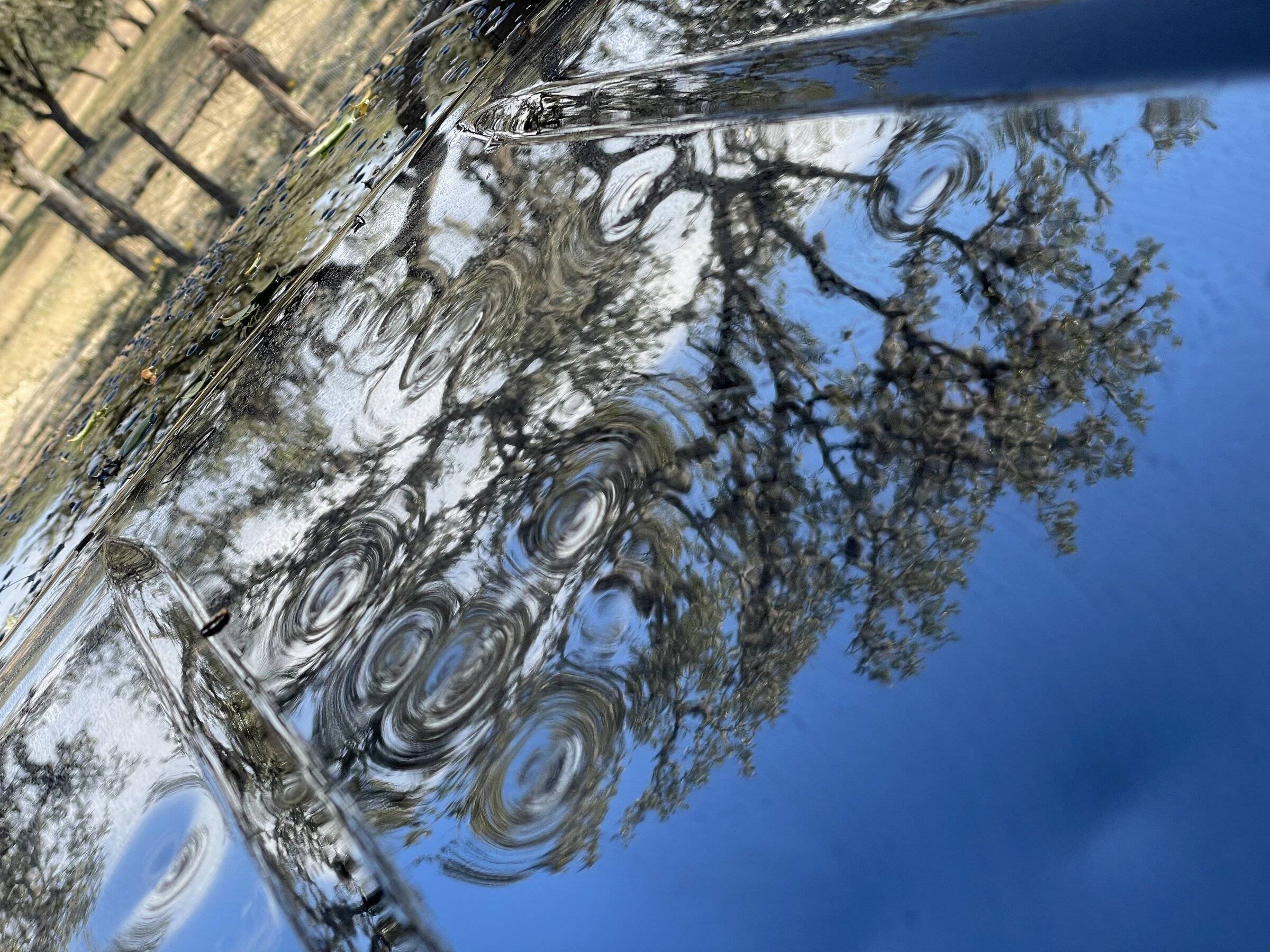

I've owned my car since July 29th, already put 10k miles on it. This Saturday, I was in Hondo, Texas visiting some family. My cousin offered to drive his F-250, but it has really bad aftermarket suspension so I said I would drive instead (whoops). I was finishing up taking a shower when someone bolted in and yelled "HAIL". I almost ran out after the car until I saw the hail was near baseball-sized, so that would have been a bad idea. I could really do nothing but stand there and watch my car be destroyed.
If you're curious, the Bronco got it the worst by far. The other cars were no more protected and sustained far less damage (GMC 1500, Ford F250, Chevy Traverse, GMC Sierra). Every panel on the bronco is steel apart from the hood which is aluminum.
5 minutes of small baseball to large golfball sized hail. 2 short videos of the storm are attached, including dashcam.
Damages:

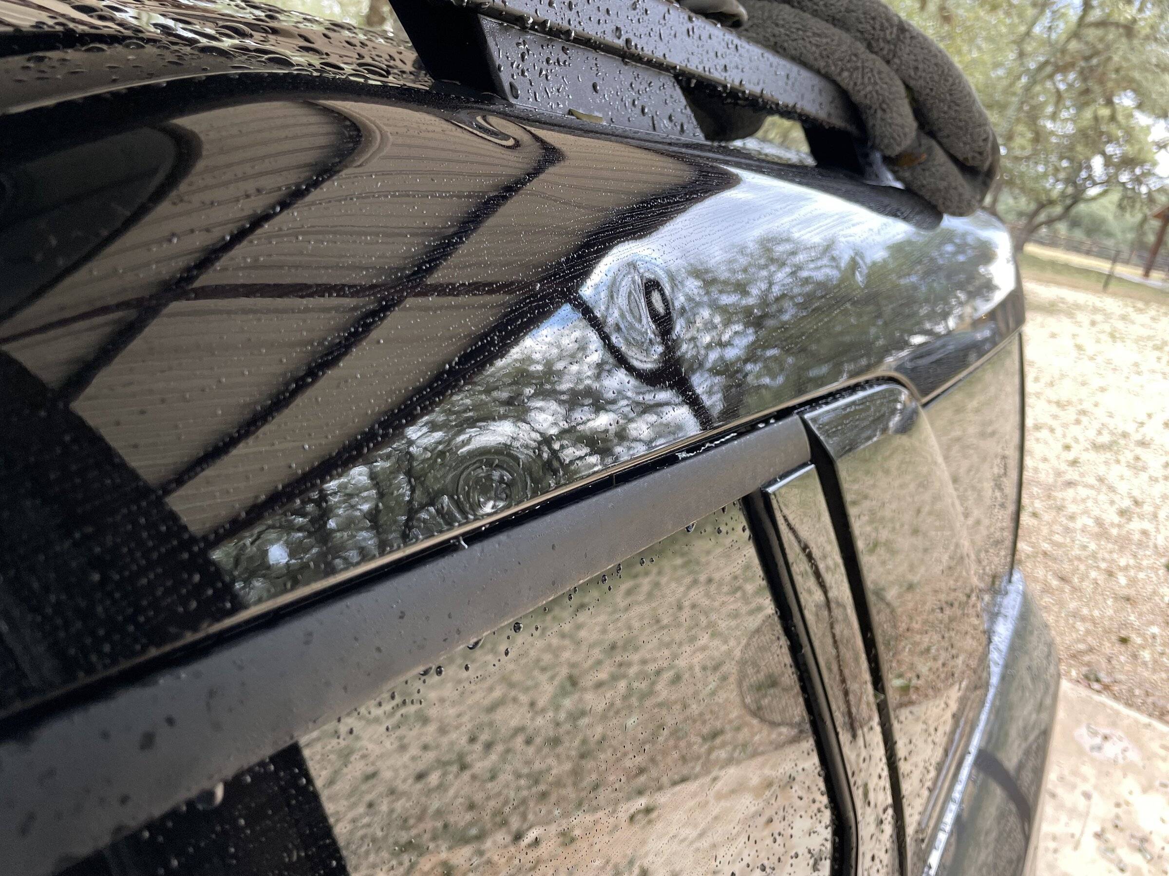

countless dents (over 300 on the hood alone, at least 25% have creased and are irreparable), cracked Windshield, cracked third brake light. Every single panel on my car has a dent. Miraculously, my moonroof survived. It's hard to get good pictures of all the damage, just know, it's bad.
Repair status so far:

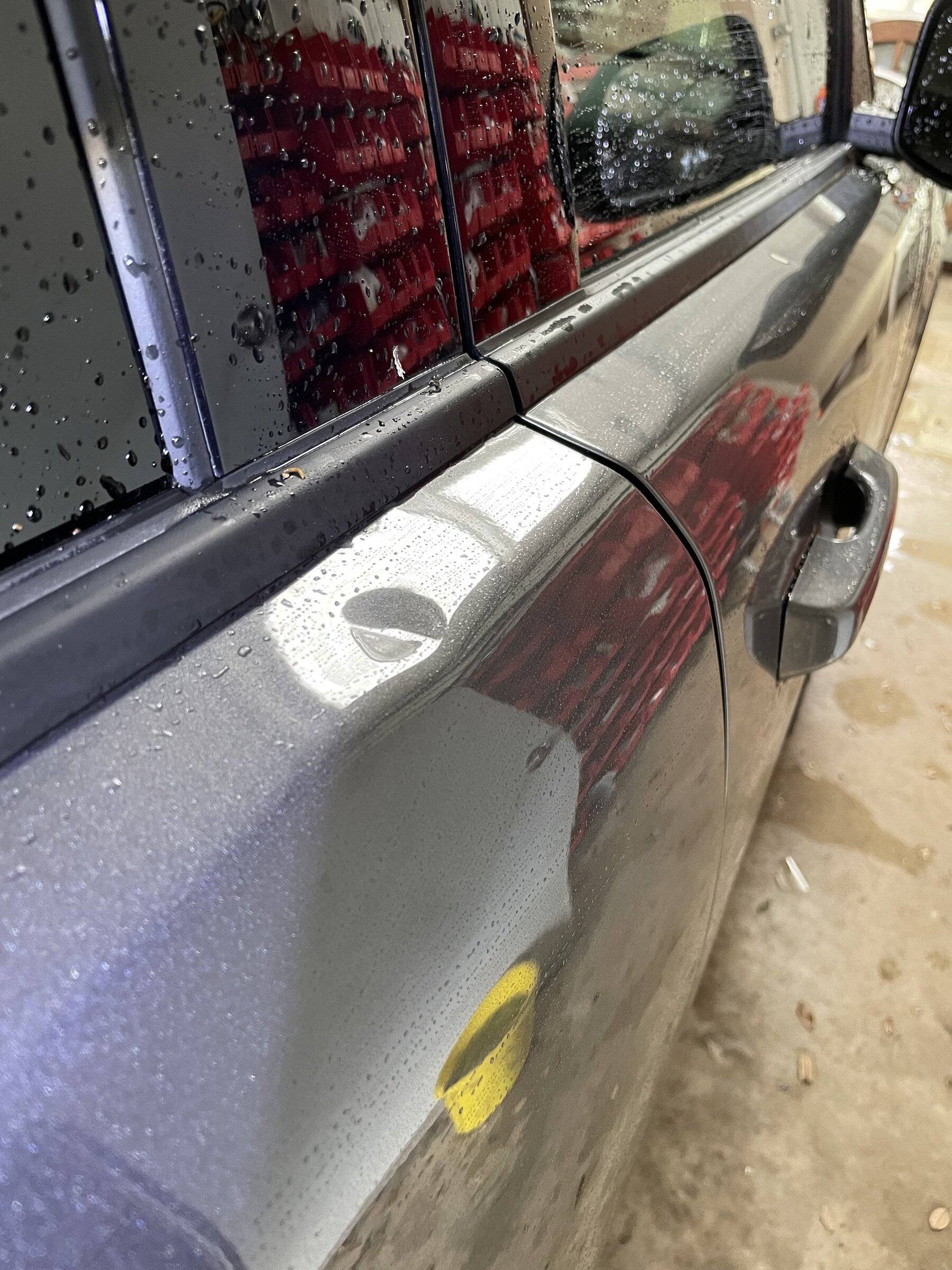

12/21/2021 -Had my damage assessed by Planet Ford in Spring/The Woodlands Texas. The PDR guy was blown away by the damages. He doesn't think he can repair the dents that are on the crease next to my side windows because of the difficulty to access them. Maybe 2 of the panels he (and I) feel confident he can repair like-new with PDR.
The serviceman at Ford wants to replace the hood and roof and Bondo/repaint every other panel with damage beyond PDR. I am adamant that my car not be Bondo'd and repainted. They say that this will require them to repaint every panel on my car apart from the undamaged one. I think it's only fair that having a from the factory car that is less than 6 months old, that anything requiring Bondo be replaced instead of repaired no matter the wait. I'm waiting to hear more info on part wait times right now. (edit: they never got back to me so I moved on)

Sorry, that really sucks. Same thing happened to my Escape when it was two weeks old. It was all repaired with PDR. I was amazed. Several right on the corner of the body panels like yours. I thought there was no way they could get those out. But, they did. It got hit again around 5 years later. Golf ball size hail. Looked like someone hit the hood with a ball peen hammer. Again, it all came out. To this day (16 years) only one dent ever returned.

yeah that's rough, bummer. hail is one of my biggest fears when it comes to my cars.
they are always gonna go the most cost effective route, and most times its repair rather than replace. especially with parts shortages right now.
a good PDR tech will get alot of that out, the tools and technology is def there. just needs a good technician.
that being said, they will pull out the majority of the dents, so they only have to use minimal filler. people think bondo / filler and they think the entire vehicle will be bondo front back and top to bottom. however once again, a good technician will get 95% of the dent out so minimal filler is used, most likley a skim coat.
i was an autobody mechanic for almost 15 years, never seen a comeback for cracking bondo or any other issues. products are solid nowadays.
it all comes down to A) a good shop, and B) a good technician.
either way, best of luck.
