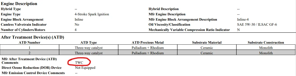

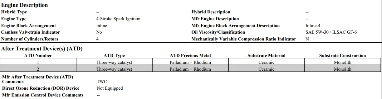

Thanks for posting, @Traveler!
Here's the info for yours. This seems to be working. As you can see below (circled in red) this shows only a three-way catalyst and no GPF.
If people want to check their vehicle without crawling under it and want instructions, let me know.

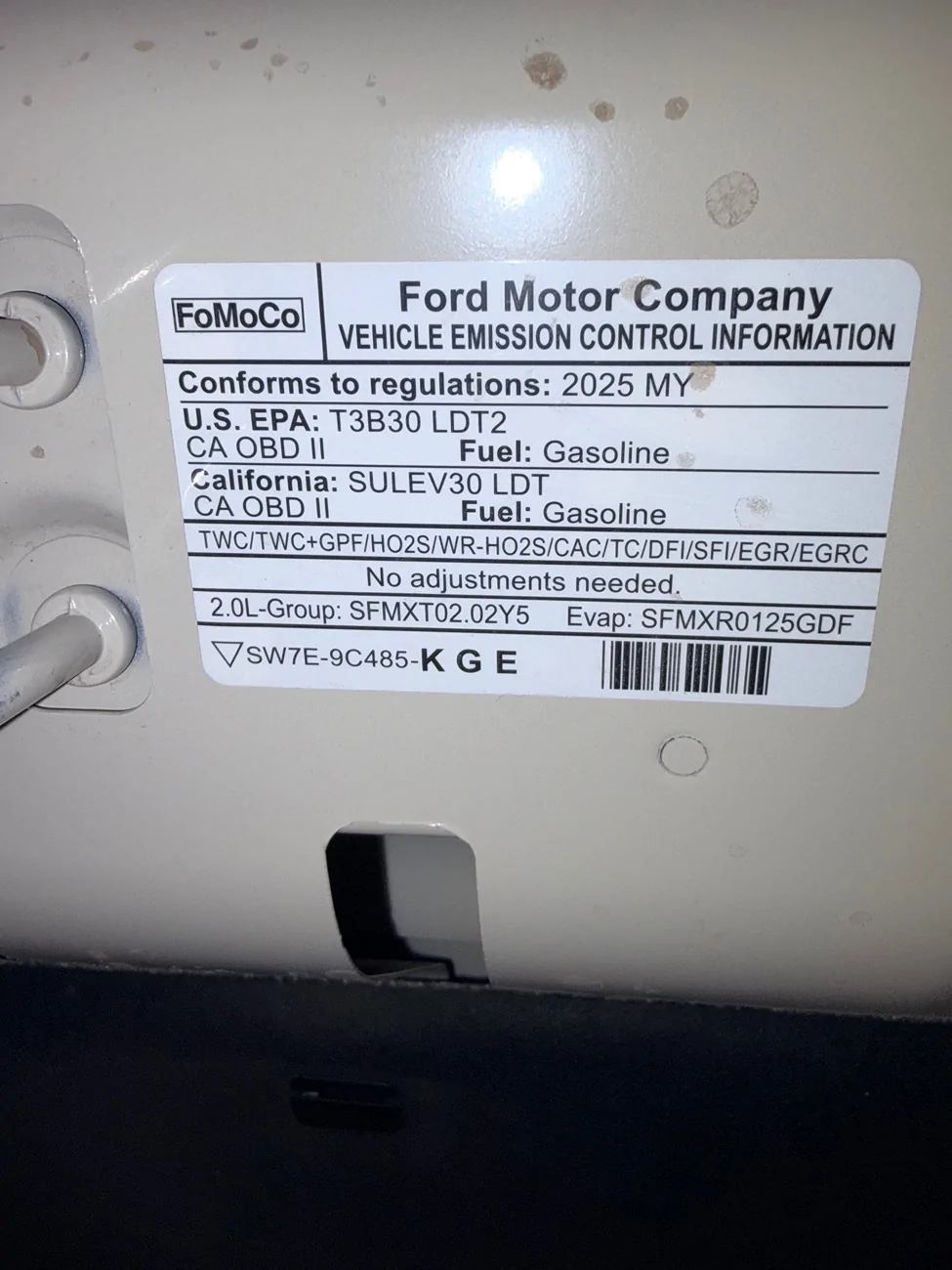

Well, son of a…
This was built for AZ delivery. WTF.
Now I want to find out if I can have an exhaust shop remove it, what effect it will have on the car and the warranty.

I think it may be difficult to find an exhaust shop to remove it because it's technically a federal offense to do so (anti-tampering laws), unless you find or know of a shop that just doesn't care or feels comfortable that you will keep their name out of it if anything ever comes of it. The other issue you will almost certainly have is a persistent OBD fault/check engine light, since there will either be hardware missing (i.e. pressure sensors removed causing circuit faults) OR if the pressure sensors are left connected to read only ambient pressure, I believe the PCM will see this as a missing substrate and will set a fault/check engine light for that condition.

Pretty much what I thought. Think I’ll pay a visit to Sanderson and verify it’s actually installed, and if so see what my options are to remedy.

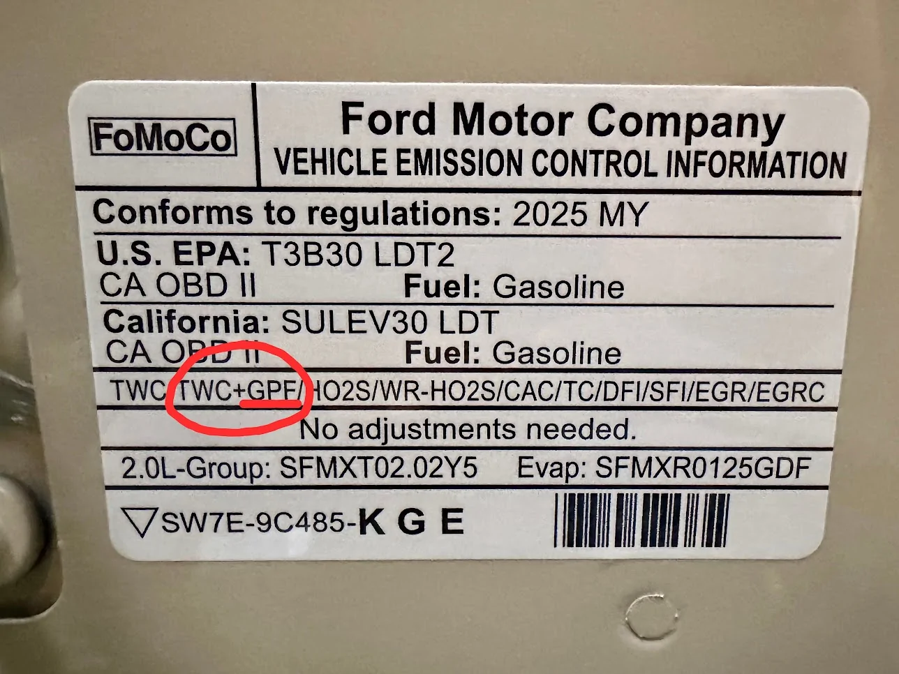

I'm curious what is the process your going throuh to generate this from the VECI sticker under the hood is? Isn't all we really need to know right on the sticker already, highlighted in red here in my case?

You can remove the VIN from the thread. @incavulator found a way to determine this that anyone can do. Look at page two of this thread and look at the sticker under your hood.....it will say if your vehicle was built with a GPF or not.

Ha!!! Yes. You are correct. I did mine first and since mine doesn't have a GPF, I didn't know if it would be there or not. After doing the research on mine by finding the certification information on the EPA website, I kept using that same method and didn't even notice it said "GPF" right on the label when you posted it. Talk about a "DUH" moment (for me)!!!
This method is CLEARLY easier! Just read it. :crackup:
Hey I read it too and it didn’t sink in until I read another that didn’t have a GPF :blush:. I guess it’s obvious if you know what your looking for but I sure didn’t 👍🏼
