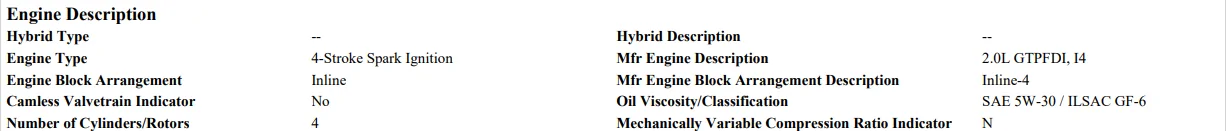

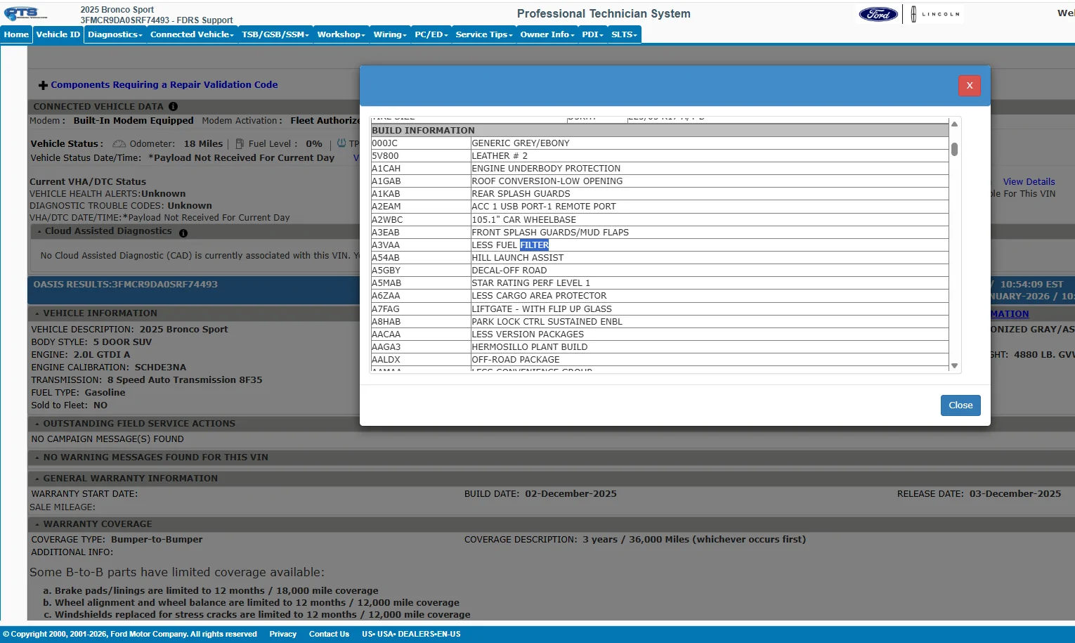

I dug through OASIS, but was not able to find any concrete info on this. From what I gather, Ford had supply chain issues with the GPF and many vehicles that were supposed to have it were built without it; even if they were designated for CARB states.
I would need the VIN of a vehicle that has one so I can dig through the build codes. I found this random BS for sale in California and ran it through PTS and found this that says "less fuel filter" which I assume is referring to the GPF. It would be interesting to compare this to one that DOES have it and see if it differs.
Ford Bronco Sport My 11/25 built Badlands Sasquatch 2.0L has a GPF 1768233357729-mz
However, without PTS access, the regular person would not have a way to check if it has it or not.

Got your message. Your car shows the same build code there:
Ford Bronco Sport My 11/25 built Badlands Sasquatch 2.0L has a GPF 1768236676590-51
So, either it has to be somewhere else. Whatever that refers to, it is not the GPF.
I looked through every single feature code in your vehicle and I found this that could be relevant:
Ford Bronco Sport My 11/25 built Badlands Sasquatch 2.0L has a GPF 1768236772726-c
The BS in California shows this, as well. I guess we would need the VIN of a 2025 that we know does NOT have it to compare further.
In the meantime, I know someone I can ask that may have some insight on this. I will see what I can find out.
Edit: I asked a guy I know who is a veteran Ford tech, and he doesn't know how to tell if that have the GPF or not other than crawling under it, either.

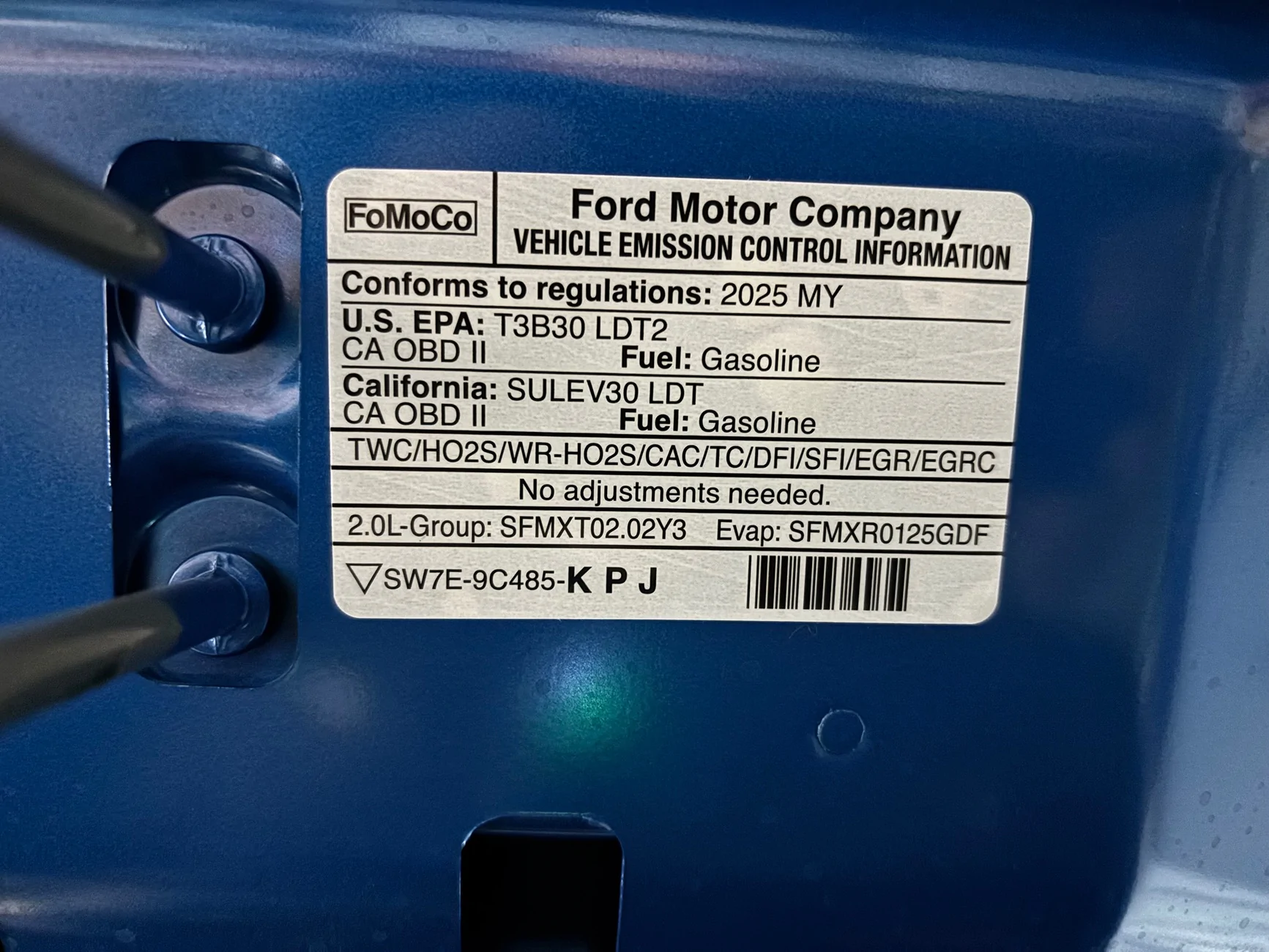

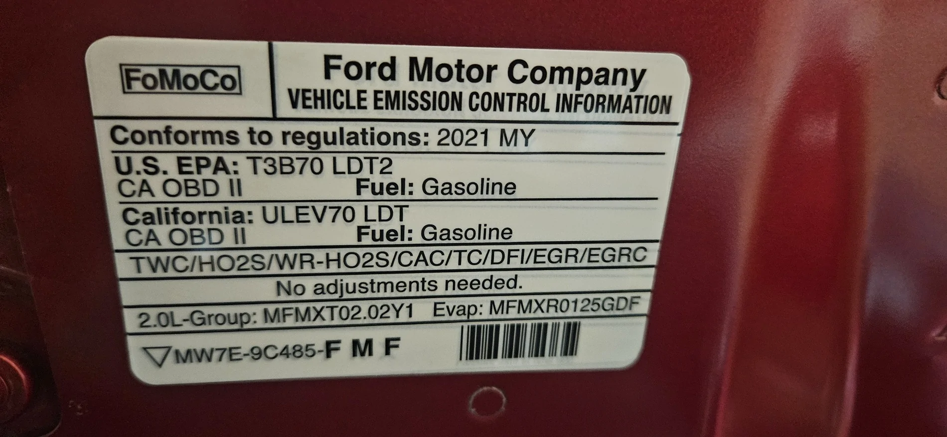

I think you can look at the cert label on the underside of the hood and tell. If someone with a GPF posts a pic of theirs, I can confirm.
Here's an example.
Ford Bronco Sport My 11/25 built Badlands Sasquatch 2.0L has a GPF 20260112_145917

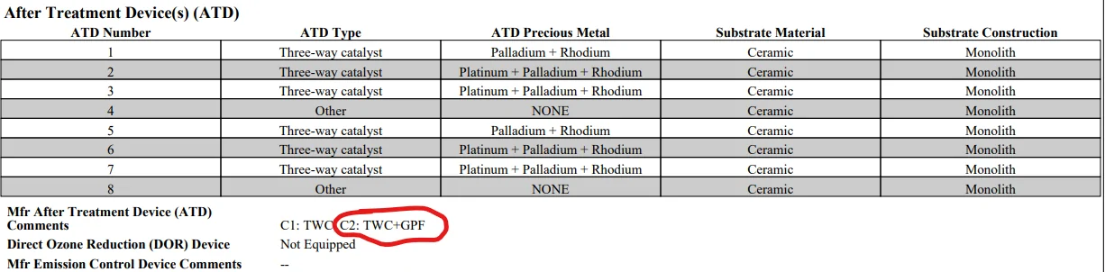

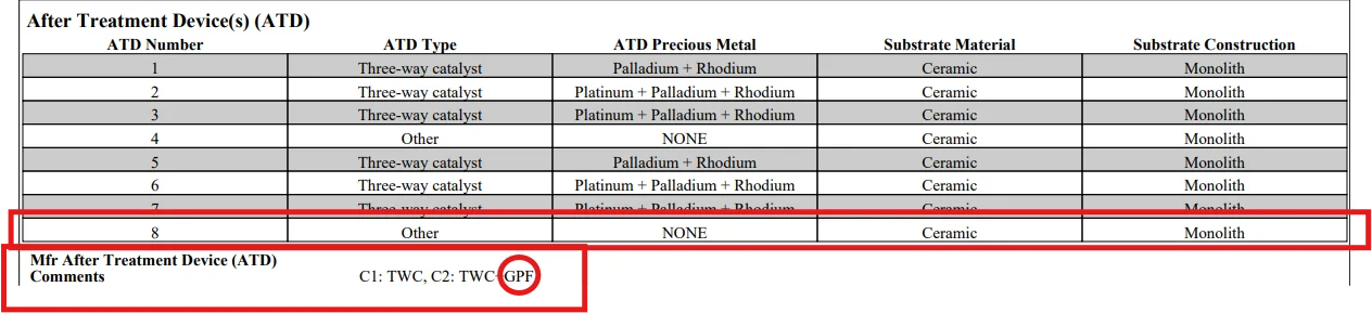

After a little more detective work, I'm pretty sure I can determine if a vehicle has a GPF or not based on a picture of the VECI label.
This is from one of the 25MY Bronco Sport test groups.
Ford Bronco Sport My 11/25 built Badlands Sasquatch 2.0L has a GPF 1768263630804-sh
Genius, and no special access to anything is needed.
Exactly.
I'd like to confirm the theory. If someone is willing to post a picture of their label, I'll give it a try. Ideally, it would be nice to get one with and one without a GPF.

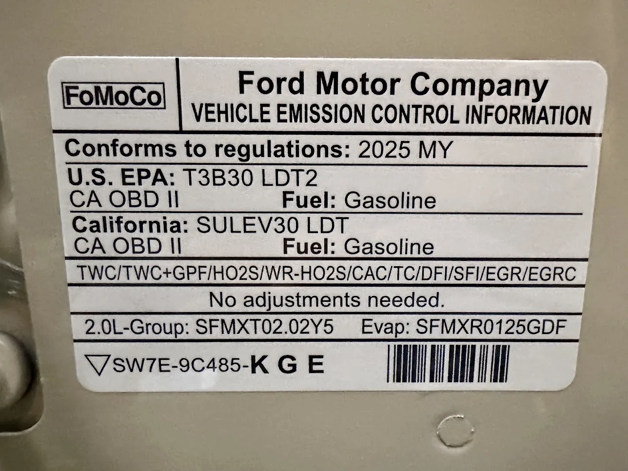

Ok here's the VECI from my 2025 with a GPF on it, what do you think?
Ford Bronco Sport My 11/25 built Badlands Sasquatch 2.0L has a GPF 1768266474141-mo
