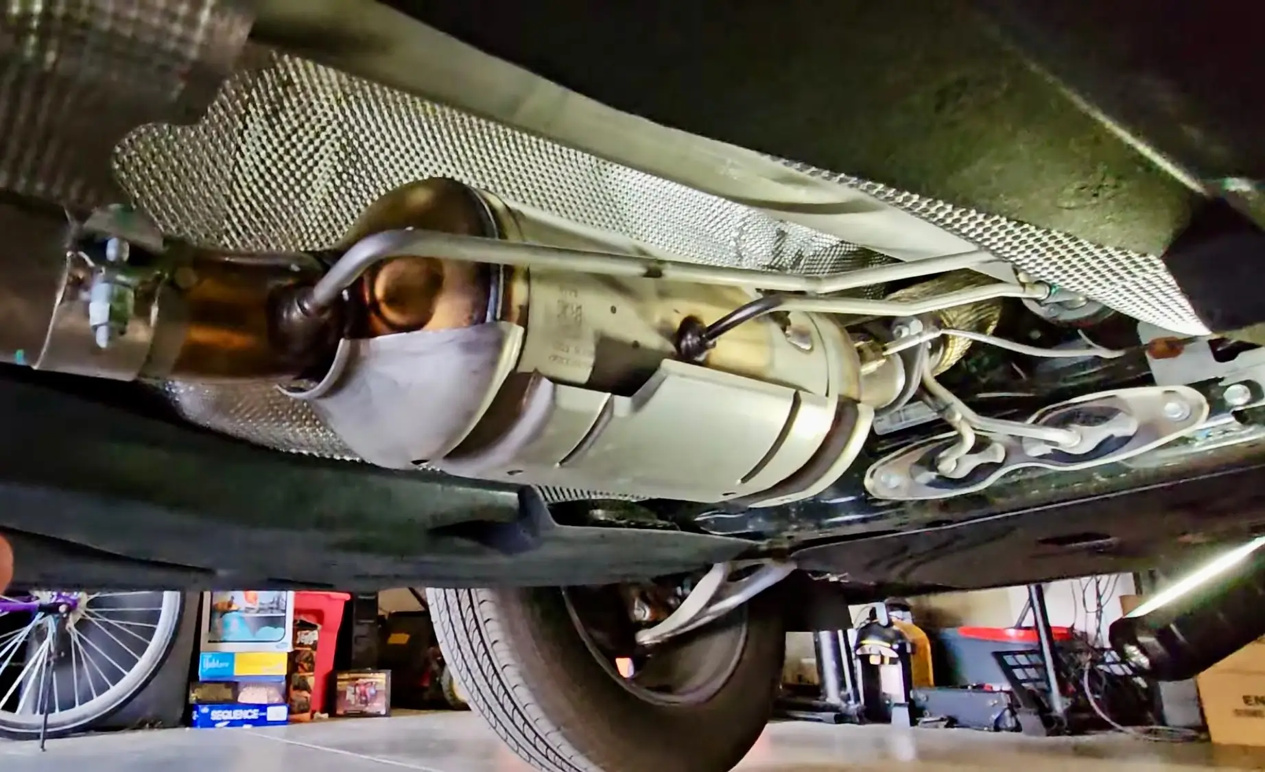

I just crawled under my new 2025 Badlands Sasquatch and confimered what I feared, it has a GPF. I'm not sure when they started putting them in but mine is a 11/25 build according to the door sticker. Not the end of the world I don't think I'll miss that 12 HP but I'd have prefered one without it. This is not my photo but it indeed looks like this. About 50% longer than the a secondary cat and has the extra plumbing :frown: I'm in Oregon FYI.

Build Date isn't the determining factor; delivery state does. If you're in a CARB-compliant state, you get it; if not, you don't.
CARB-Compliant States:
California, Colorado, Connecticut, Delaware, Maine, Maryland, Massachusetts, Minnesota, Nevada, New Jersey, New Mexico, New York, Oregon, Rhode Island, Vermont, Virginia, Washington, and the District of Columbia

Thanks,that makes sense since the OP lives in Oregon and it's a Carb- Compliant State.

Extra plumbing is for the delta pressure sensor, so the system can determine if there is "too much soot" OR if it's clogged or someone tampered with it and removed the substrate. Agree that you probably won't miss the 12HP, but also agree it would have been nice to get one without - fewer parts = fewer problems, so thank your local government. :)
