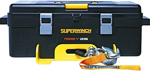

I was hoping to add a Superwinch Winch 2 Go to my off road "Bring Along" list for the same reason you mentioned.

Oh yea this thing looks pretty great. So you just strap it to a tree or whatever? Very nice. Love that its all in one portable package.
It's pretty slick. Comes with a pully, clevises, straps, even gloves. Steel or synthetic cable. You can check it out here Amazon Superwinch.
I plan on relying mostly on recovery boards but this would be great to have in a worst case scenario.
Love the idea...just remember it will need a power source... it wouldnt be too difficult to have it ounted on a receiver and again... i personally would do it if necessary ... but thats a personal call.

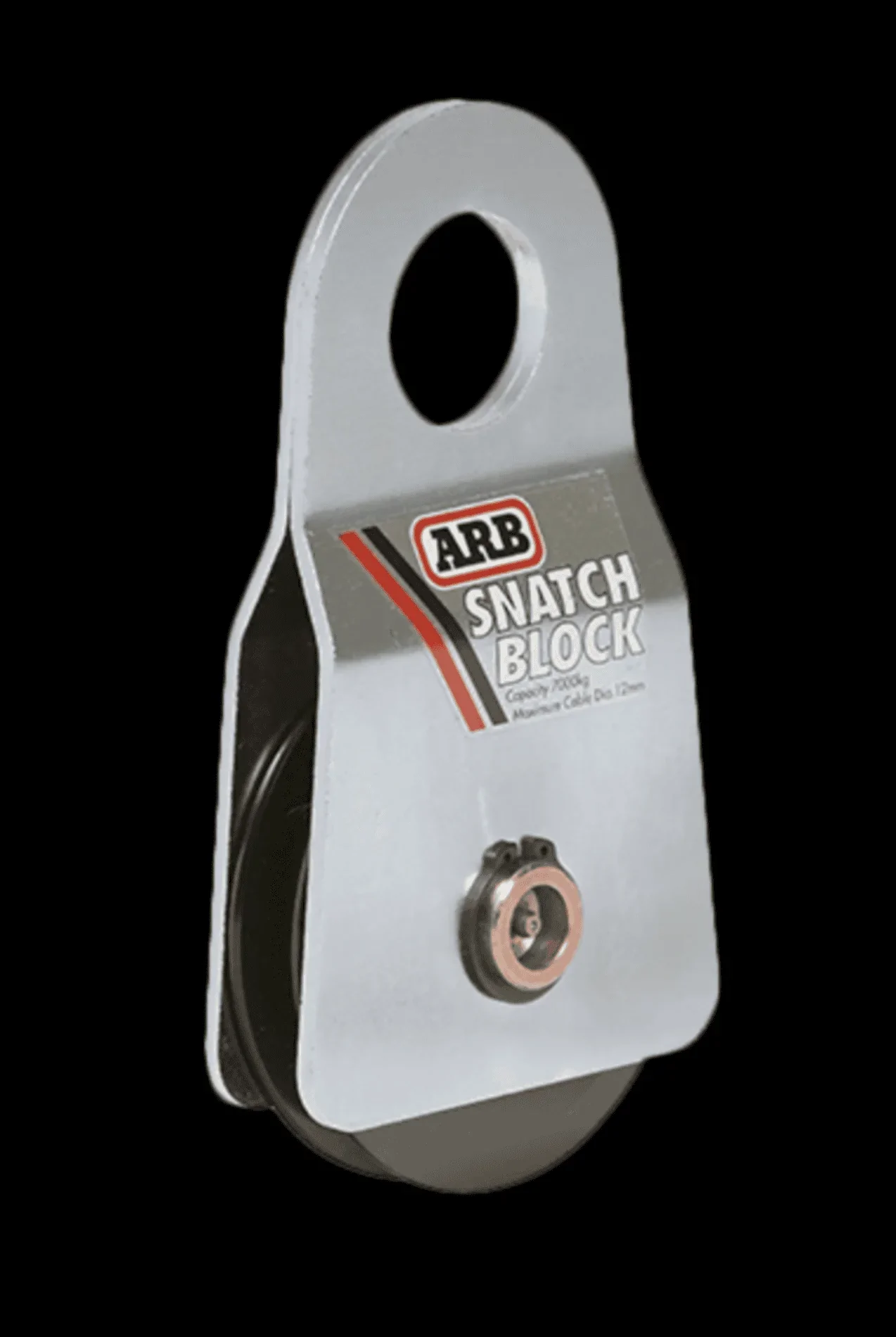

Using a snatch block will reduce the overall weight of the vehicle. Run the winch thru the block back to you car, this way the full weight is on anchor point.
Ford Bronco Sport Mud Recovery - Rear mounted winch? Screenshot_20210818-112419
Ford Bronco Sport Mud Recovery - Rear mounted winch? Screenshot_20210818-112337
