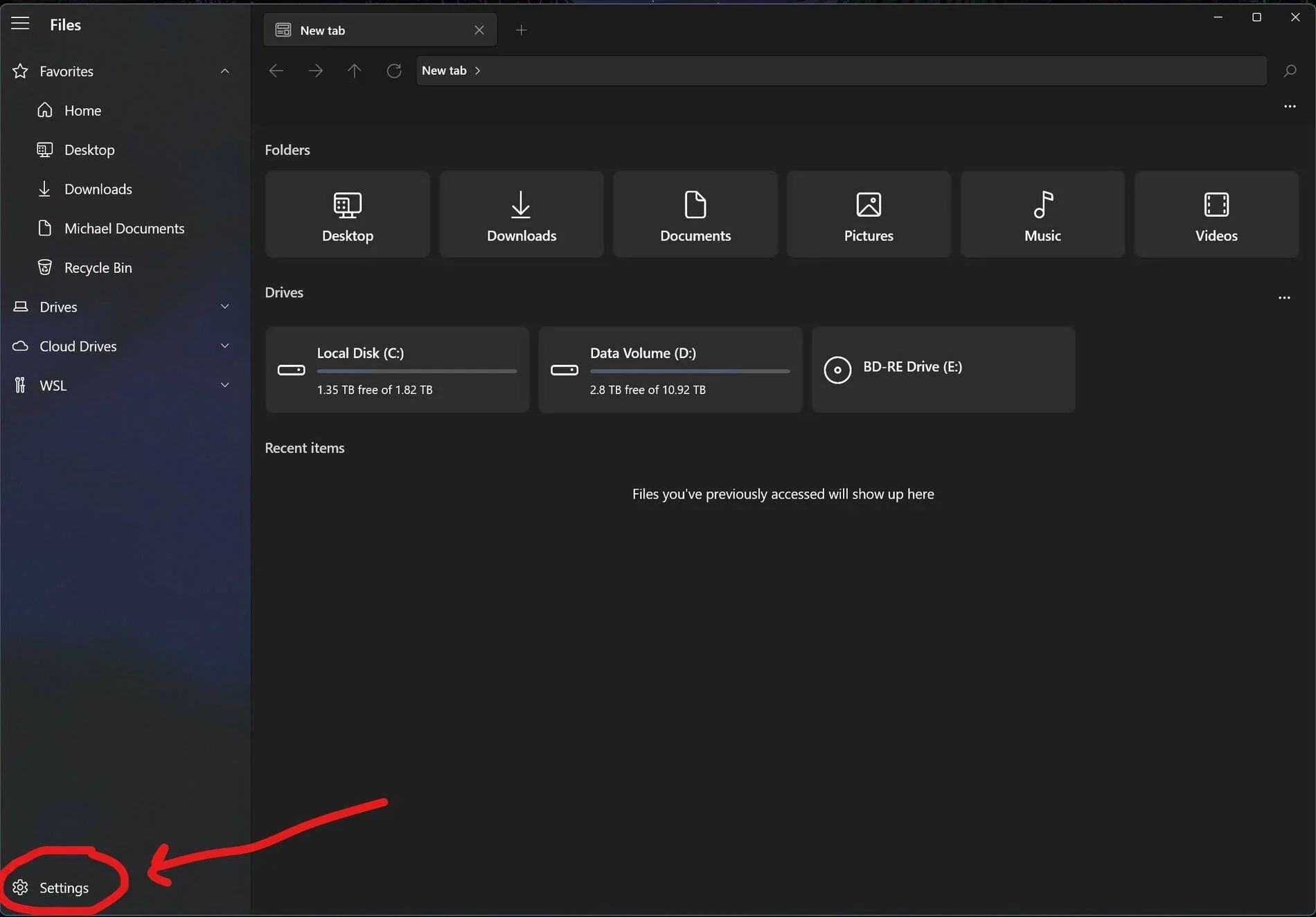

Once you have downloaded that, you will need to change a few settings to see the album art (only once, the settings should "stick" unless you change them back): Launch the application and in the lower left-hand corner, click on settings:
Ford Bronco Sport MP3 music on a flash drive question Screenshot (385)_LI

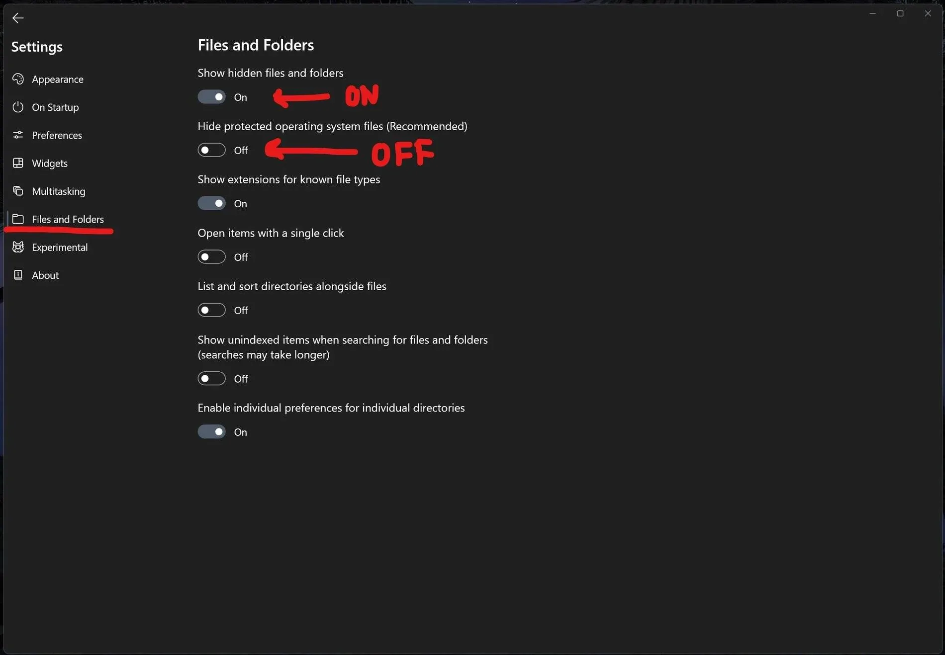

On the settings page you will click on Files and Folders. On the Files and Folders page you will set "Show hidden files and folders" to On and "Hide protected operating system files" to Off.
Ford Bronco Sport MP3 music on a flash drive question Screenshot (387)_LI

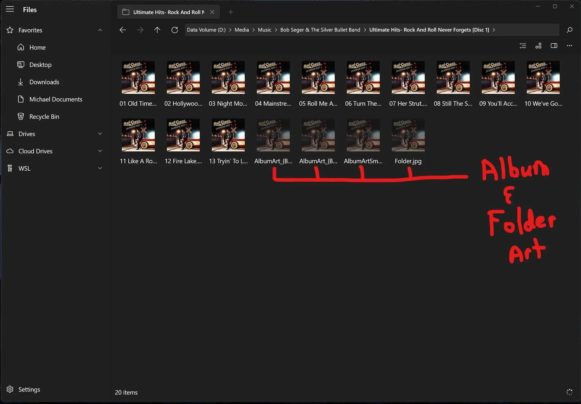

If you drill down into one of your Music Folders, you should now see several album art files and often a folder art file:
Ford Bronco Sport MP3 music on a flash drive question Screenshot (389)_LI

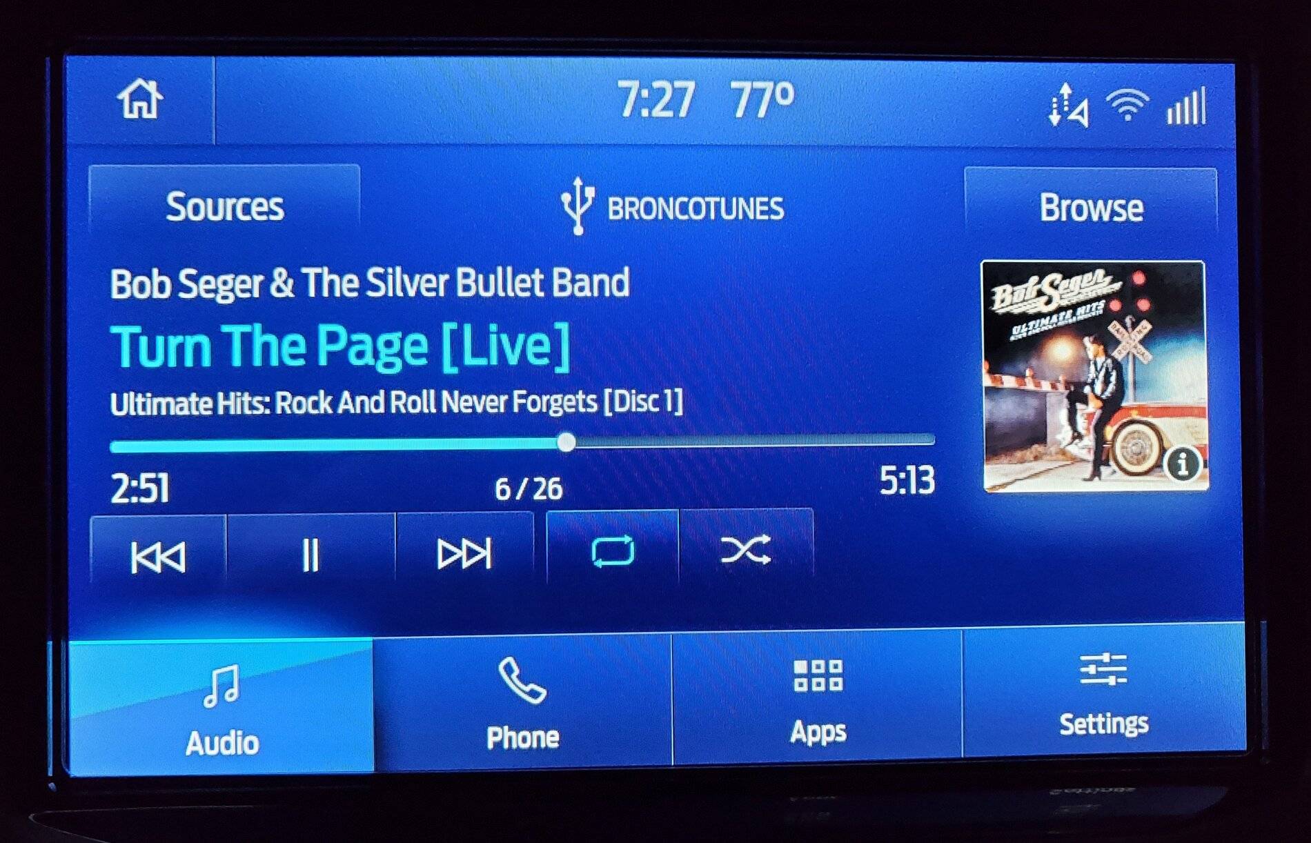

At this point if you do a copy of a folder to a USB drive, the album art will carry over to the USB drive and SYNC will read these files and display them correctly:
Ford Bronco Sport MP3 music on a flash drive question 20210909_192744

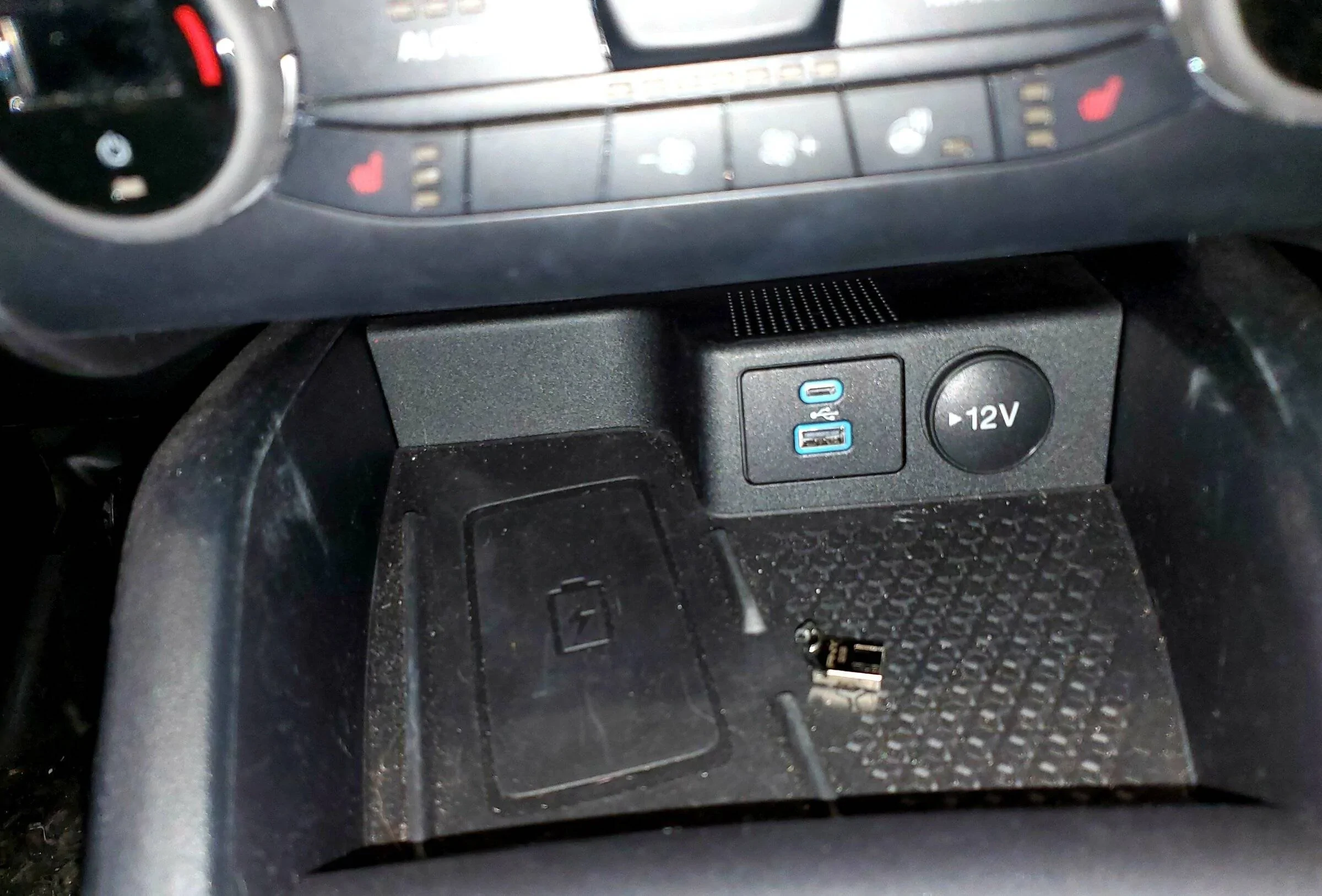

Please bear with me I am old & tech & computer challenged. You all talk about loading all your songs to a usb drive, after that what do you do with it so the sync system can play the music? :confused:
Plug it in to the port to the left of 12 volt outlet in the center section under heater controls
