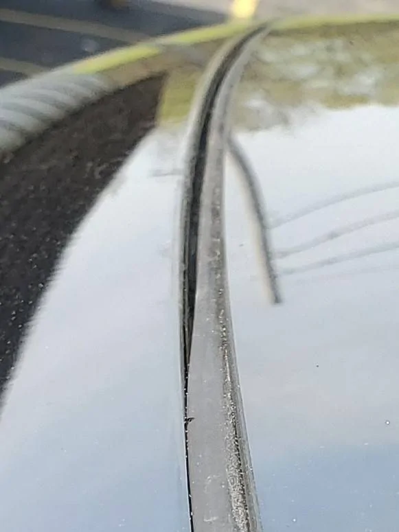

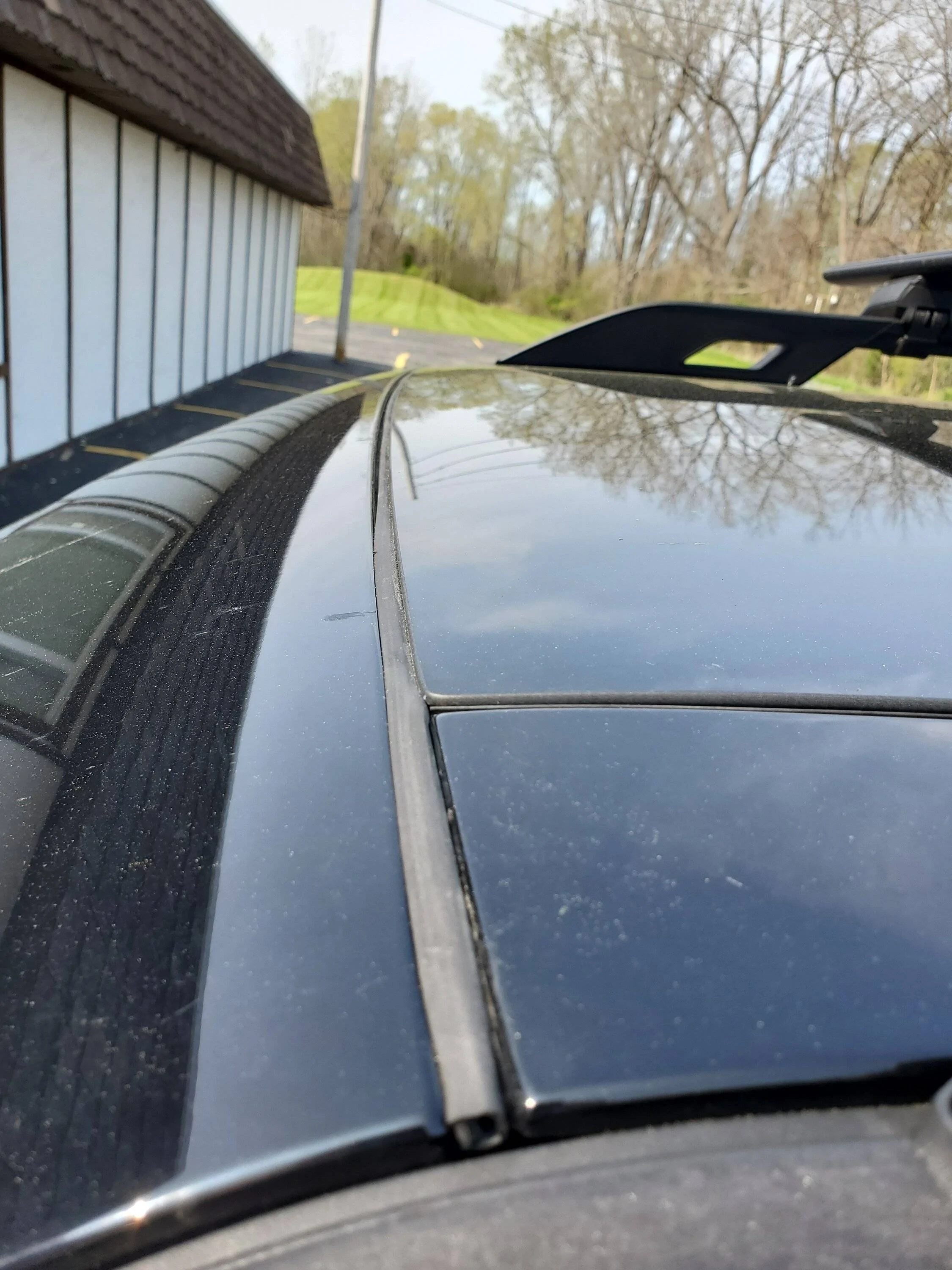

Anybody notice their rubber seal attached to the body, along the leading edge of the moonroof glass panel, coming detached? It looks like it's supposed to be adhered to the back edge of that little narrow, steel (painted) body panel that runs between the windshield and the moonroof. It should, I believe, ride over the top of that crevice, not fall down into it like mine has (and is also just flopping around in there).

I noticed a loud noise coming from the driver side of my sunroof about a month ago. My 2022 broncho is about 15 months old. I climbed on top today and noticed that the driver side seal seems to have a gap compared to the far edge of the passenger side. Your photos look similar to my broncho sport.
When I have the sunroof open and tap up and down on the wind deflector that springs up when the sunroof opens, it sounds just like the same noise I hear when driving the sport on the highway or at higher speeds around town.

That happened to mine on my BB a couple of months back. I had the panel with the seal replaced under factory warranty back in early October. It made the extremely annoying low, rumbling vibrating noise when it achieved the resonant frequency from about 35 to 50 MPH. I hope that seal/adhesive doesn't fail again down the road as it won't fall under warranty and the panel alone with the seal attached was ~ $450 and the body shop needed it for a couple of days to do the replacement. Hopefully, they redesigned the part/adhesive.

Mine started to do this with one of the strips below the glass, on the sides. One side of my front strip is not as well aligned as the other side, but it is still adhered. Shame they decided to stick the car together with tape instead of using attachment points, e.g. barbed plugs on these strips.
Ford Bronco Sport Moonroof front edge rubber seal coming off? 2021 Badlands moonroof leading edge seal
Ford Bronco Sport Moonroof front edge rubber seal coming off? 2021 Badlands moonroof leading edge seal closeu
I have an early build 21 BL with 6,900 kilometres on the odometer. It will be out of warranty in 6 weeks and yesterday I noticed the passenger side of mine is peeling back about 2 inches. I can force it down but it pops back up. The driver side is a narrower gap and totally snug. I’ve never opened the moonroof and haven’t been through a car wash.

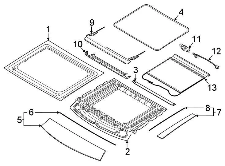

Looking into the parts there is some confusion as well. Here's the Ford Parts diagram:
Ford Bronco Sport Moonroof front edge rubber seal coming off? Screenshot 2024-08-12 at 7.10.11 PM
<51916 is the parts you are looking at for that replacement. But I also found on this Ford Dealer's website that has a parts store:
Ford Bronco Sport Moonroof front edge rubber seal coming off? BS21565
#6 is the seal needed, and the part number is M1PZ78502D58A according to https://parts.lakelandford.com/p/Ford_2022_Bronco-Sport/Seal-Weatherstrip-Plate-Roof-Panel-Opening-Side-Front-Included-with-Front-Plate--Side-Plate/98564098/M1PZ78502D58A.html
Now none of the ford dealers I have spoken with will confirm that it's available as just the weatherstrip....
