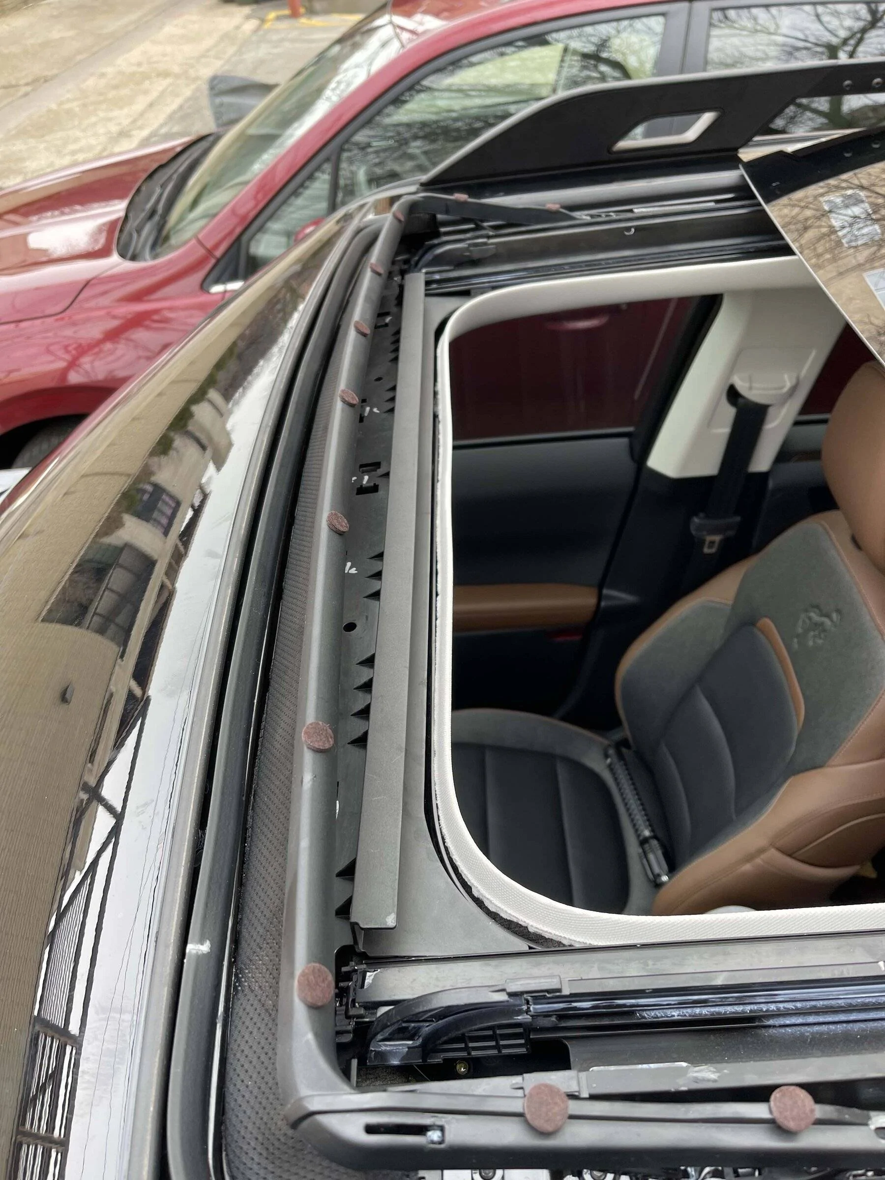

I had the exact same issue. 22 Outer Banks with the Moonroof. What I ended up doing was putting additional felt pads on the wind deflector so that it really pushes down close and does not creak. Also, I pushed and nudged on each part of the moonroof frame to see what was creaking, and then put gabs of grease and oil until it stopped creaking. Don't put too much oil otherwise it may soak through the headliner, caution.
It ended up fixing it and no more creaking noise for me. Seams ghetto but I really was annoyed at the noise. Also, my Bronco Sport was made in the winter time and it really hasn't been "baked" in the hot sun yet, so all the stuff has not melded together. When the summer time hits here in the upper midwest, I will let it bake in the sun all day to meld everything together and hopefully less creaks.
Edit: That plastic frame part right underneath the wind deflector was the culprit and I pushed down each part until I heard the noise myself, and then sprayed some oil/grease. I used "3 in 1 multipurpose oil"
Don't add the felt pads near the ends of the wind deflector, like the 2 at the top of my picture and 2 at the bottom. They ended up falling off.

Indeed, was suspecting area around where the hinge for the wind deflector is... Will try your trick this weekend. Thanks!!
