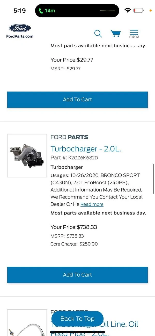

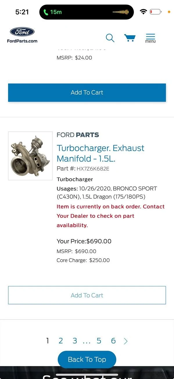

They said 1500 for parts only for a turbo. I see 700. No clue about the difference or maybe I need both? Thoughts?
Ford Bronco Sport Many issues ford saying Coincidence. Screenshot 2024-08-14 at 5.21.34 PM
Ford Bronco Sport Many issues ford saying Coincidence. Screenshot 2024-08-14 at 5.19.49 PM
120
6,729
13,193
I'm not sure what you're asking. Both what? You only need one turbocharger. It would be the top one listed in your last post (your car has the 1.5L EcoBoost engine).

Are there other parts required for a turbo replacement? Oil fittings , gaskets etc? And the link you posted said “out of stock” so while
They sell them at that price they CANT sell one at that price now, the in stock place
Might be 1350(plus gaskets, and fittings).

I showed them the turbo was 700 online ford. Not 1400. They gave me the turbo for 700. I unfortunately don’t many options for a garage out here. Plus side i get 2 year warranty on the turbo.
