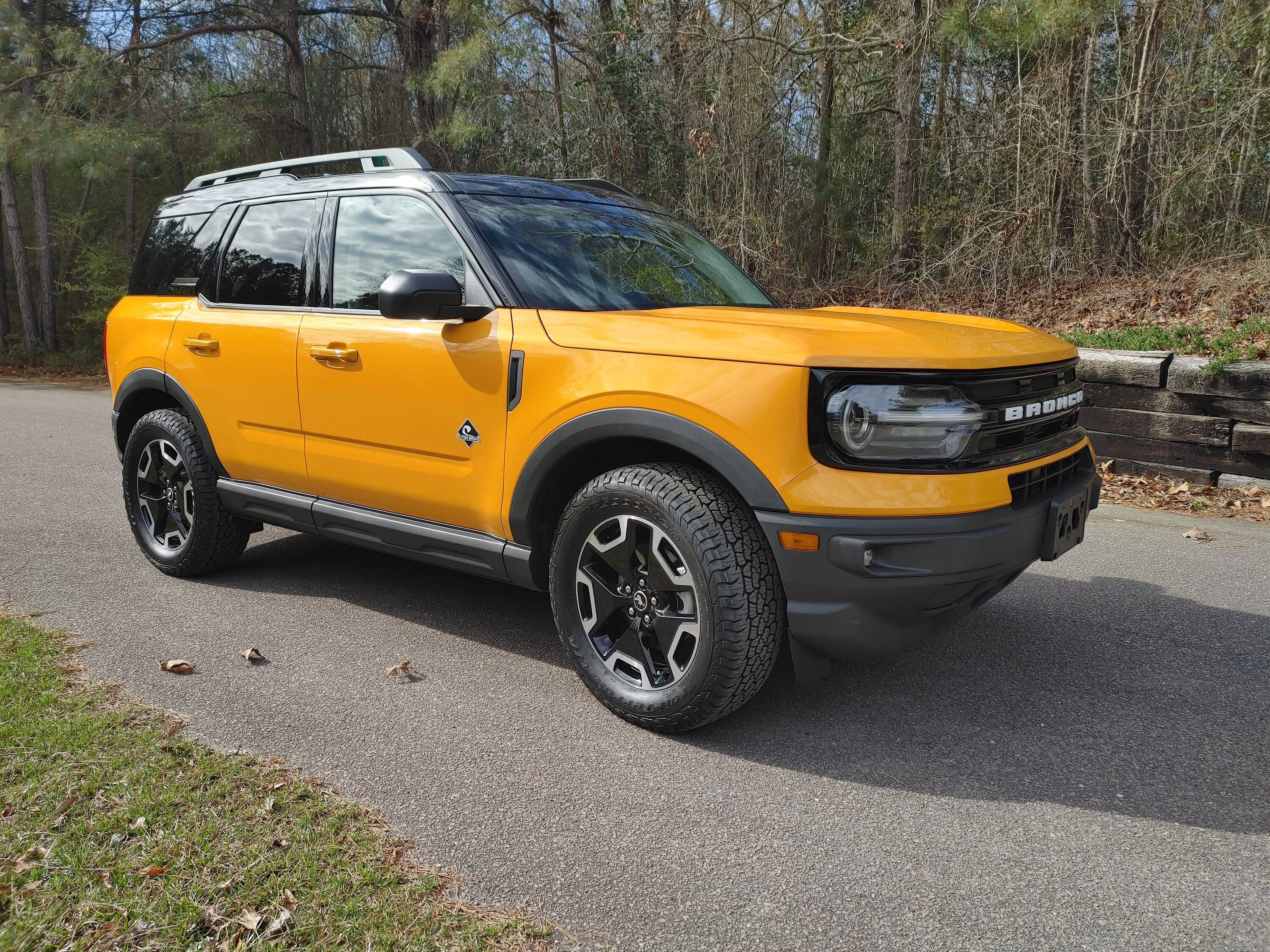

21 Bronco Sport
I switched to the 225 BFG All-Terrains about a year ago, I've noticed a small drop in MPG compared to the stock tires. There was no need for me to go any larger than the stock size but the looks and the performance in snow and light trails makes up for the small drop in MPG. There is a little more road noise than stock.

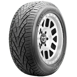

Looking at putting a set of upgraded tires on my wife's '23 Outer Banks. Right now BF Trail Terrain's are looking like a good candidate, in P235/60R18.
My question is, has anyone noticed their fuel mileage going totally in the shitter by putting a "heavier" tire on?
I have a 2021 Outer Banks. I installed General Grabber UHP 255 55 R18. No clearance problems and no noticeable change in mileage. I use it for soft dirt and sand off roading.
