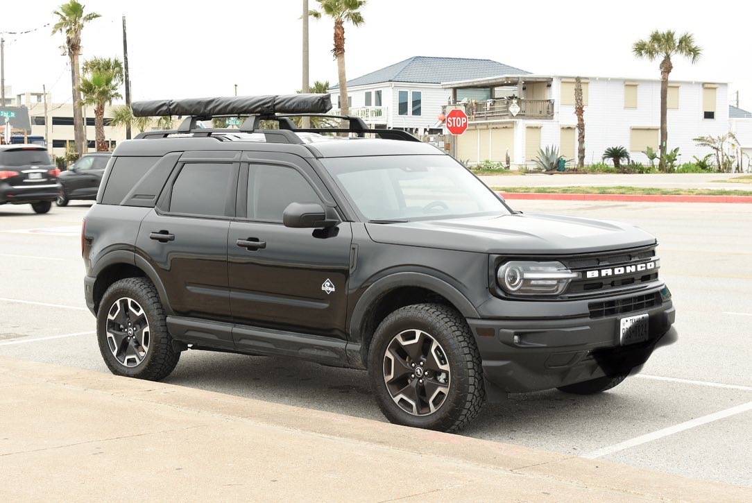

OEM crossbars with Yakima Slim Shady awning. I like the higher stance of them however it seems to be most others biggest dislike. Also OEM in my research limits you to 39 inches of usable space to for attachments. Thule and Yakima with overhang and T slots allow for platforms or easy load kayak mounts. I’ve even seen ones with overhang use the optional mounts the awning came with to mount lower than the way mine is making for easier launching.

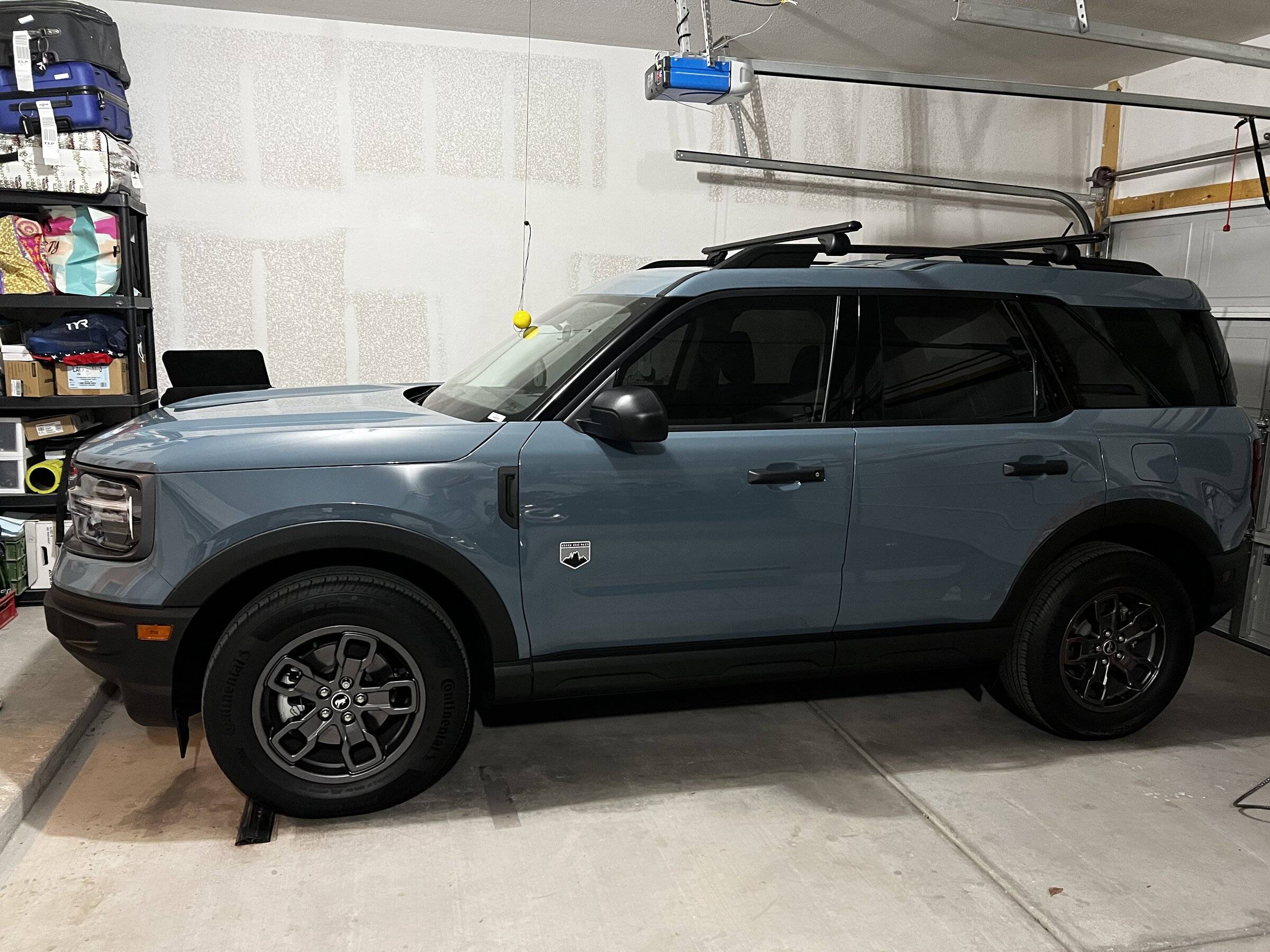

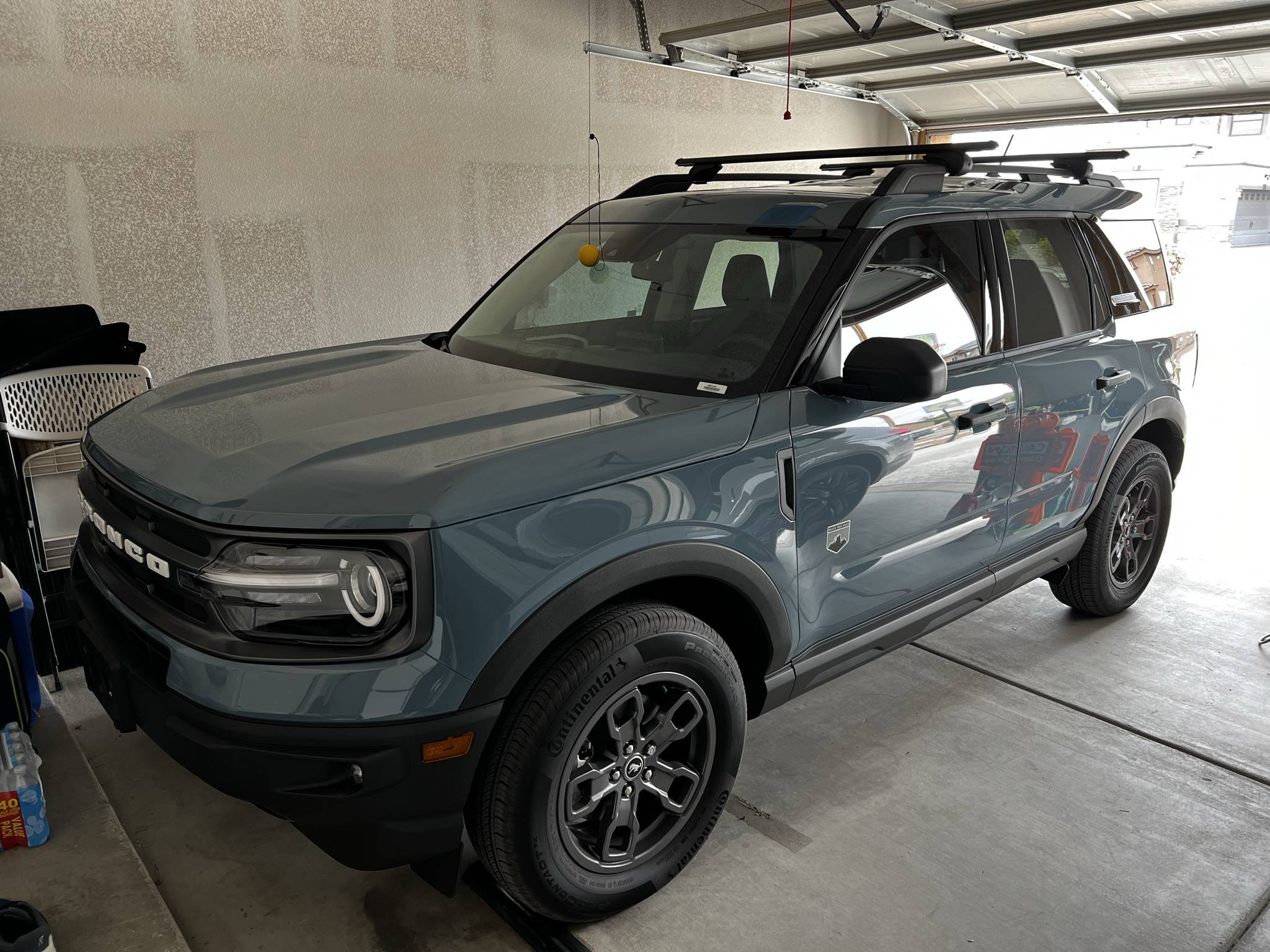

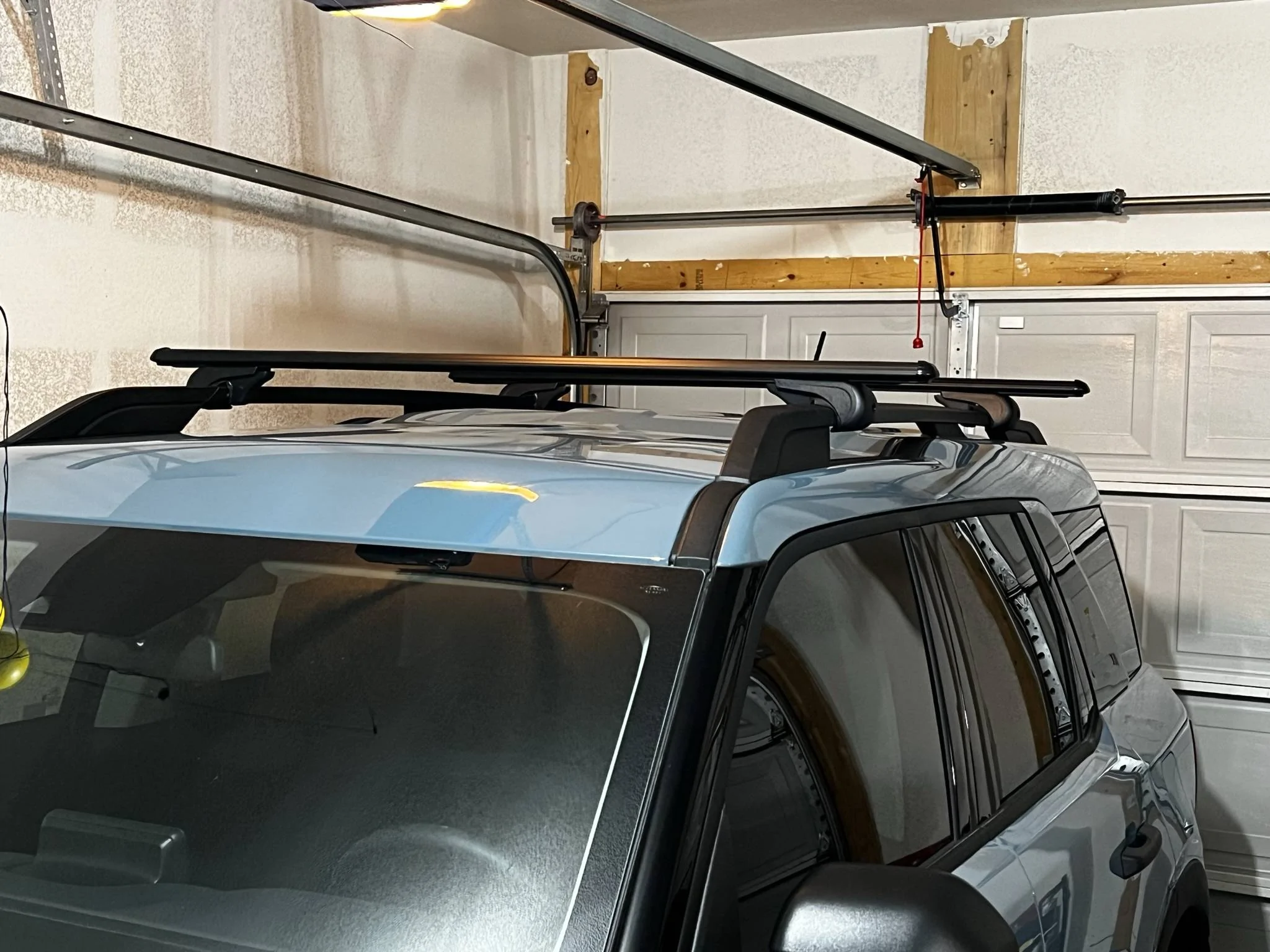

thule !!!!!
Ford Bronco Sport Lost in a sea of cross bars and roof racks. 21B6C541-E398-45F2-BC09-567B11EF9BDF
pricey tho.
versatile. everything from 2x4 to ikea boxes to rooftop tent.
