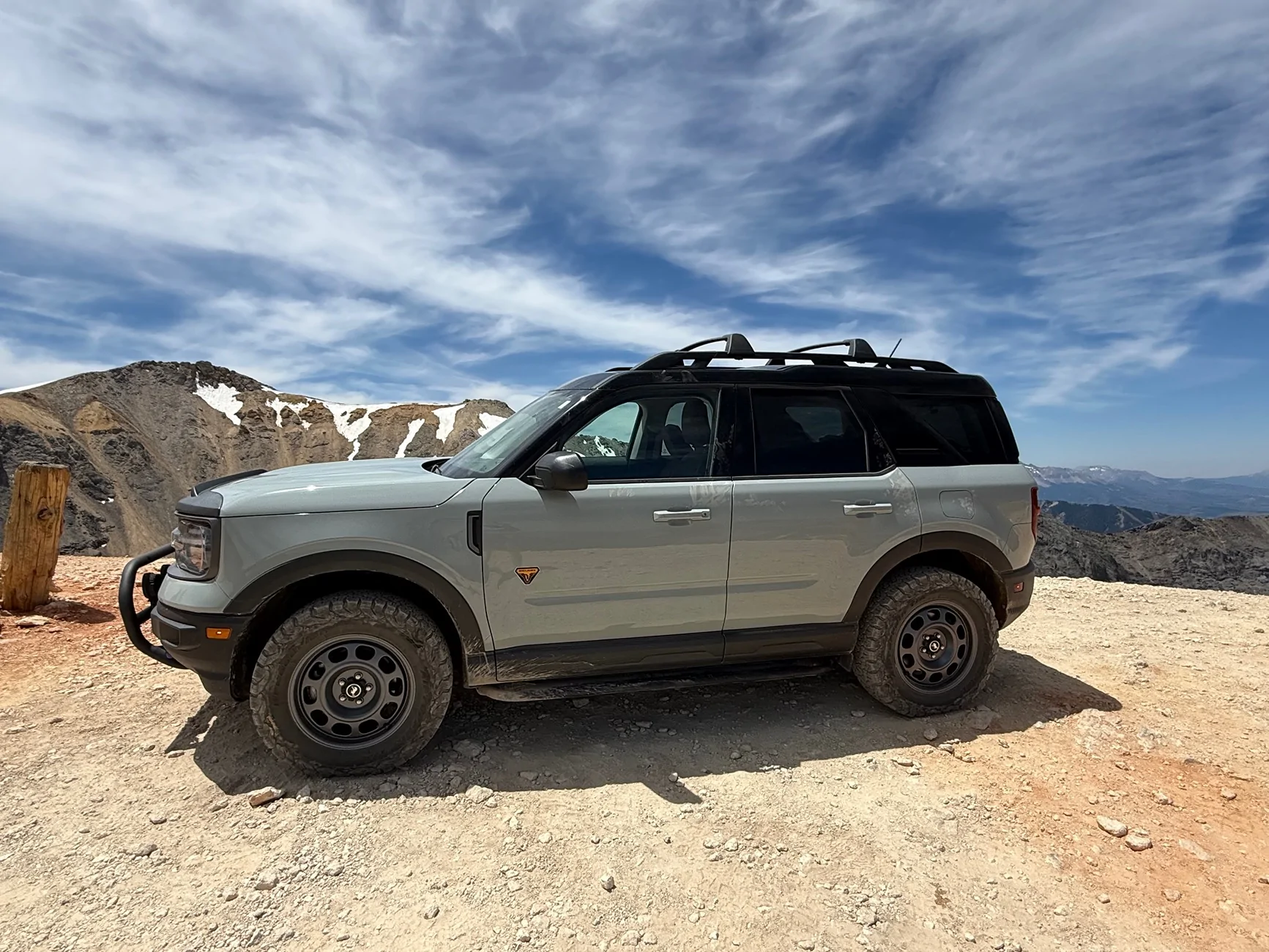

I’ve been noticing an acceleration lag recently in my 2022BSBL 55,000 miles. For instance, when needing to pass on the highway, I press the accelerator, and it takes a beat or two before there’s a response. I hadn’t thought too much about it until three days ago, I had a more significant situation which caused me to think back on these acceleration lags. I do off-road in my BSBL, and while on a trail Friday, I was going over an obstacle- a steep, offcamber, rocky section. I had it floored, and I was getting no response. My husband was outside spotting, and he said he didn’t even hear the engine revving increase. I ended up backing off the obstacle and trying again with more speed, but still, the acceleration/engine lacked response. We were too far up the trail to do anything but keep going, and it was the last intense obstacle, so we decided to keep going. I did a quick search of this forum and some Facebook groups, but I’m not sure what I’ve seen posted is what I’m experiencing.
I am going to take it in, but curious if anyone has had a similar experience and what you found out it was.
I was running premium fuel.
