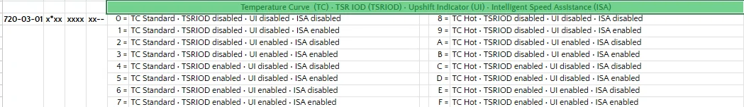

There are some things you can look at with FORScan to achive your goal. I assume based on the tow hooks on your bumper that you have a 2025 on Sync 4. Check these settings in the IPC for ASLD and ISA:
Ford Bronco Sport Looking to enable a real Speed Limiter (not ACC) – any Forscan success? 1774464493189-ko
Ford Bronco Sport Looking to enable a real Speed Limiter (not ACC) – any Forscan success? 1774464552705-3q

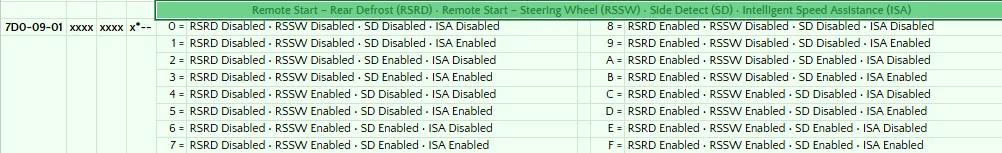

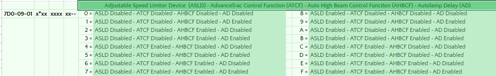

You will also need to enable ISA and ASLD in the APIM:
Ford Bronco Sport Looking to enable a real Speed Limiter (not ACC) – any Forscan success? 1774464596680-n
Ford Bronco Sport Looking to enable a real Speed Limiter (not ACC) – any Forscan success? 1774464625361-n7
I can't find anything in the SCCM, PSCM or IPMA related to ISA or ASL, so you can try enabling the features in the APIM and the animations in the IPC and then look through the driver assist settings to see if any new toggle switches popped up related to these features and check to make sure they are turned on or can be turned on.
If you don't get the desired result, just revert back to what is there now.
I pulled the config off of a random 2025 BS and it shows all these things are turned off, so maybe it will work. Only one way to find out.

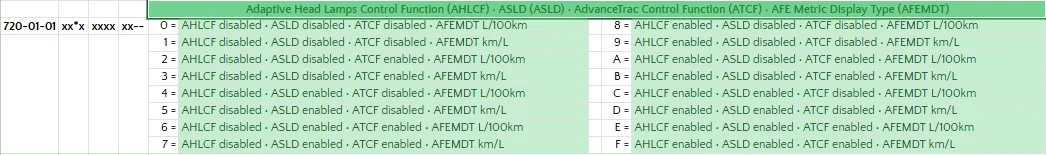

@Timon.Arg I also found this in the PCM. I think this has to do with MyKey. The random BS I pulled the config from shows a 1 there indicating no ASL or ISA. Not sure if it needs to be enabled here for the features to work or not, but worth noting, I think.
