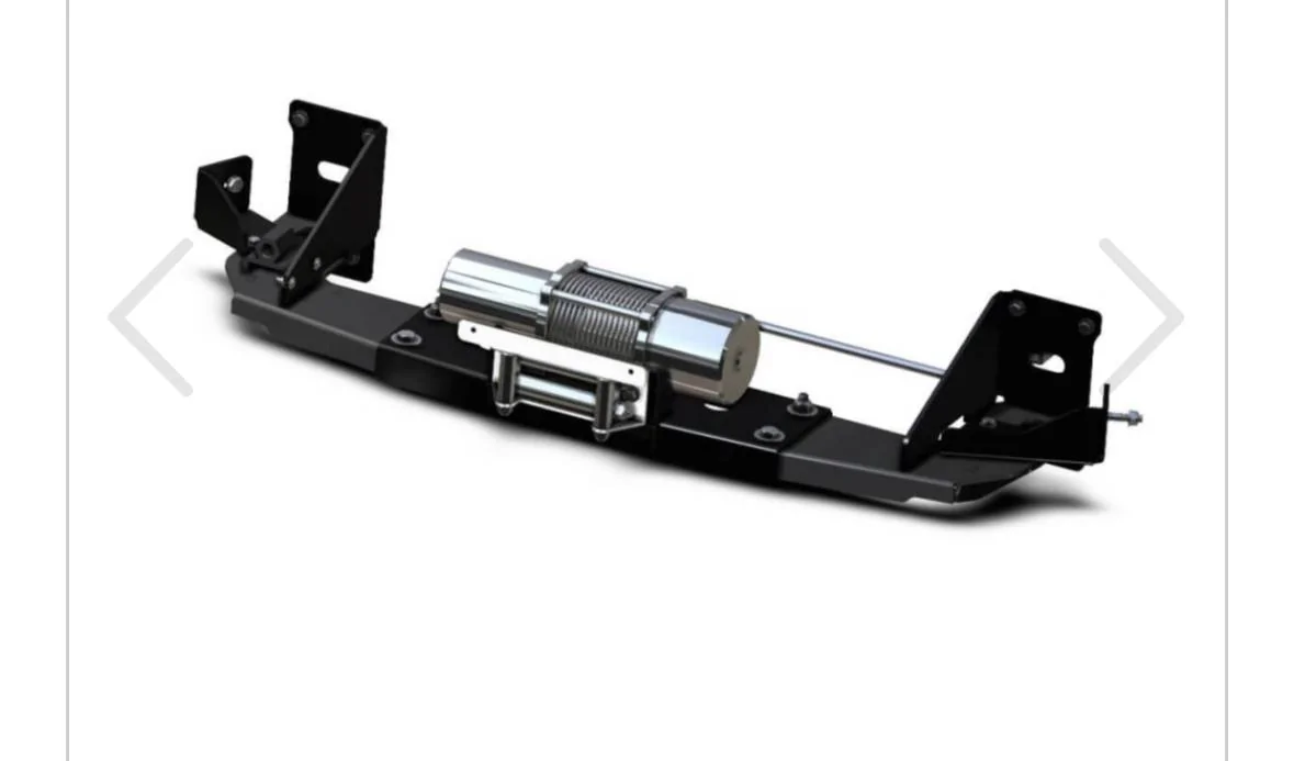

I went down this rabbit hole; it’s annoying because almost every other unibody based offroad car has a workable hidden winch setup, but nothing yet for the sport
Based on a LOT of looking at diagrams and said comparable models, the best bet would be to replace the front crash bar. You’d most likely have to trim off the bottom active shutters, but the frame it bolts into should be plenty strong; this is the same frame point the front tow hooks are in
It’s VERY cramped behind the bumper, but thankfully the sport doesn’t weigh that much so we could probably get away with a compact 6-8k winch. Would look something like this:

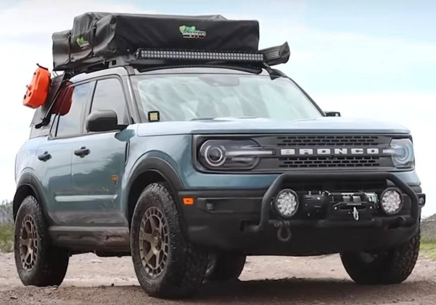

That one is just slapped on the bull bar if I recall them talking another the build; even if it was functional that bar is not even close to structurally rated for where it bolts up. The only bull bar I’ve seen actually recovery rated is the FordRangerLifts one
I would be hesitant to believe the FordRangerLifts nudge bar is recovery rated unless they at a minimum also attached with the 30mm bolts that sit at the rear of the Badlands Towhook in addition to the front bolts. Otherwise there is no reason to believe they are rated for the same work as the factory Badlands towhooks
Does it not tie in back there? In that case there probably ARENT any recovery rated bars I’ve seen
I don't see install instructions listed online for it, but from the images and the fact that it fits non-badlands models, it appears to only attach with the two face bolts on each side that any other manufacturer nudge bar attaches to

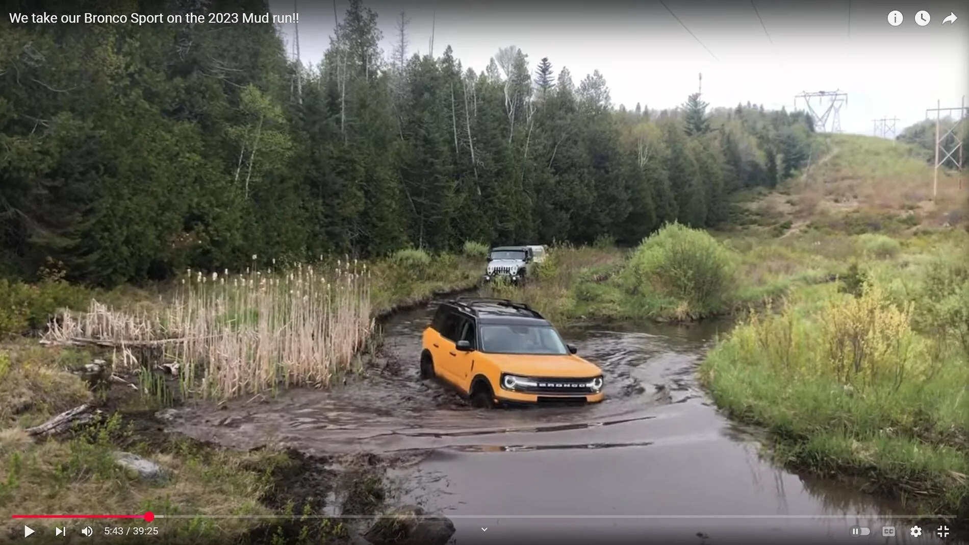

Dude! Is that video posted somewhere?
Yes, on my youtube channel "Low Range in Nova Scotia"
This was last year with our new BS "Daisy" which wasn't on bigger tires or lifted like our 2021 BS named "Baby" that was in the last video. (wrote the 2021 off on black ice)
