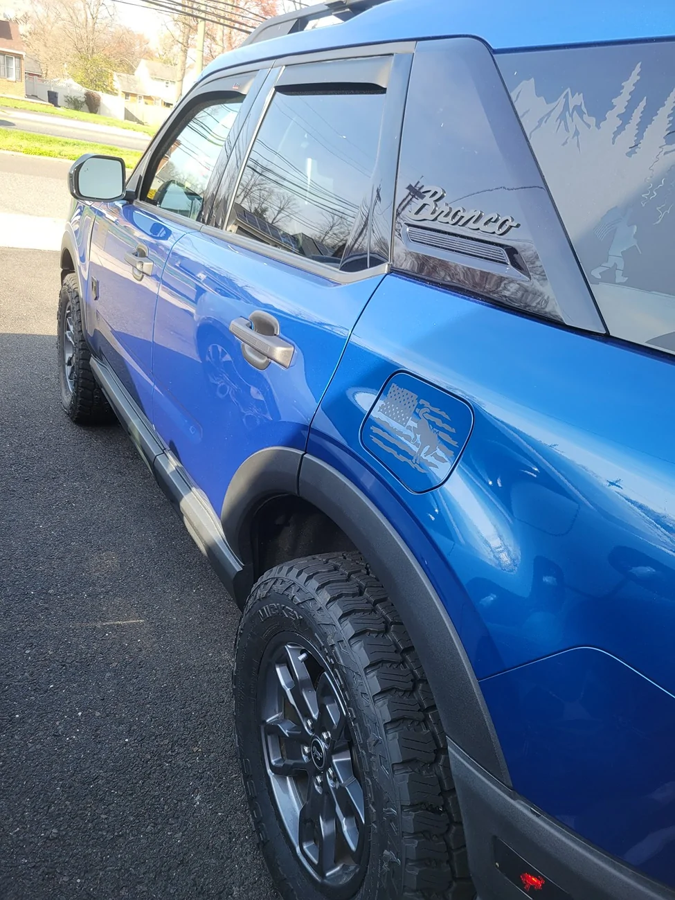

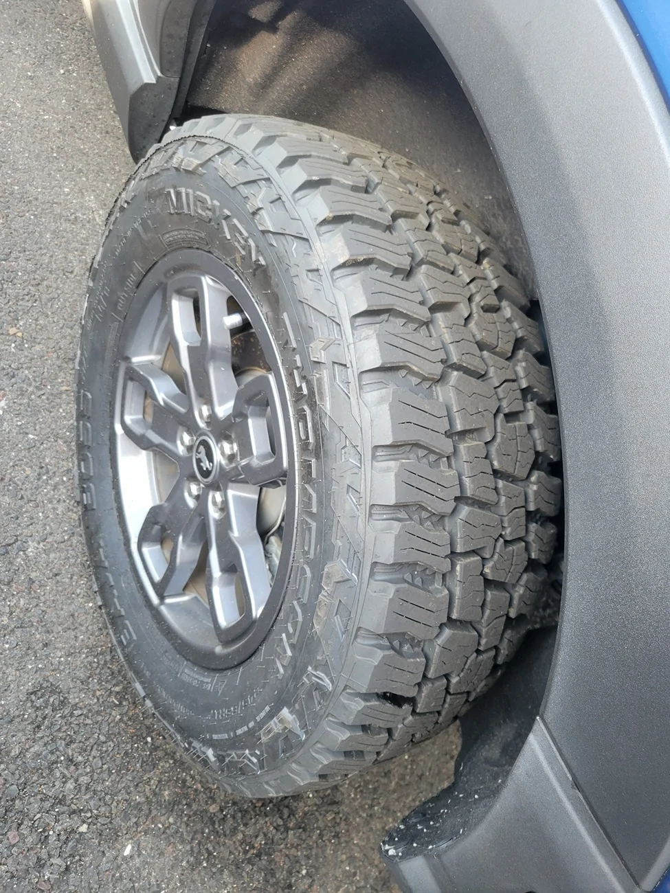

Installed the Rough Country 1.5 lifted struts and upgraded the OEM Continental tires to Mickey Thompson Baja Boss A/T 245/65r17 tires (bought off eBay) ... Are both upgrades, added about 3 inches... After driving a bit I'm sure it'll be a little less than that... Offroad tire installer said the setup was perfect for the BS... That just reinforced I made the right choices... Now to get ready for trail season...

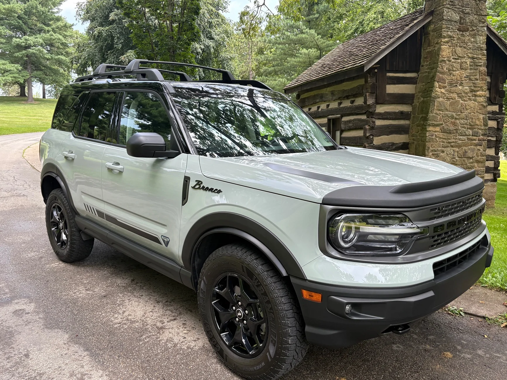

I've been trying to tell people for 3+ years on this forum: The Mickey Thompsons are the best tire to get for form and function. They are a bit heavier, but they look leagues better than any other A/T offering. I basically have the exact same setup.

Looks fantastic! I’ve got a Badlands I’ve been wanting to lift for a while and might bite the bullet on that soon. Do your tires rub at all? Did you have to cut anything to make them fit with the lift, or no? I’ve heard sometimes people have to cut certain things when using that tire size, but that might be without the lift.

No rubbing with the lift... But also haven't had the car stressed/compressed...but still don't see them rubbing.
As far as the lift, I went with the Rough Country lifted strut package... All springs and struts, no spacers, reuse 95% of the OEM bolts.. Install instructions were fine until the torque specs... Googled correct ones for OEM bolts

There is no rubbing at all. I have had the same setup for 60,000 miles. Also the tread is holding up fantastic and I can likely get at least 15,000-20,000 miles out of them.
