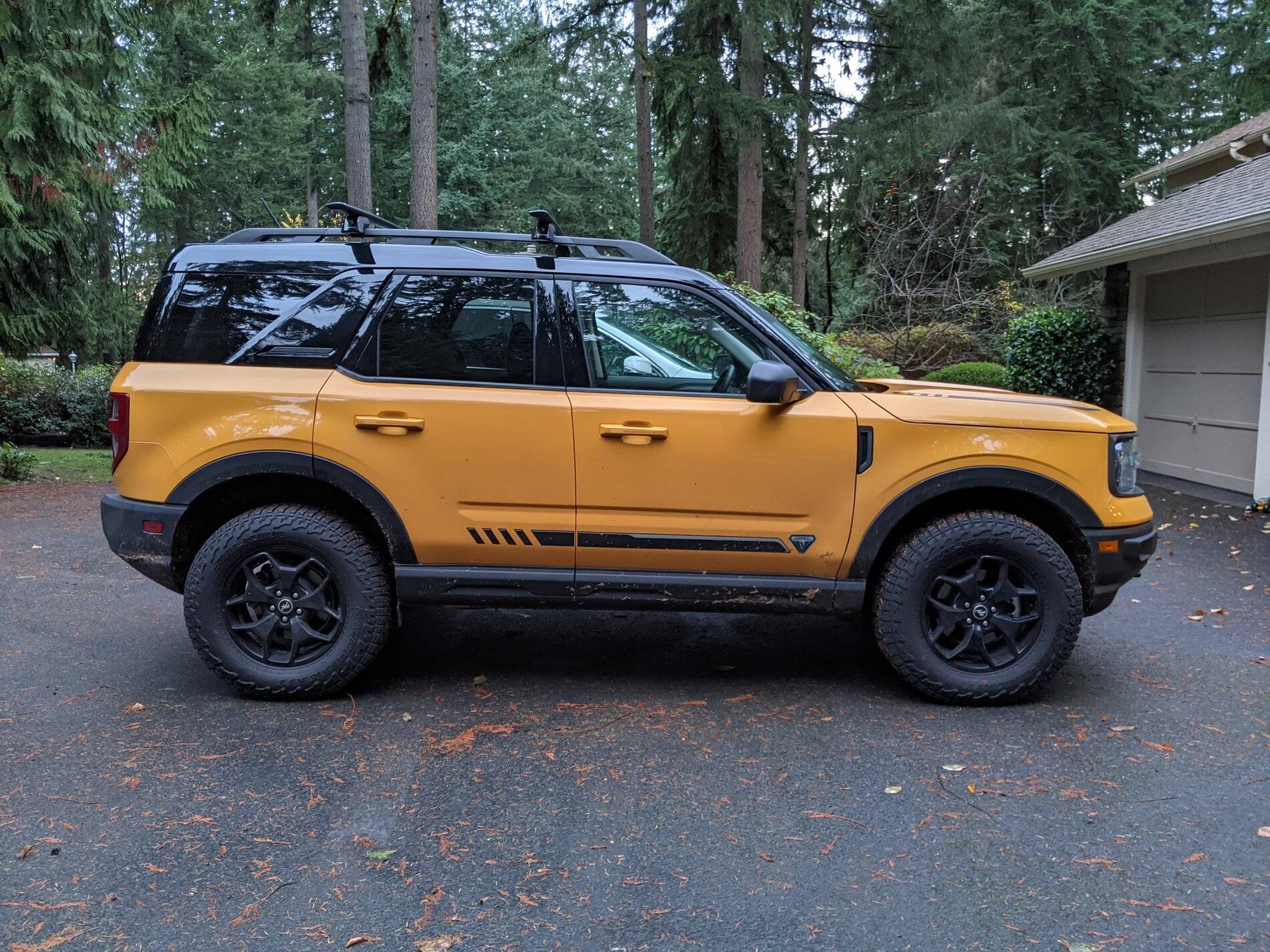

Now really happy with the end result of the lift and 245/70R17 Falken Wildpeak AT3W.
Ford Bronco Sport Lift Problems *Solved* PXL_20211120_002255589.MP
So after the tire size increase and lift what is your over all gains, ? are they a 30 inch tire ? And what is your clearance now versus 8.8 . Thanks

Stock tires 235/65R17 measure 29", 245/70R17 are 30.5...so 1.5" difference(.75" lift).
8.8+.75+1.25" come to 10.8" ground clearance. Same as a Jeep Rubicon, I'm good with that ?
