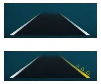

There is also a button on the end of the shifter that turns the lane assist on/off, I would try toggling the button.
What do you get on the driver display? when my lane assist is on I get two white lines on the display when the BS has identified lanes. When I cross these lines in alert mode it will rumble the steering and turn the line red. In alert +assist it will correct and turn the line yellow.

There are two different levels of assistance provided by Copilot 360. The first and least obtrusive is Lane Keeping Assist. You have to get quite close to a line for the system to activate. When it does you'll feel a slight nudge in the wheel steering you away from the line. If you approach the line at too steep an angle you may not feel a nudge at all, but as you cross over the line you should feel a rumble in the steering wheel similar to hitting rumble strips. When you turn the system on using the button at the end of the turn signal lever you should see the indicator in the instrument cluster. It's a graphic of two converging lines representing the lane edges.
Ford Bronco Sport Lane Assist Not Working LaneKeepin
When the system sees you approach a line it will turn yellow just before it gives you a nudge. The system also monitors your wheel inputs, and if you don't make one within a certain amount of time you get aural and visual warnings.
The second level of assistance, called lane centering, is available with Copilot 360+. It's a much more aggressive system, and it activates much farther from the lines. It only works when you engage the adaptive cruise control.
Lane Keeping Assist is independent of the cruise control, and should be functional any time you have it turned on. What I would do is watch for the display in the instrument cluster to go on and off with the switch. If it's not coming on then something is wrong with the system. If it comes on then monitor it as you drive. Allow the car to slowly approach a lane edge and see if the display changes the colors on the line. If it doesn't then the sensor is likely not working. If it does then check to see if you get a nudge in the wheel and/or the rumbling after you cross the line. If you don't get the nudge or rumbling then the system is not working properly.
