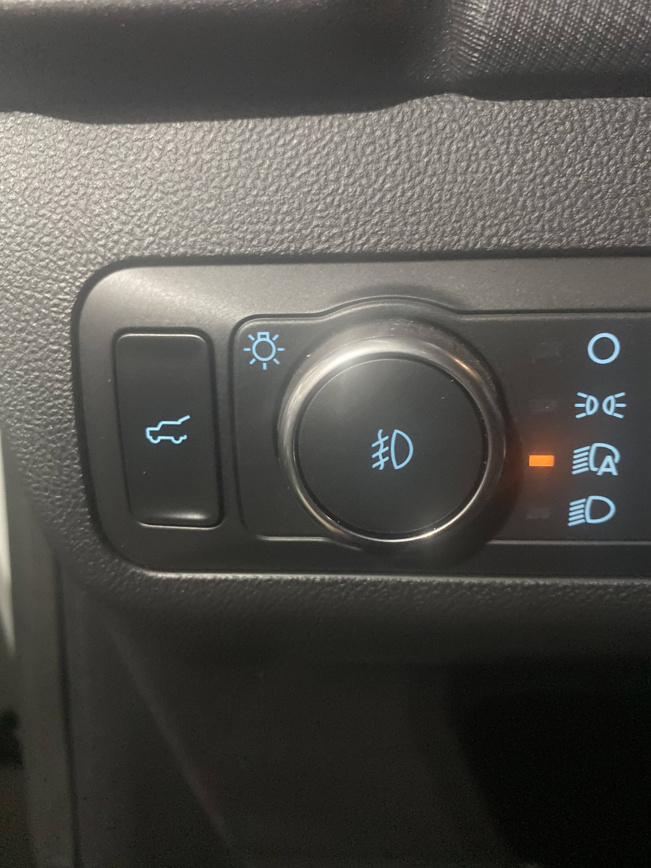

Is there a hatch release button on the dash? If not, you may not have the necessary electro-mechanical mechanism.
Yes left side of steering wheel .

The liftgate release is just a momentary contact switch. If you were inclined, you could wire a second switch in parallel over the existing button's contacts and locate it somewhere inside. Preferably where you can't accidentally press it but that's up to how much wire you use. If you ran wires back through the liftgate harness boot, it could even theoretically be up on the dash or headliner. But I think the backside of the wiper "bump" would be sufficient.
