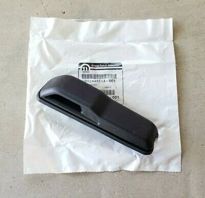

My daughter just ordered a 2023 Bronco Sport Badlands and was disappointed with it not having the Tiedown on the hoods like the standard Bronco. Has anyone attempted using the Jeeps (see picture) Hood Stop as a tie-down replacement to their hood?
Or is anyone going to make an aftermarket Tiedown reinforced on the other side of the hood for strength? I know it's evil to bring up Jeep but it would be better with canoes or Kyaks!

If you are only doing it for looks, then continue. If you intend to actually use them to tie down, then this is a huge safety issue for the BS. The hood is a “clamshell” hood on the BS but isn’t on the Bronco. If you put tension on the hood corners you will most likely bend the hood, especially once you are out on the highway. It is a safety issue too as you could possibly overload the hood latch and have the hood fly open on the road.
I like the looks but I also understand that they cannot be functional on the BS.

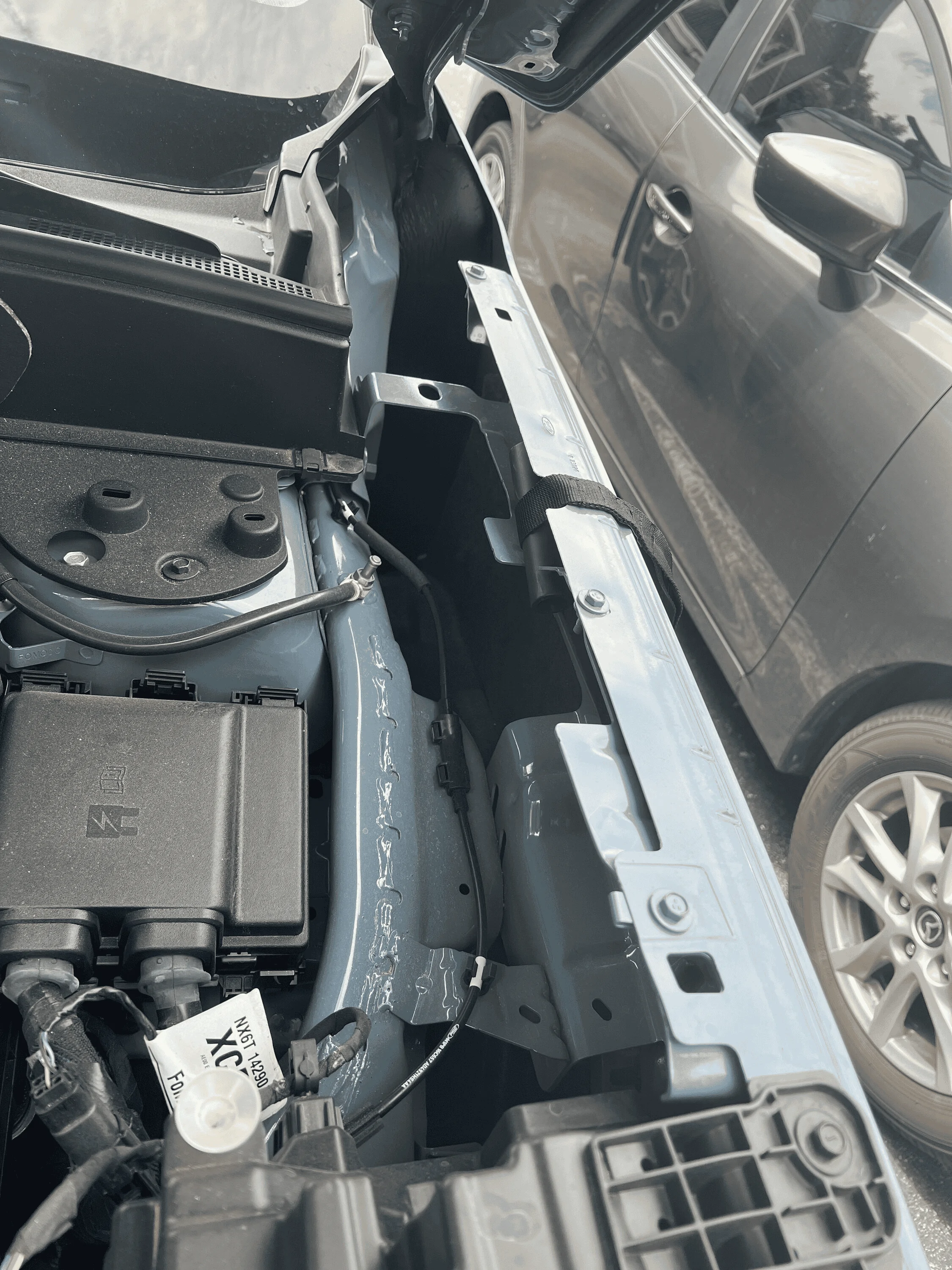

Use the 'dog bones strap" it is designed to fit under the cut out under the hood on each side. Held in place by the side panel and not the hood itself. google - look for photos.
