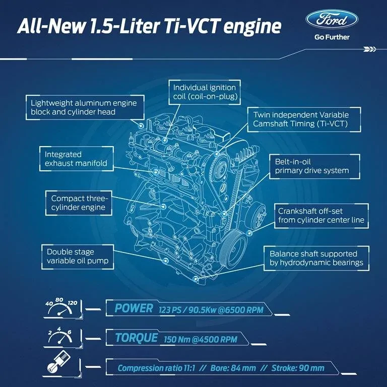

In that last post of the drawing , is that power info at the bottom correct for what we have in the BS ?

It has a belt for sure. One of the reasons we opted for the 2.0. I'll take my chances that they addressed the block/headgasket design flaw over that belt. Still got Ford Protect for 8/125
1,231
1,918
'21 BL+BL
The BS does have different specs just like every vehicle that uses the same power plant does. Everything possibly found on the web (outside of one person posting on the forum) indicates that the 1.5 Dragon series uses a belt which is what I searched to get that diagram. If you look it up on parts.ford, it comes up as Timing Belt/Chain shared part #6268 for both 1.5 and 2.0. If someone does a teardown, I'm willing to be wrong but I just don't think so.
1.5: https://parts.ford.com/shop/en/us/engine/other-engine-parts/beltchain-timing-12062947-1
2.0: https://parts.ford.com/shop/en/us/engine/other-engine-parts/beltchain-timing-8991241-1
That info tells me nothing about the two Parts ,except they have different dimensions & cost .

While not the most scientific research, since the 1.5 Ecoboost inline 3 is used in the 2020 Focus as well as the 2021 Bronco Sport, I looked it up on Rock Auto and it is in fact a timing belt.

FORD 1.5L ECOBOOST DRAGON ENGINE
Last modified on July 28, 2020
Overview
METRICVALUE
Engine familyEcoBoost
Displacement1.5 liter
AspirationTurbo
Configuration & cylindersInline, three cylinders
Vehicle engine orientationTransverse
Valve configurationDual overhead cam (DOHC) with variable camshaft timing (VCT)
Assembly siteCraiova, Romania
PredecessorFord Sigma engine
SuccessorCurrently none
Specifications
METRICVALUE
Bore79.0 mm
Stroke76.4 mm (3.00 in)
Compression ratio10.0:1
Max power @ RPM197 @ 6,000 rpm
Max torque @ RPM214 @ 1,600 rpm
Cylinder headCast aluminum
Cylinder blockCast aluminum
Camshaft driveBelt
Vehicle Applications
VEHICLETRANSMISSIONDRIVE WHEELSPOWER@RPMTORQUE (LB-FT) @ RPM
Ford EscapeEight-speed automaticFWD / AWD180 @ @ TBA177 @ TBA
Ford Fiesta ST (Europe and Asia)Six-speed manualFWD197 @ 6,000 214 @ 1,600
Ford Focus (Europe and Asia)Eight-speed automatic / Six-speed manualFWD150 @ TBA177 @ TBA
Discussion
Discuss the Ford 1.5L EcoBoost Dragon engine
Looks like a Belt

According to the Ford workshop manual, direct from Ford, this engine has a timing chain. However, the oil pump is belt driven off the crank shaft behind the timing chain sprocket.
fourthgear
Jan 31, 2021
528
594
florida
I would like to see that Photo or Drawing .
fourthgear
Jan 31, 2021
528
594
florida
Cool , #'s 2,3 & 4 appear to be Chain Guides , they wouldn't be used on a Belt & # 1 looks like an oil pressure activated Chain tensioner .
Bigridge83
Billy
May 14, 2021
39
35
‘21 Bronco Sport,’18 Ford Fiesta,’92 Ford Explorer
100% correct. And the oil pump is belt driven and the balance shaft (#10 on second pic)is gear driven. It’s definitely busy behind the timing cover on this little guy ?
fourthgear
Jan 31, 2021
528
594
florida
Maybe thats what a lot of people are talking about , as far as a in oil Belt & not the Cam Timing Chain ?
Bigridge83
Billy
May 14, 2021
39
35
I may have figured out the confusion…the 1.5 3cyl duratec (non ecoboost) does in fact have a timing belt. That engine would be used in the ecosport. However it does not have the cylinder deactivation feature. Maybe that might be why the ecoboost has a chain and the duratec has a belt. That’s just a guess though.
