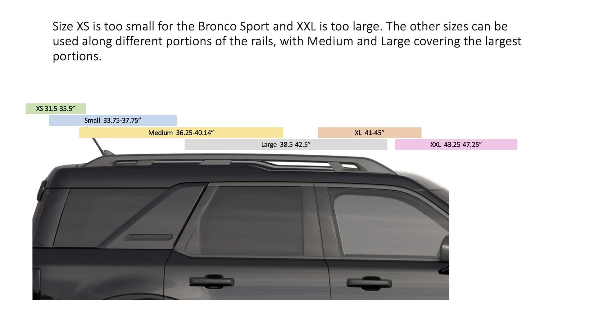

So I installed Yakima RailBars on our Bronco Sport Badlands even though the Yakima website indicates that they're "Not Compatible". When I first read that it didn't make sense to me because the RailBars are specifically designed to be installed on raised rails like the Sport has. Anyway, they installed just fine. We've had them on for a few weeks now and have had them carry kayaks and ARB awnings just fine.
Thought I'd share what I learned in case someone else is interested in all the nitty gritty details.
Ford Bronco Sport Installing Yakima RailBar crossbars—what I learned Bronco Sport Yakima RailBar fitment 1

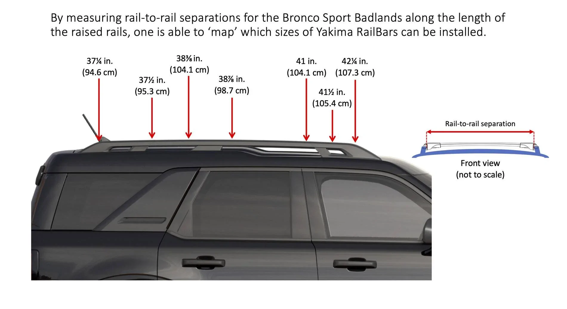

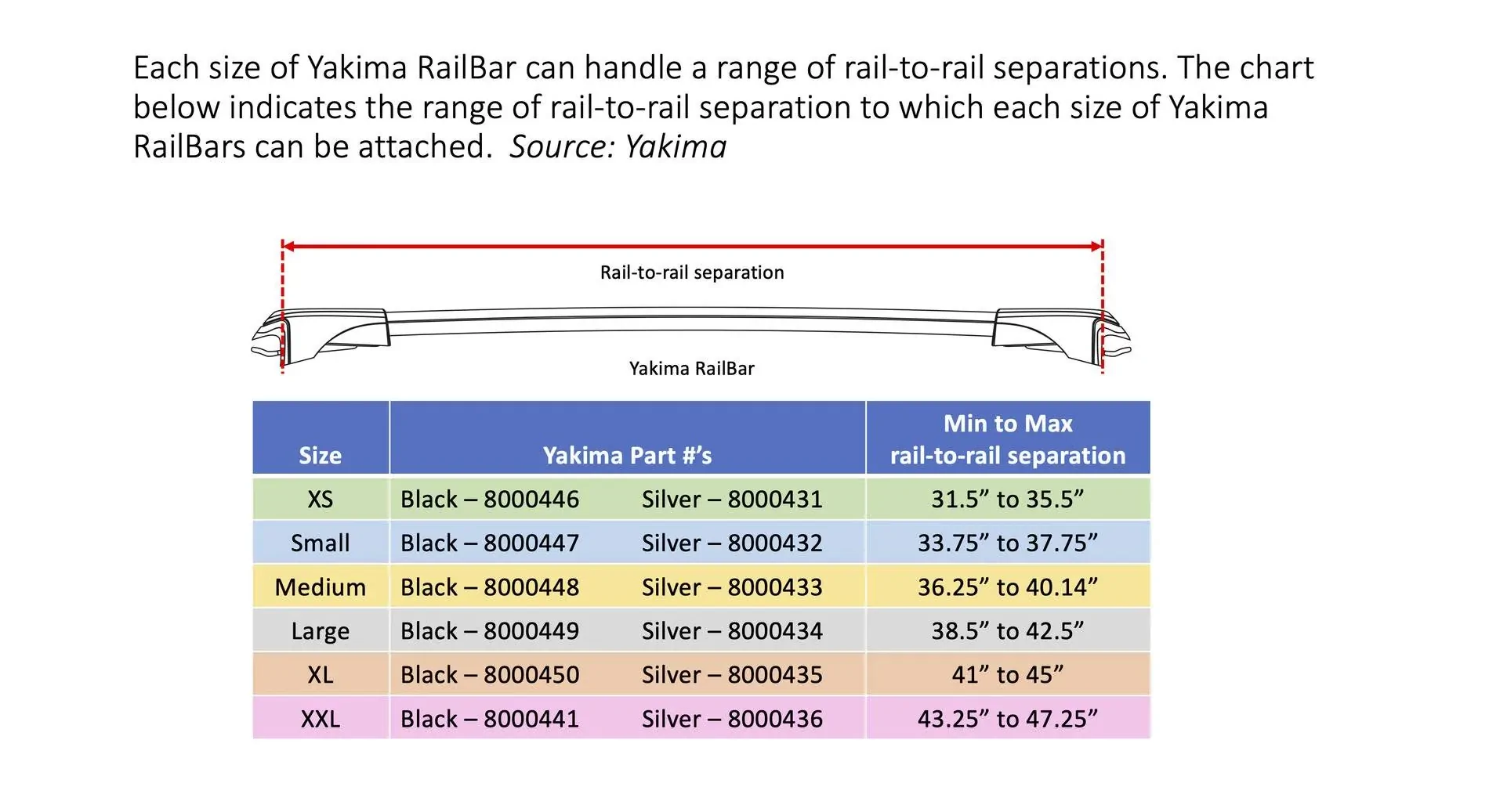

As you can see, the RailBars come in six different sizes. You have to match the range of separation each size can handle to the separation of the rails on the Bronco Sport. So you have to measure, or you can just take a look at the diagram below.
Ford Bronco Sport Installing Yakima RailBar crossbars—what I learned Bronco Sport Yakima RailBar fitment 2
Once you measure, you can figure out what size RailBar can be used with the Bronco Sport.
Ford Bronco Sport Installing Yakima RailBar crossbars—what I learned Bronco Sport Yakima RailBar fitment 3
Turns out you could use a combination of sizes, from Small all the way to XL. That may be useful to know depending on availability. I got one (they are NOT sold in pairs) Medium RailBar and one Large. Obviously the Large was placed up front.
BTW, I chose the RailBars because we park our Bronco Sport in an underground parking lot. There is a point where the clearance is only 6 feet 6 inches, so every inch mattered. On top of the RailBar we sometimes have the Yakima JayLow, a collapsible kayak carrier. We still have a couple of inches to spare, but I don't think that would have happened with the Yakima Timberline System.

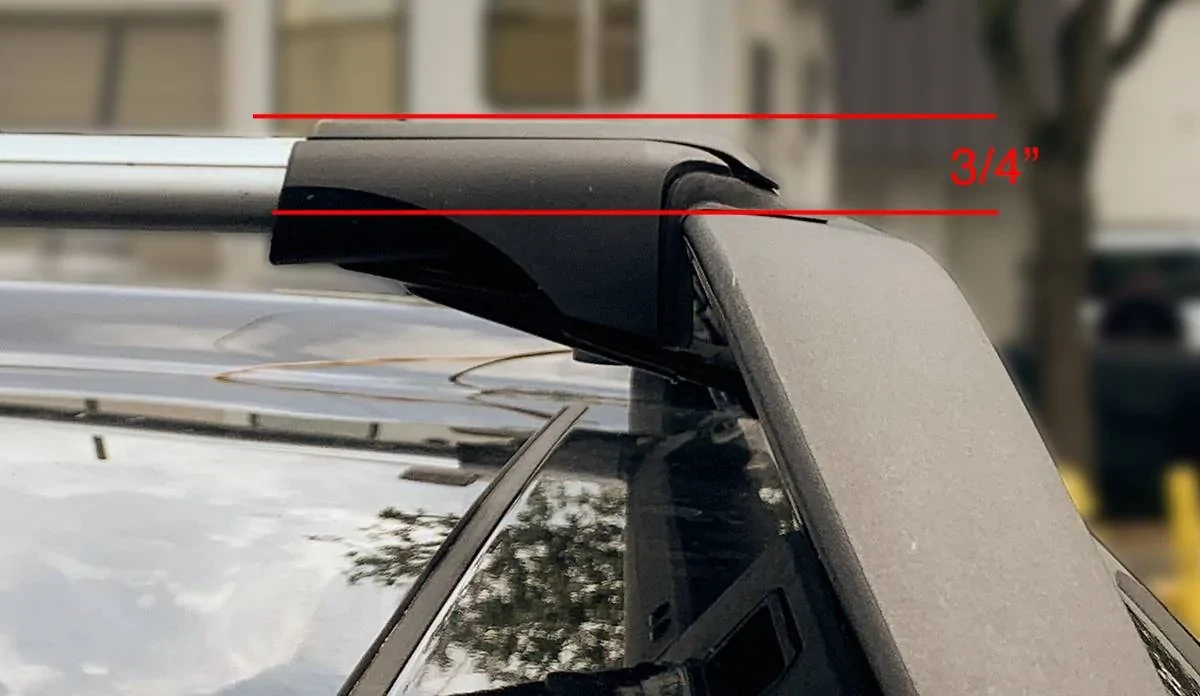

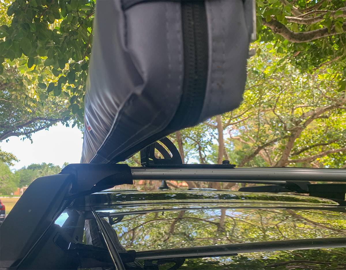

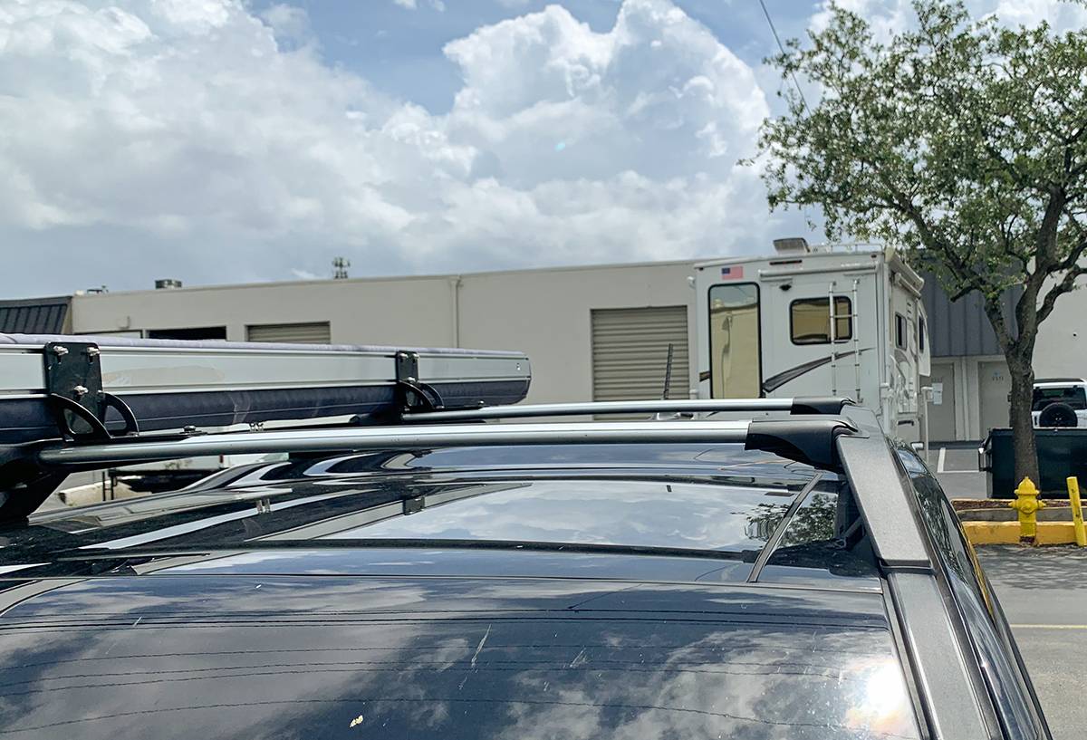

I wanted to post pictures at the time, but you know how it is. Here they are. One important measurement is that the RailBars only add ¾" (0.75 inches, 1.9 cm) to the height of the factory installed raised rails.

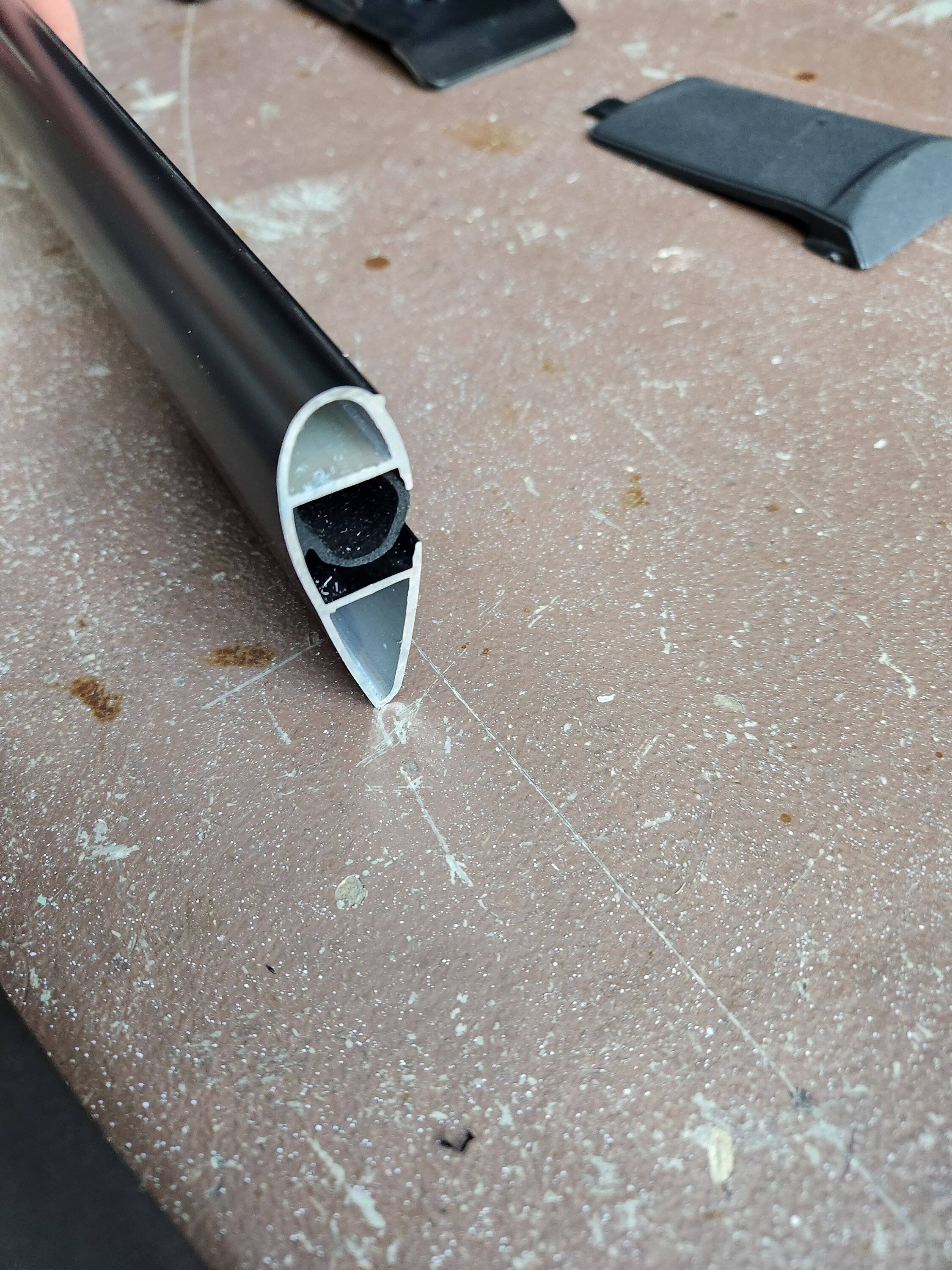

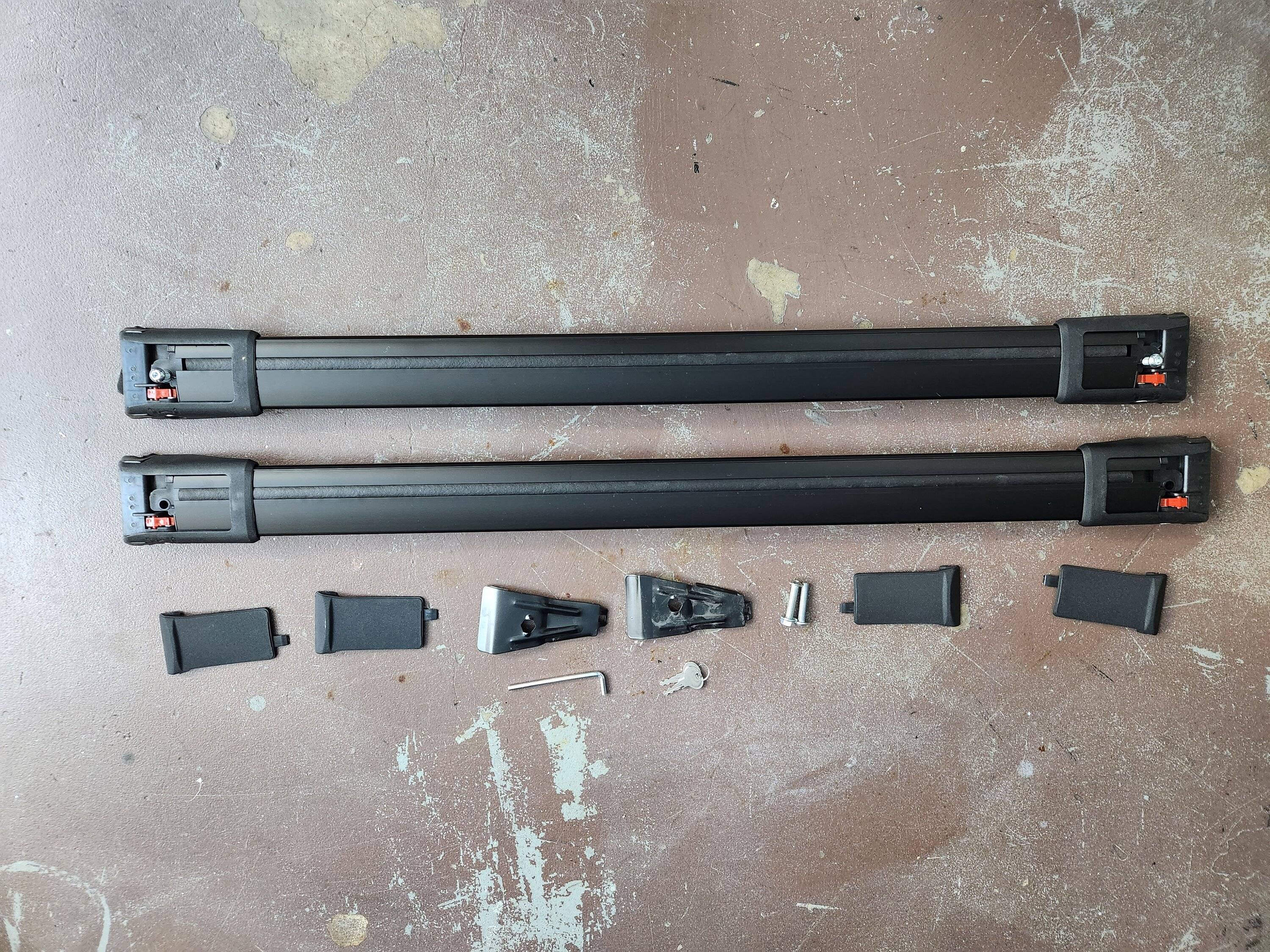

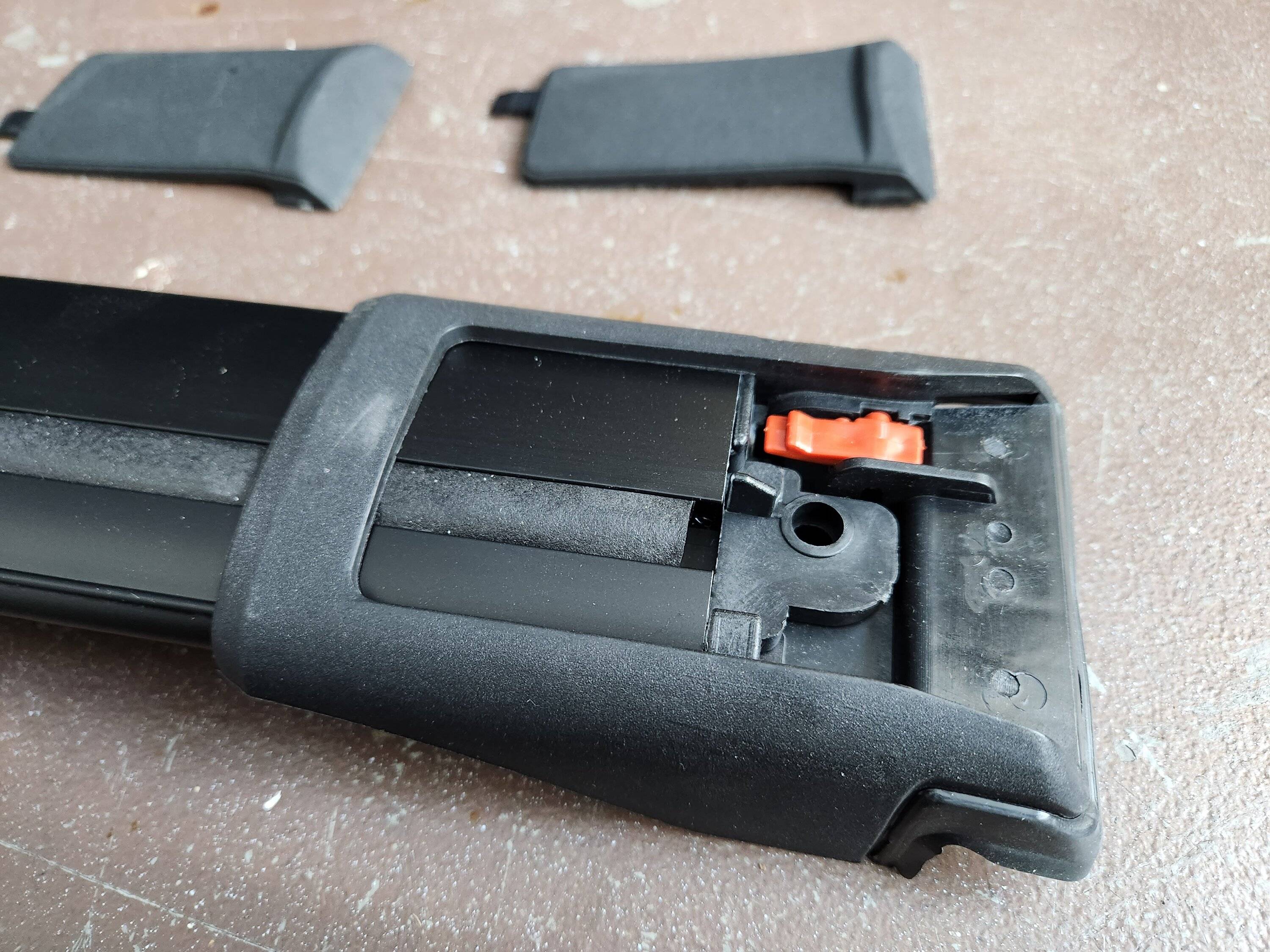

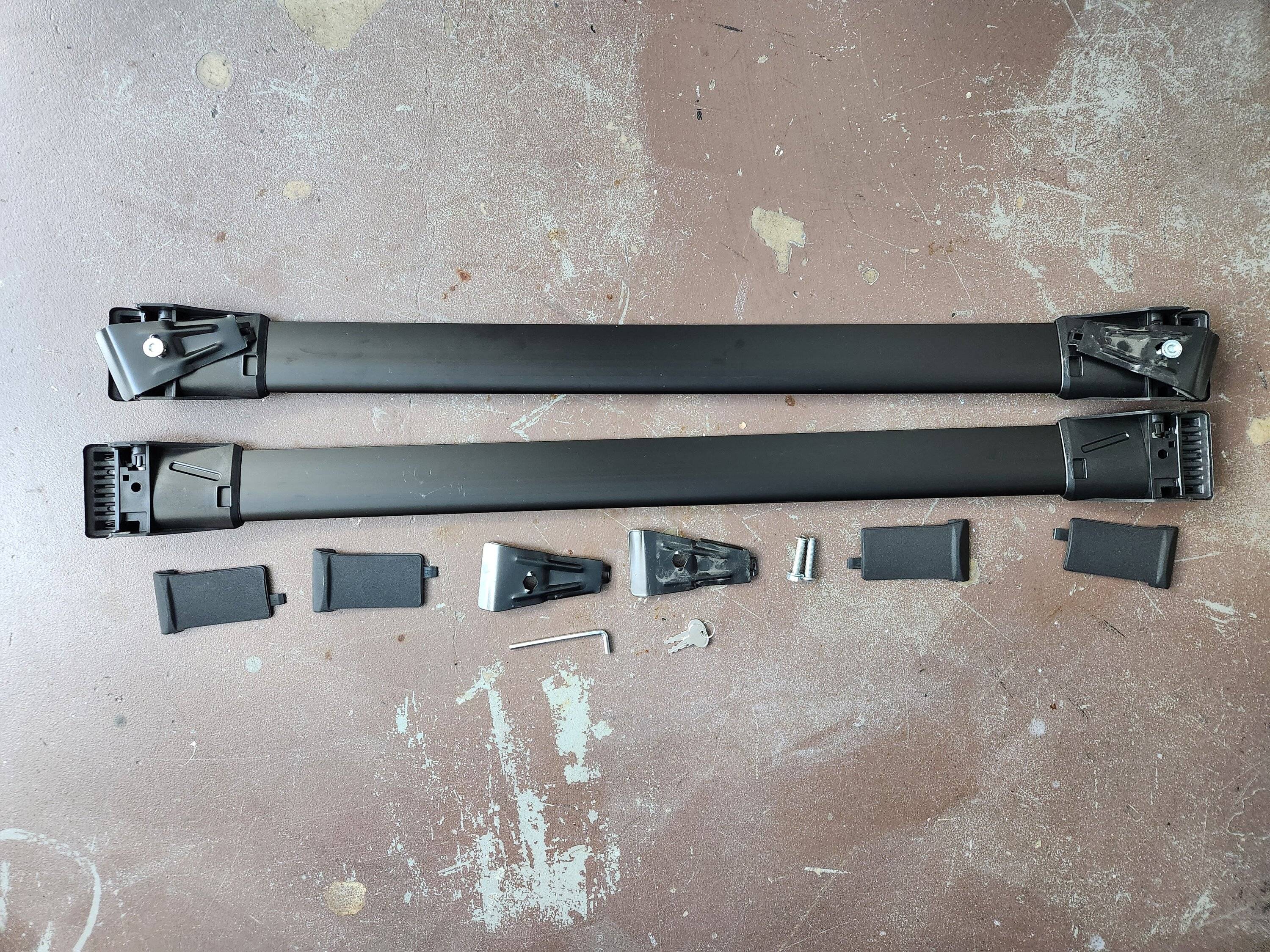

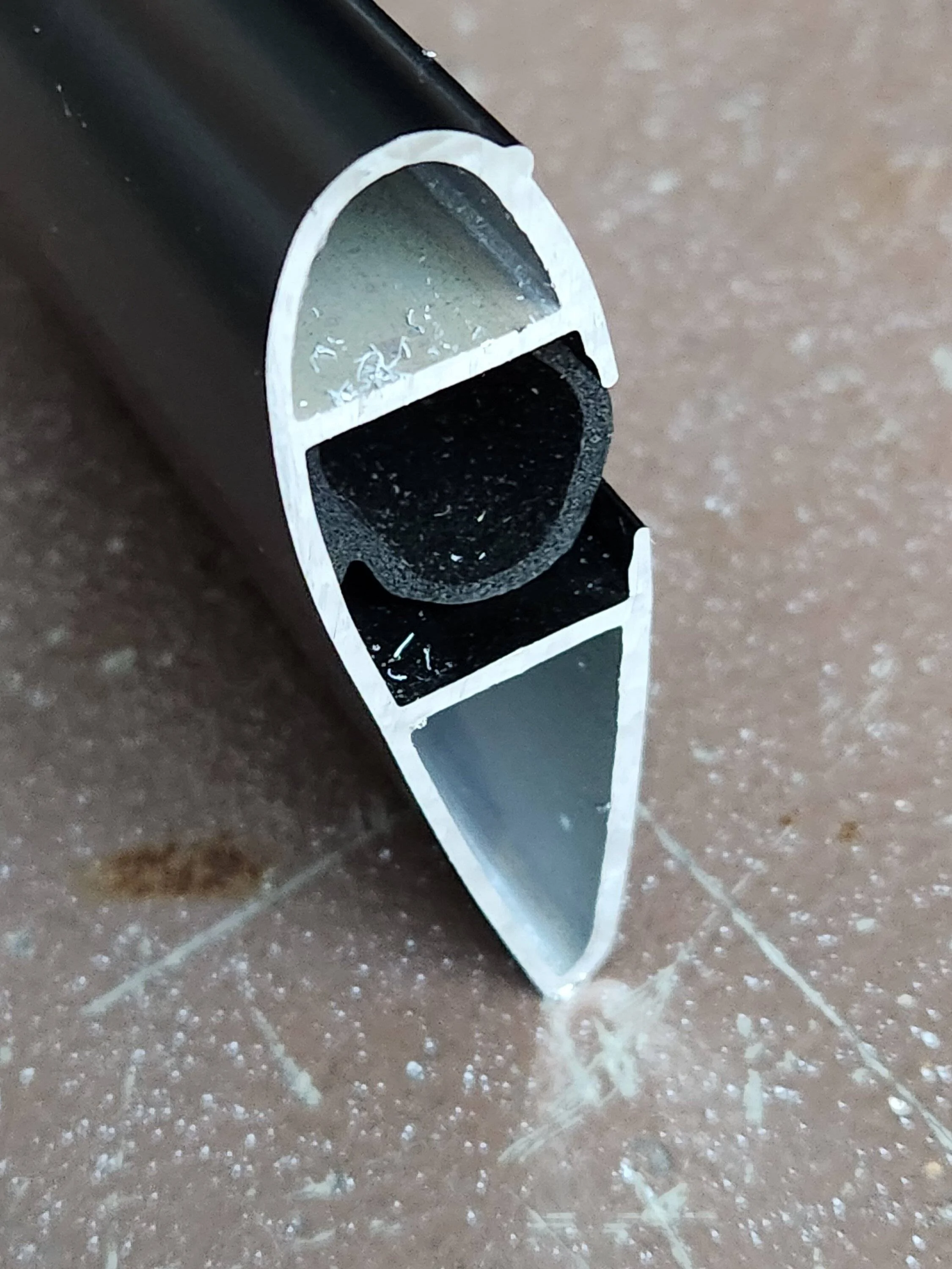

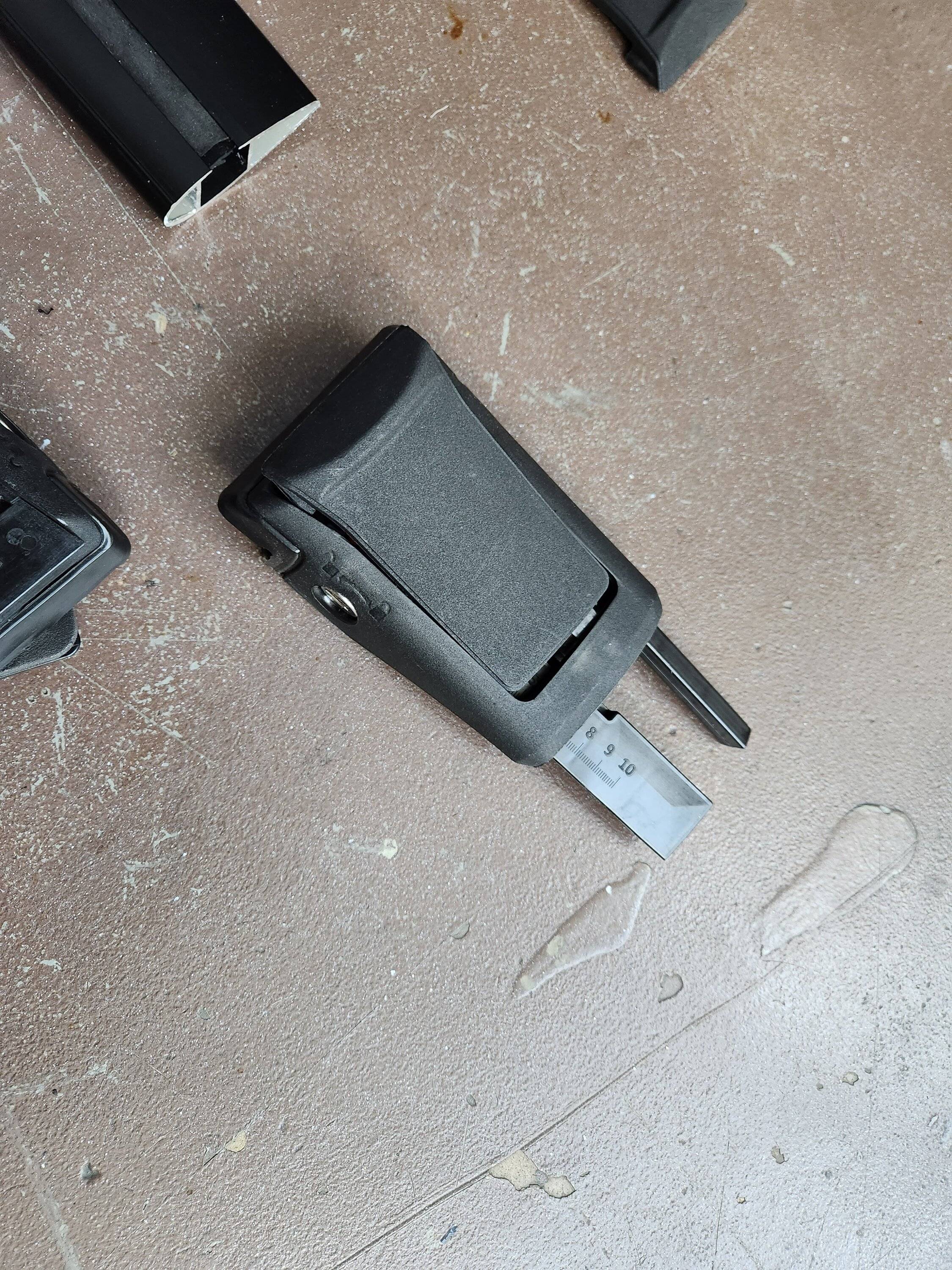

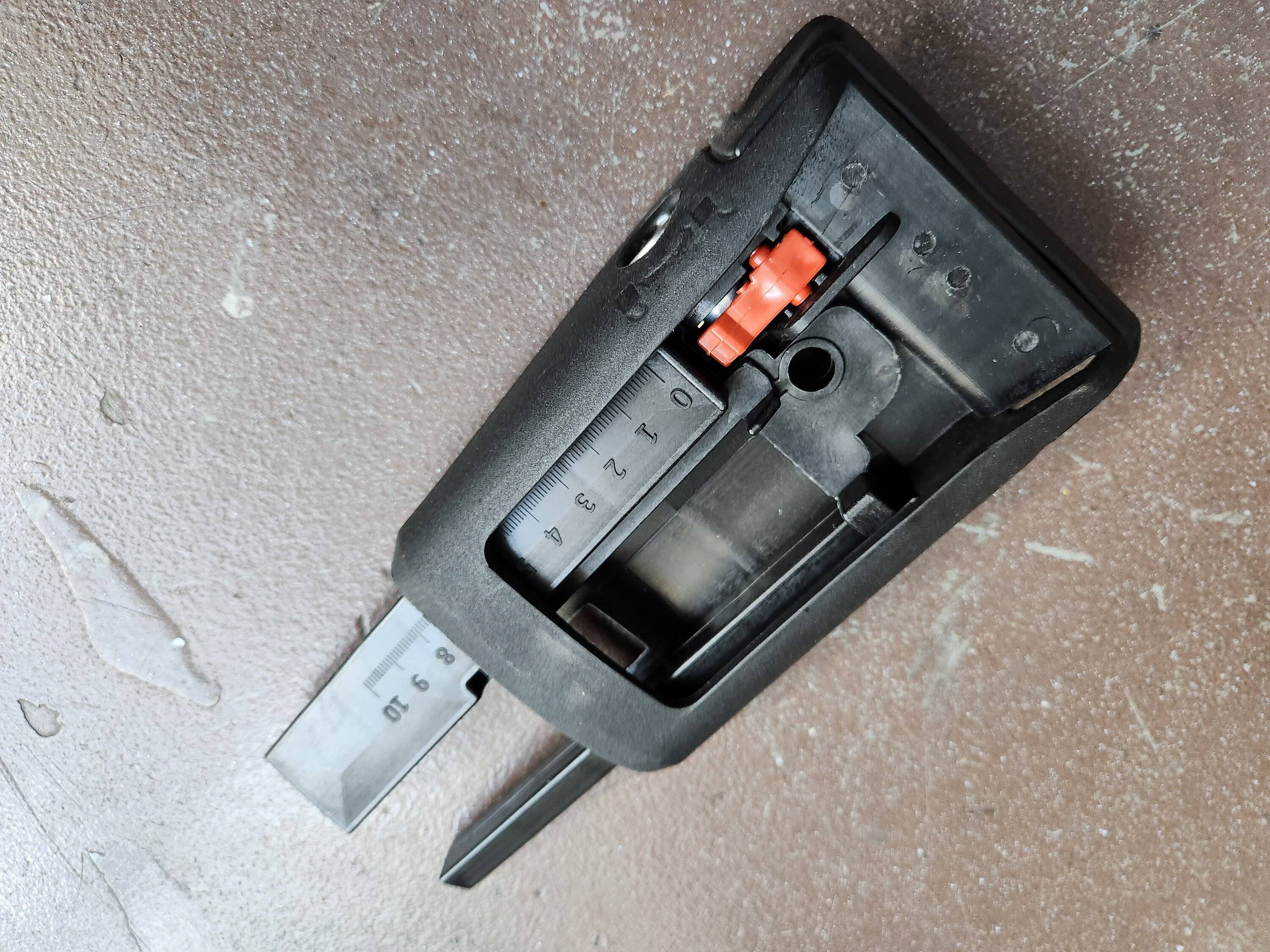

I started looking for other options and found what appear to be some Yakima Railbar knockoffs. They seem to have good features. I took a chance on them based on cross referencing other bar packages offered by Yakima in the past. Volvo XC70 came up as having similar roof rail dimensions/Railbar lengths as the Bronco Sport Badlands (one medium and one large). I tried to get the actual bar lengths from the eBay seller prior to ordering, but had no response. I bought them anyway assuming I could cut the bar down, based on photos.
The "Hippo" Bars arrived today and the rail to rail lengths are similar enough to the M and L Yakima Railbars that they should work.
Rear bar is 38in
Front bar is 39.5in
The length can be extended by two or three inches on each side, maybe more. They can also be cut down to any length you want. A half-inch off the rear bar would allow it to slide it all the way back on the Badlands rails. I'm not sure cutting is needed, but I will find out when I try to install. I'm going to test mount them this week. They do look promising though and were only $150. There is a missing nut that was lost in transit, so I will have to go to the hardware store before I get started.
Here are some preliminary photos of the bars and clamps. They even come with a lock!
