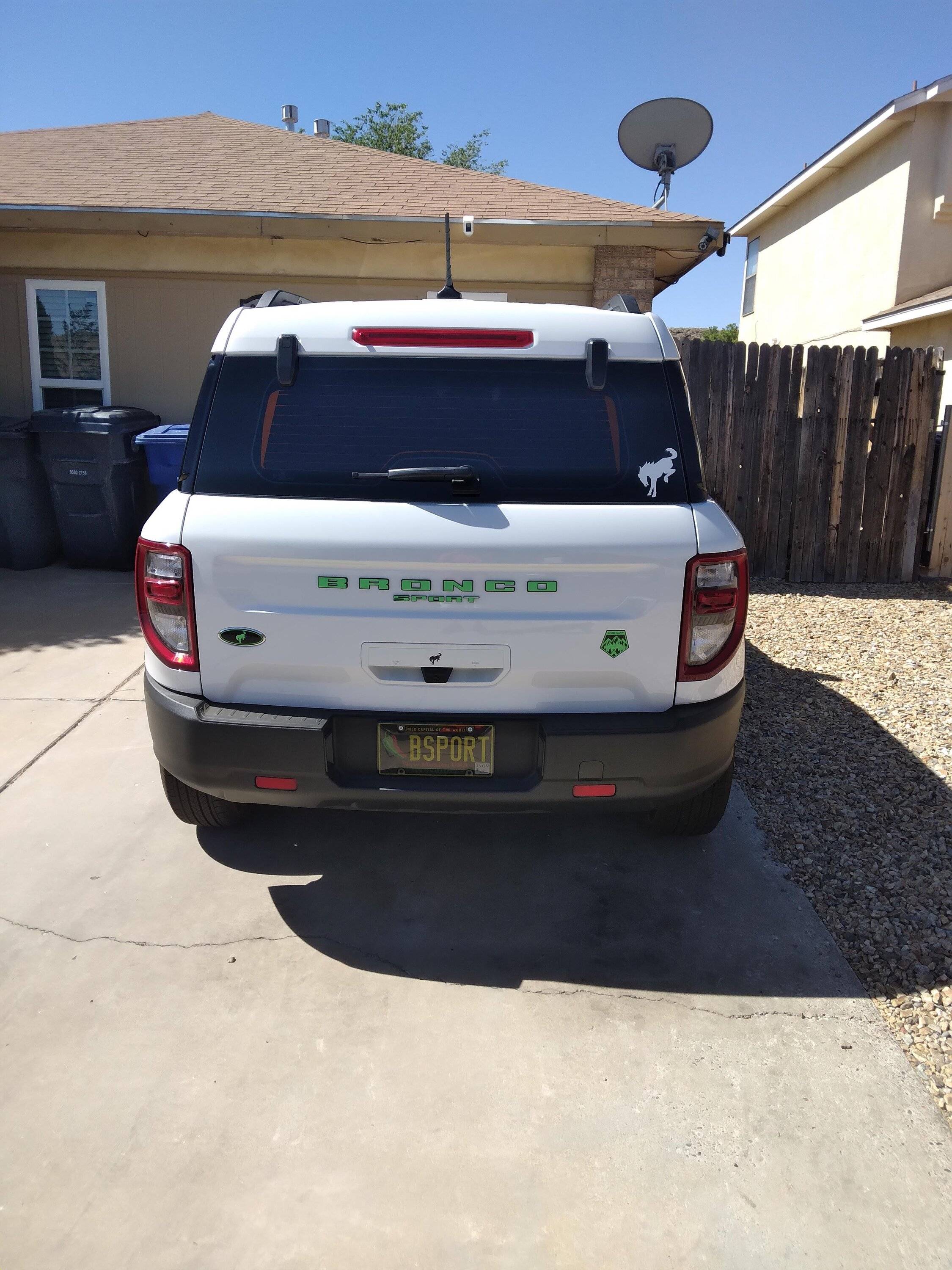

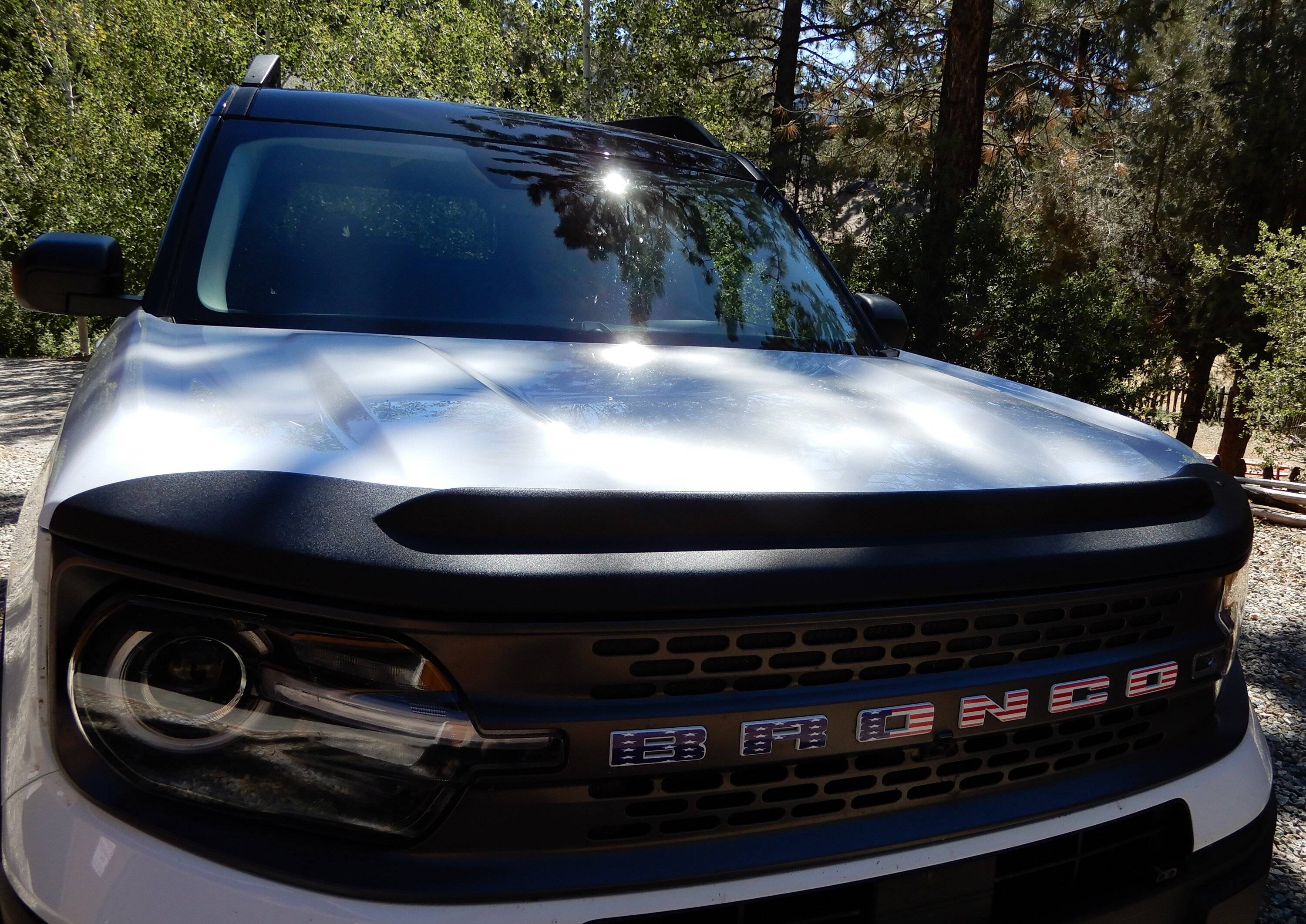

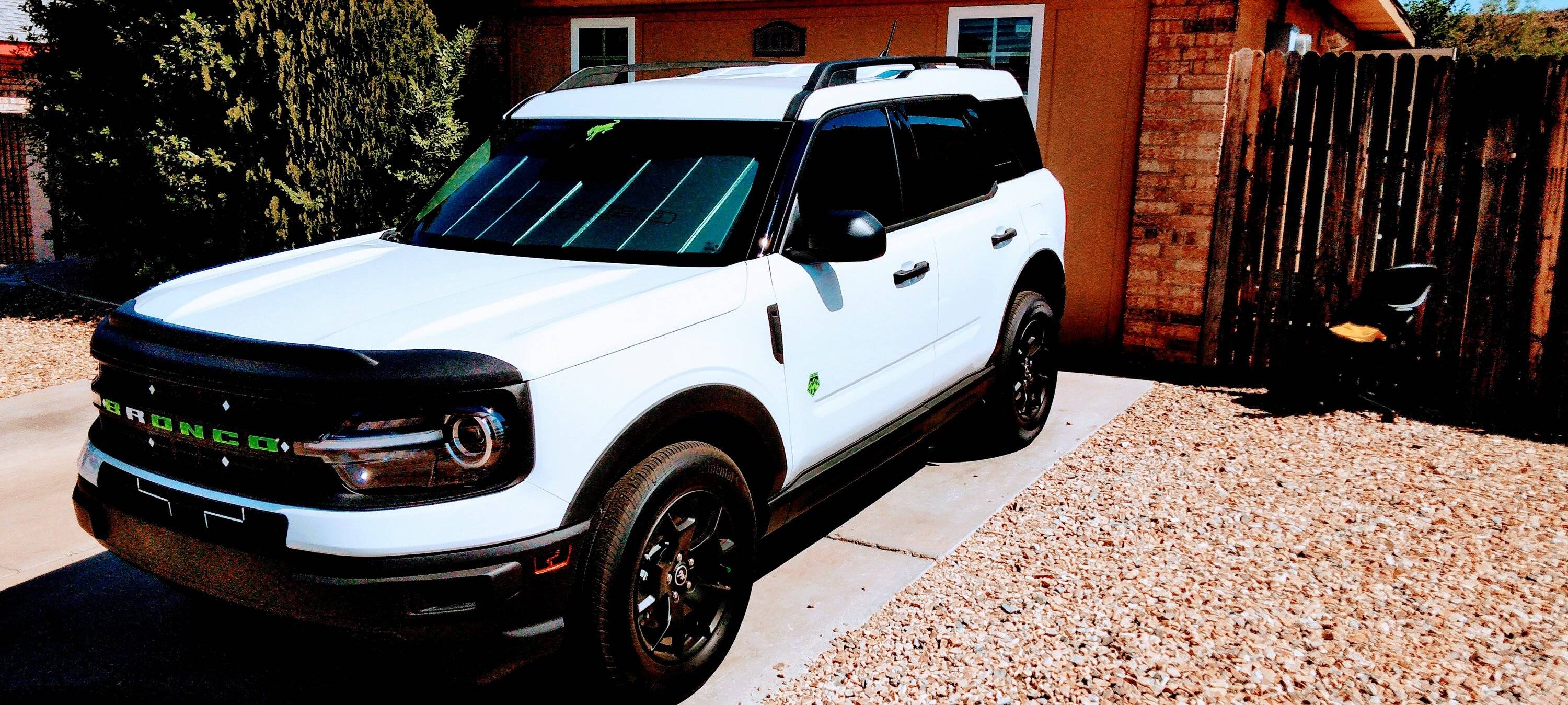

Just do the overlay. Ive switchred colors 3 times(red, white green).. and costs me 64 bucks each time
3 base camp badges
Front and back lettering
Pin stripes and diamonds
Ford badge overlay with bronco
2 bucking broncos

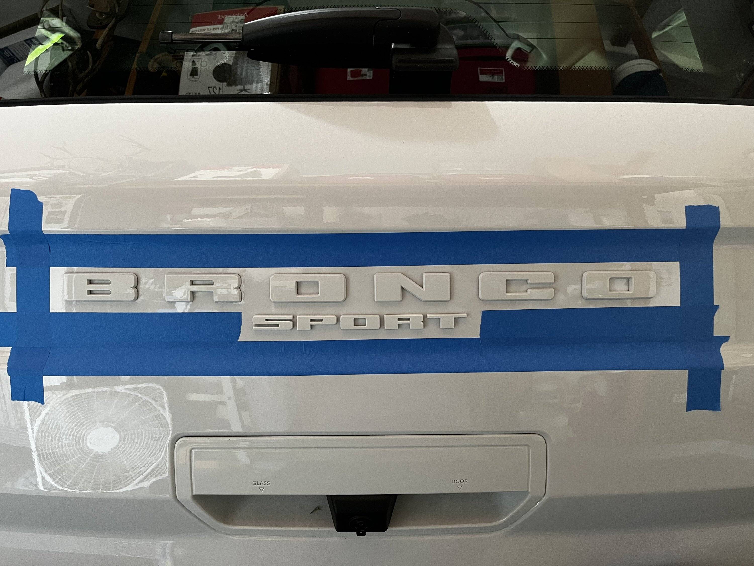

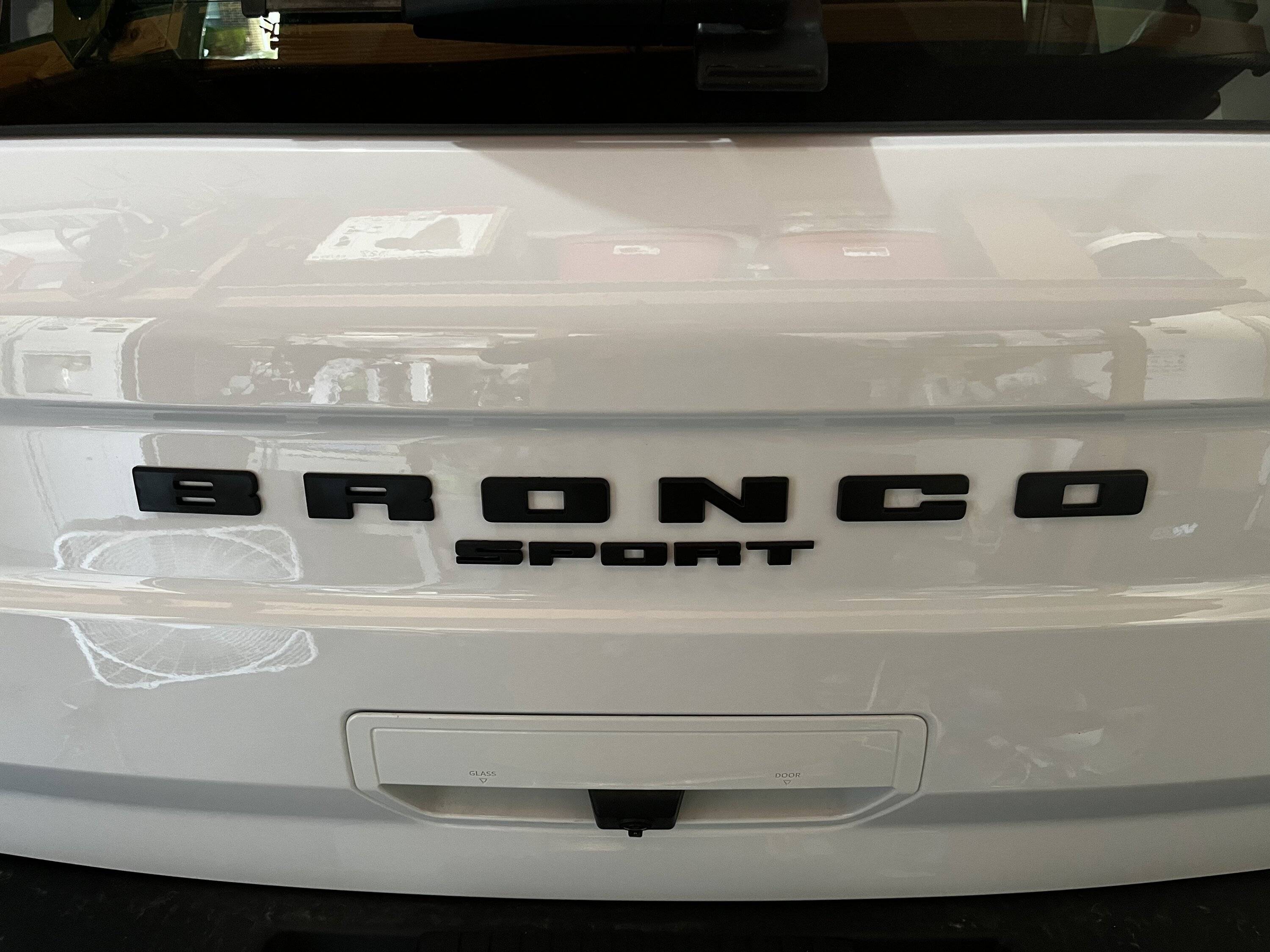

You don’t have to pay anyone to do it. I would put tape along the top/bottom of the letters, mark on the tape where each letter is so you know where to put the new letter. Use some dental floss to and pull it back and forth behind the letters until they come off. You will need some adhesive remover to remove the residue from the factory letters. Then using the tape and marks place the new letters on.
This is pretty much what a body shop would do as well and charge you at least a few hours of shop time to do.
Thank you. We did it in not time at all. Dental floss worked great but we also used a heat gun on low setting which made it super easy.

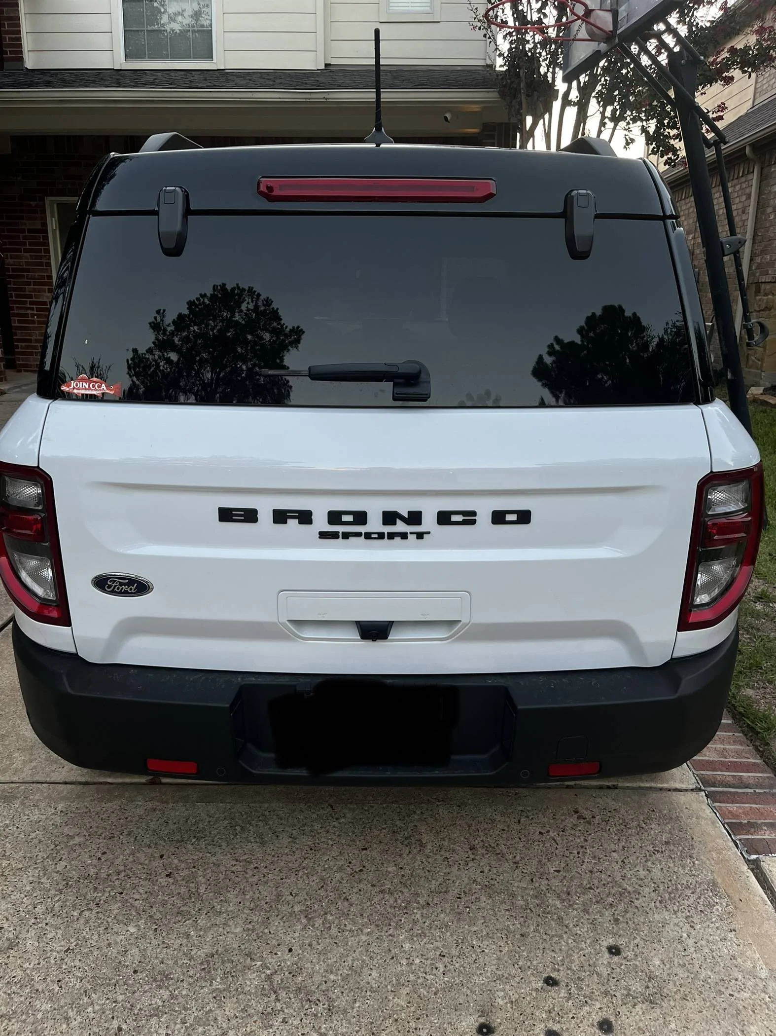

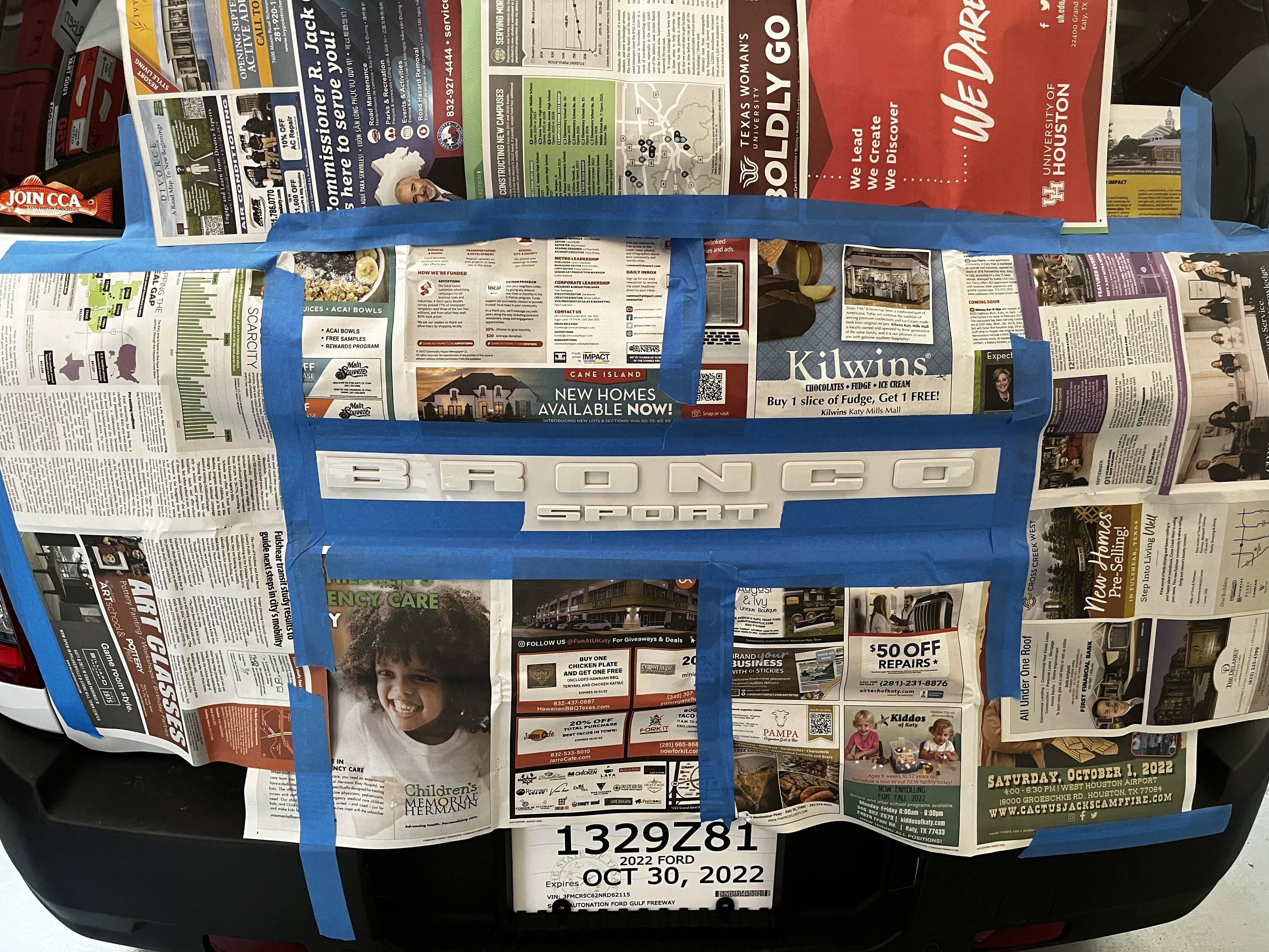

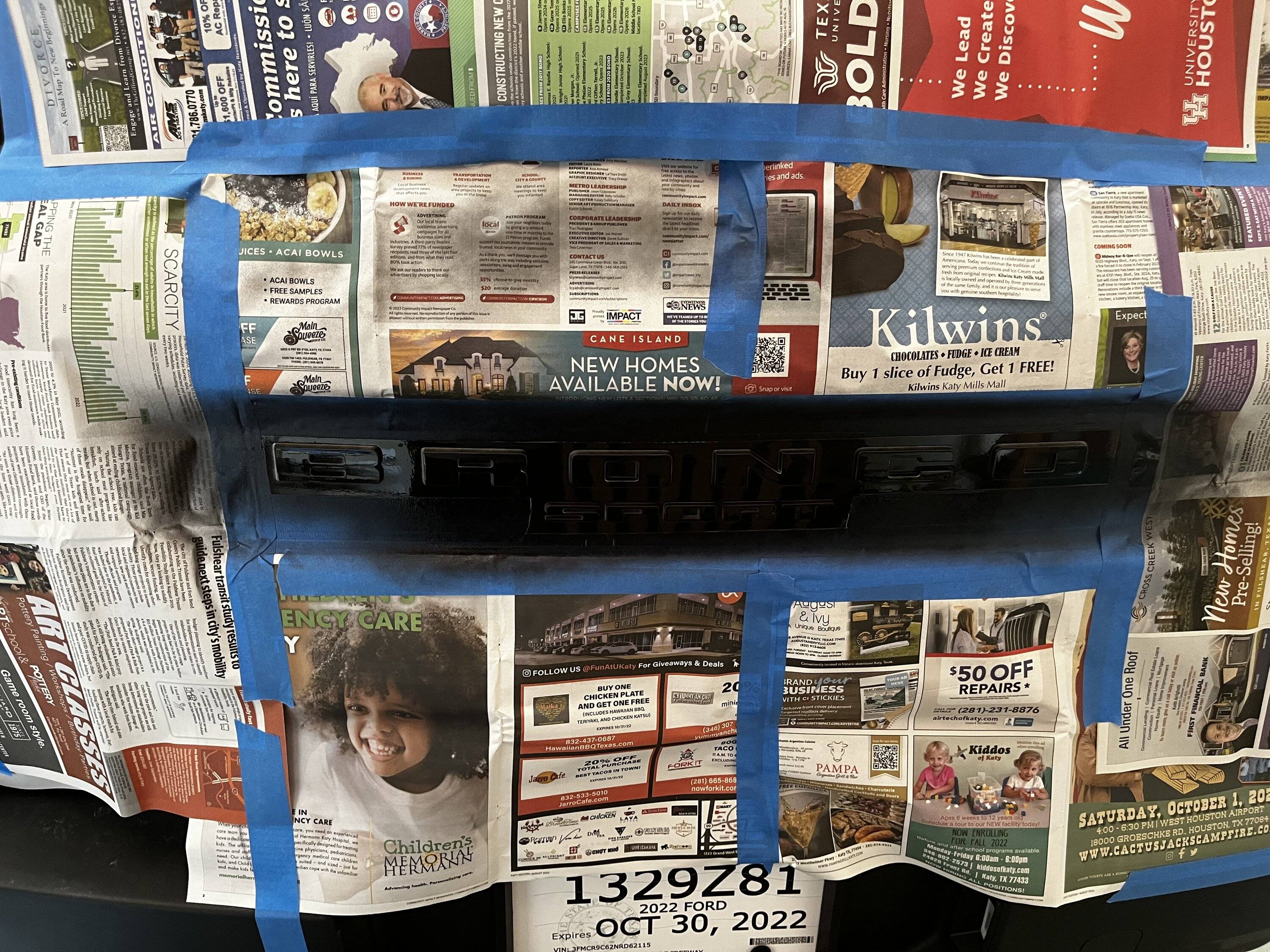

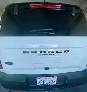

All done. Took about 2hrs bc I did 4 coats and waited 30mins between coats. I tried to video but I didn’t have it pointed right. Here’s a few before, during and after pics. Overall a very simple mod and impressed with the results all for $8 a can.
Ford Bronco Sport Installing new lettering on the tailgate of Bronco Sport - factory lettering? E00A0BEC-51C7-4AEE-A3D4-F702CE23E2FD
Ford Bronco Sport Installing new lettering on the tailgate of Bronco Sport - factory lettering? 2980CC53-FBE6-431D-82F8-57EC9CF29E82
Ford Bronco Sport Installing new lettering on the tailgate of Bronco Sport - factory lettering? FB8CA30F-22D5-43D9-AB0B-053C74122575
Ford Bronco Sport Installing new lettering on the tailgate of Bronco Sport - factory lettering? 7B956098-850A-494E-BD5E-AFD50FCF1E58
Ford Bronco Sport Installing new lettering on the tailgate of Bronco Sport - factory lettering? A8469E5E-9C2B-435D-A4C4-66040112A70A
Ford Bronco Sport Installing new lettering on the tailgate of Bronco Sport - factory lettering? 1EAD4D01-DF7C-42A4-977C-F6A7687002A6

Thanks. Yeah, This whole car is about contrast (black on white) so to me it makes it look much better. But the best thing of all is I can just peel it off later if I change my mind. :rockon:
