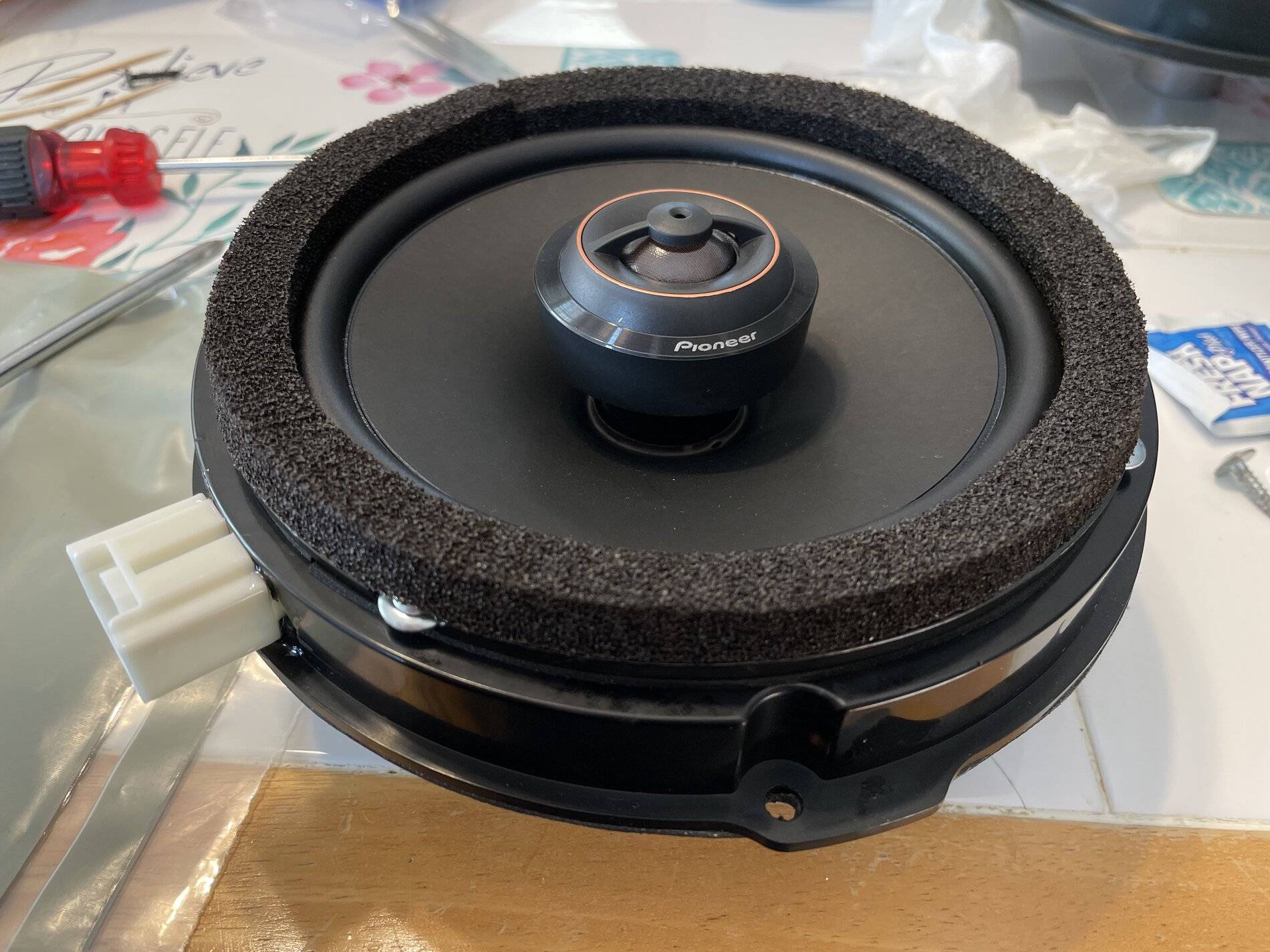

I picked up some Alpine 6.5 Type S's and honestly was disappointed with the mid bass. I worked at Best Buy as a car audio installer and I found it odd how hollow these sounded in the Bronco Sport.
I ended up trying Pioneer D series instead. The frequency response was so much better and the md bass sounds great.

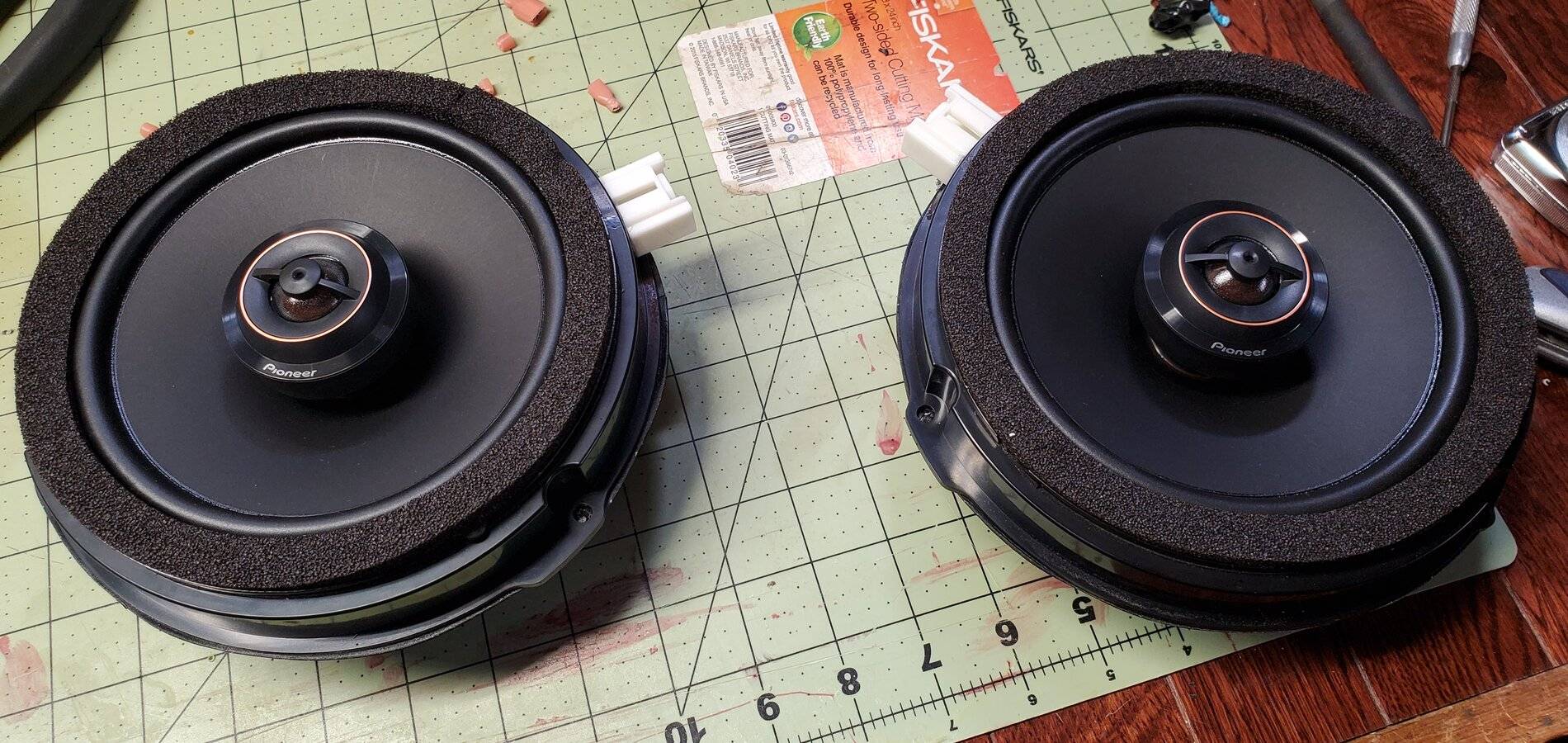

On HugeGuyTheory's advice, I put the Pioneer TS-D65Fs in the front and rears of my BB BS. All I can say is Wow. Originally I was debating putting a small sub under the seat because I didn't want one in the way anywhere. A sub is not needed with the Pioneers. They have lots of good bass unless you're looking to rattle windows with rap music.

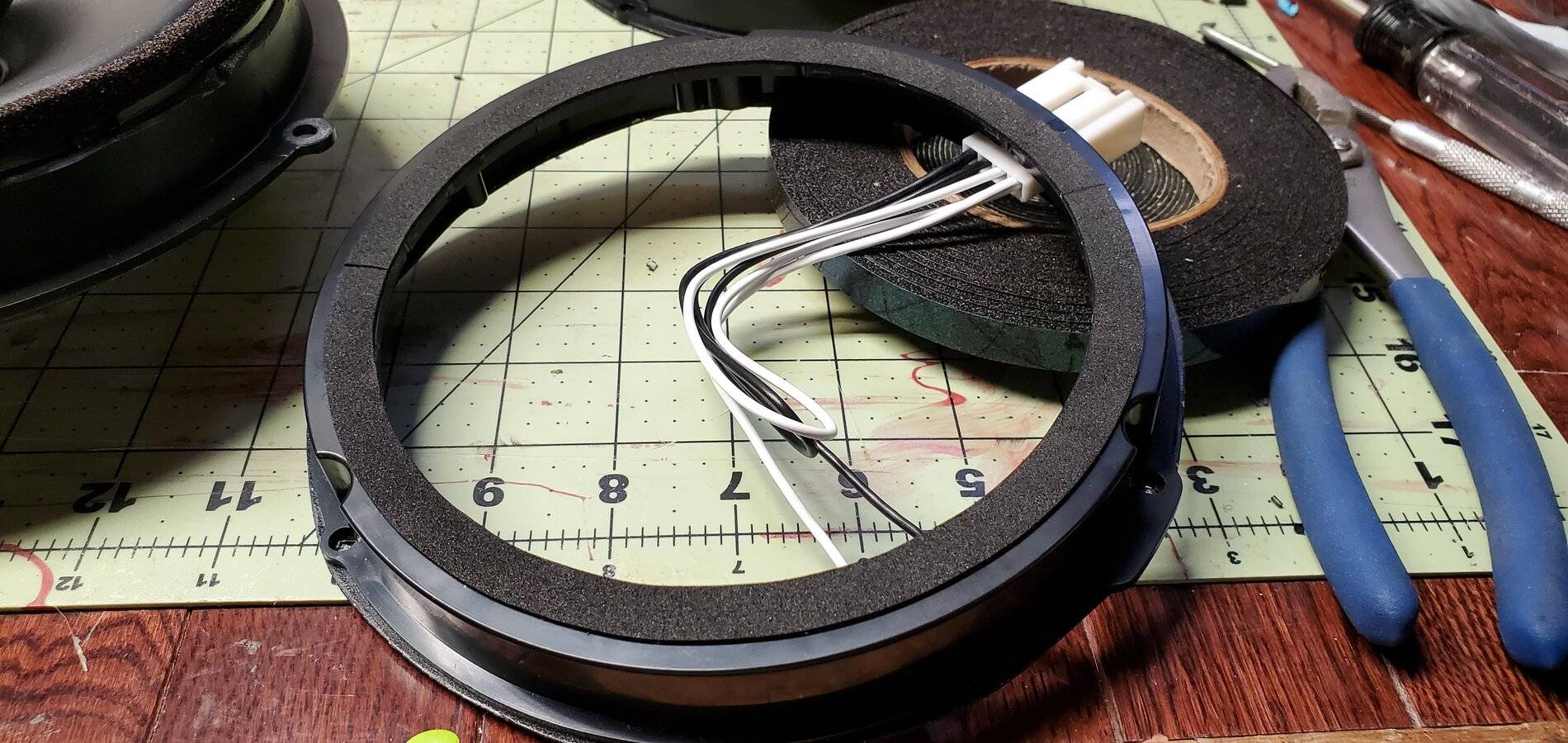

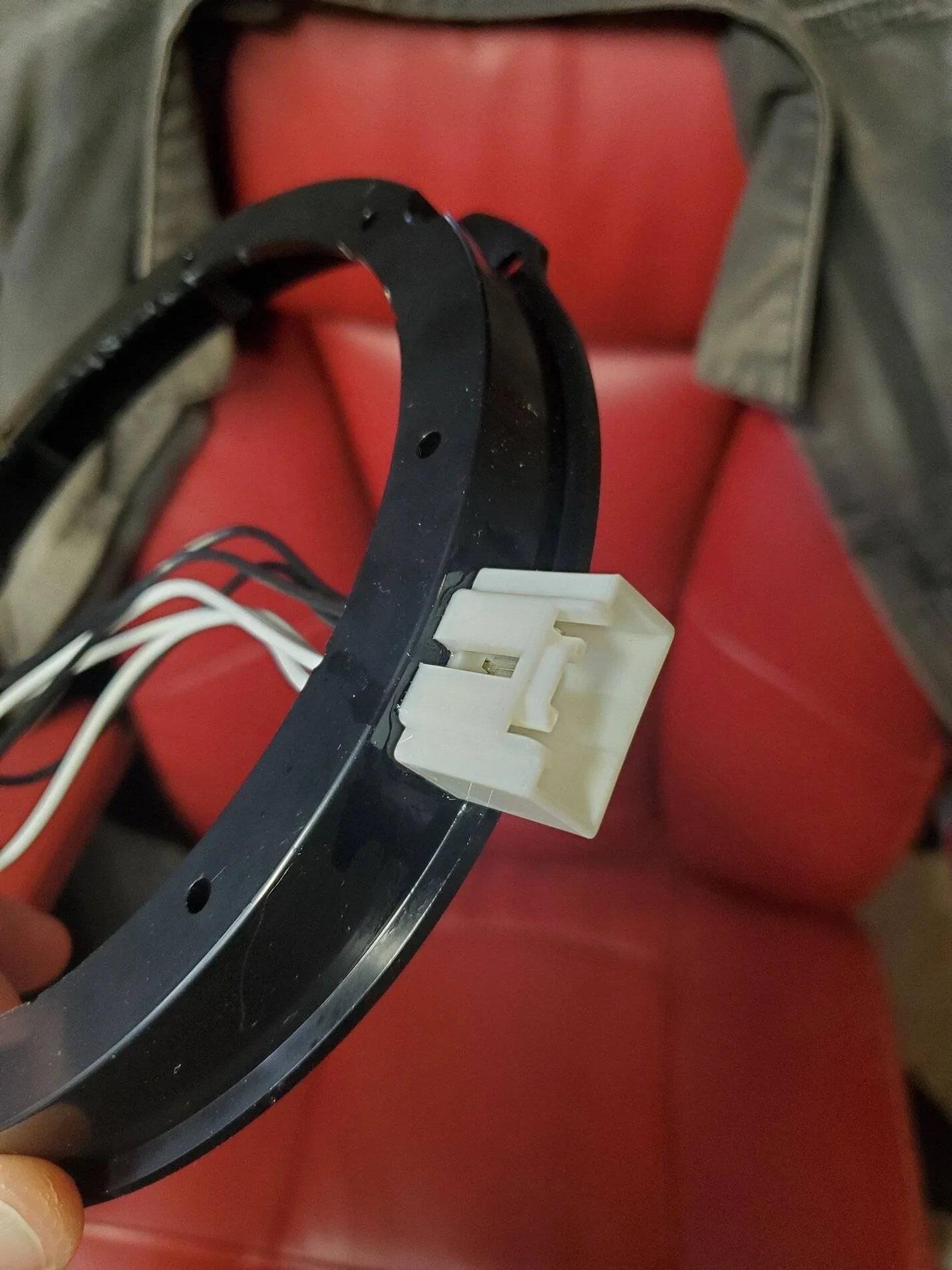

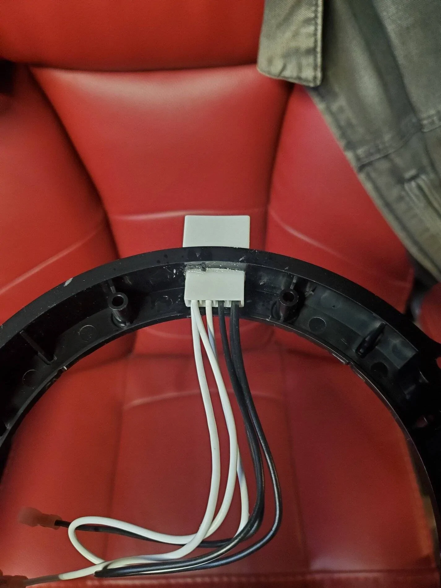

Also on HugeGuyTheory's advice, I used speaker seal tape and foam weatherstrip. In addition I mounted the wiring adapter plug into the speaker mounting adapter. Also another HugeGuyTheory idea. He sent me links to all these items that were needed. The guy knows his stuff, big thanks to him.

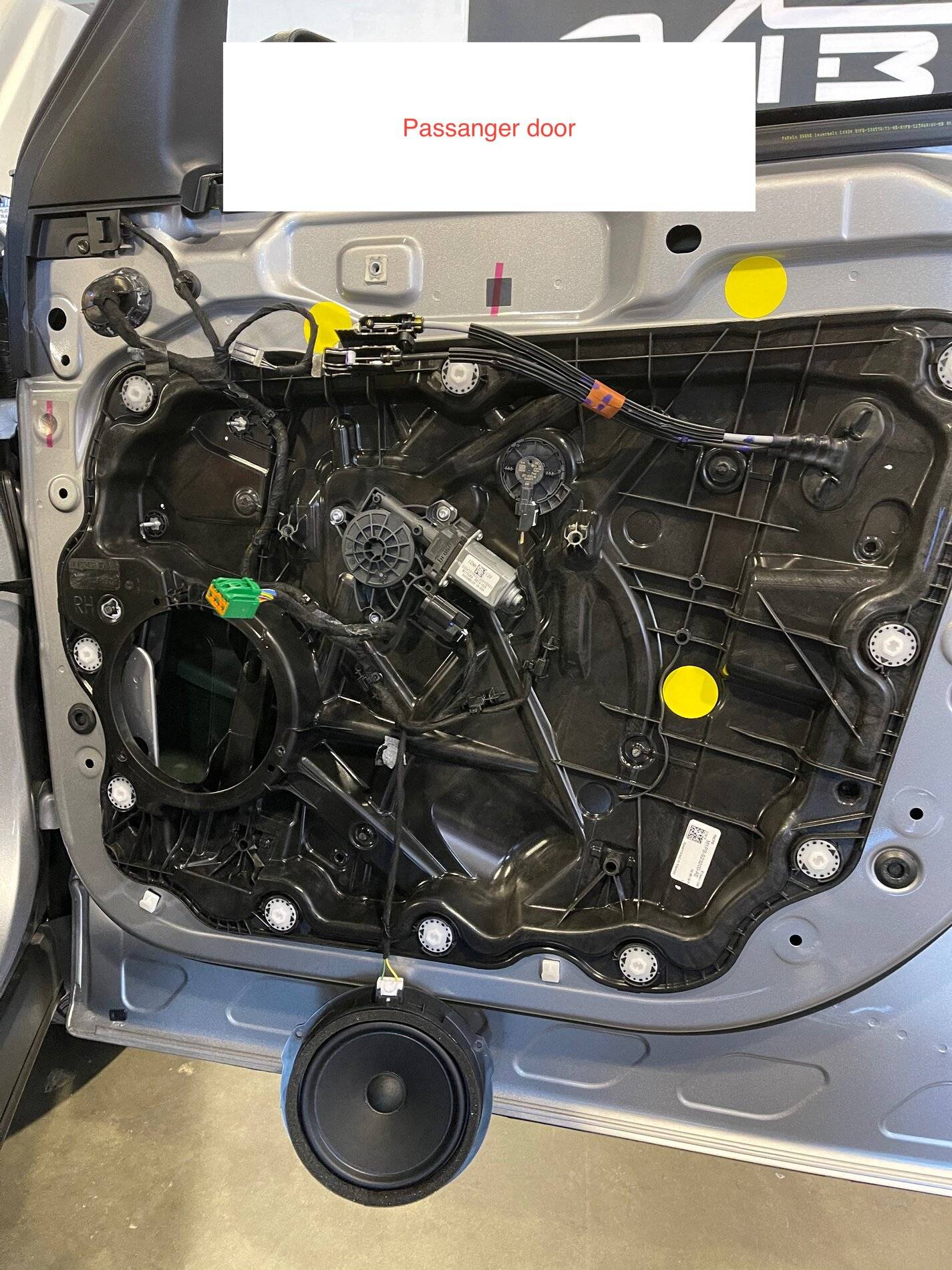

Unfortunately, there's not a lot of room to access the inner wall of the door (unless you remove the entire cover) to place the deadening material. As you can see from the photo of the OP, it's going to take some major surgery.

Pioneer TS-D65Fs. They are great. If you dig through the thread you'll find I posted links to the adapters and harnesses. There is also photos of how I mounted the harnesses by cutting a small hole in the adapters. I also used speaker foam and a sealer for a baffle. They sound amazing for not being amplified.
