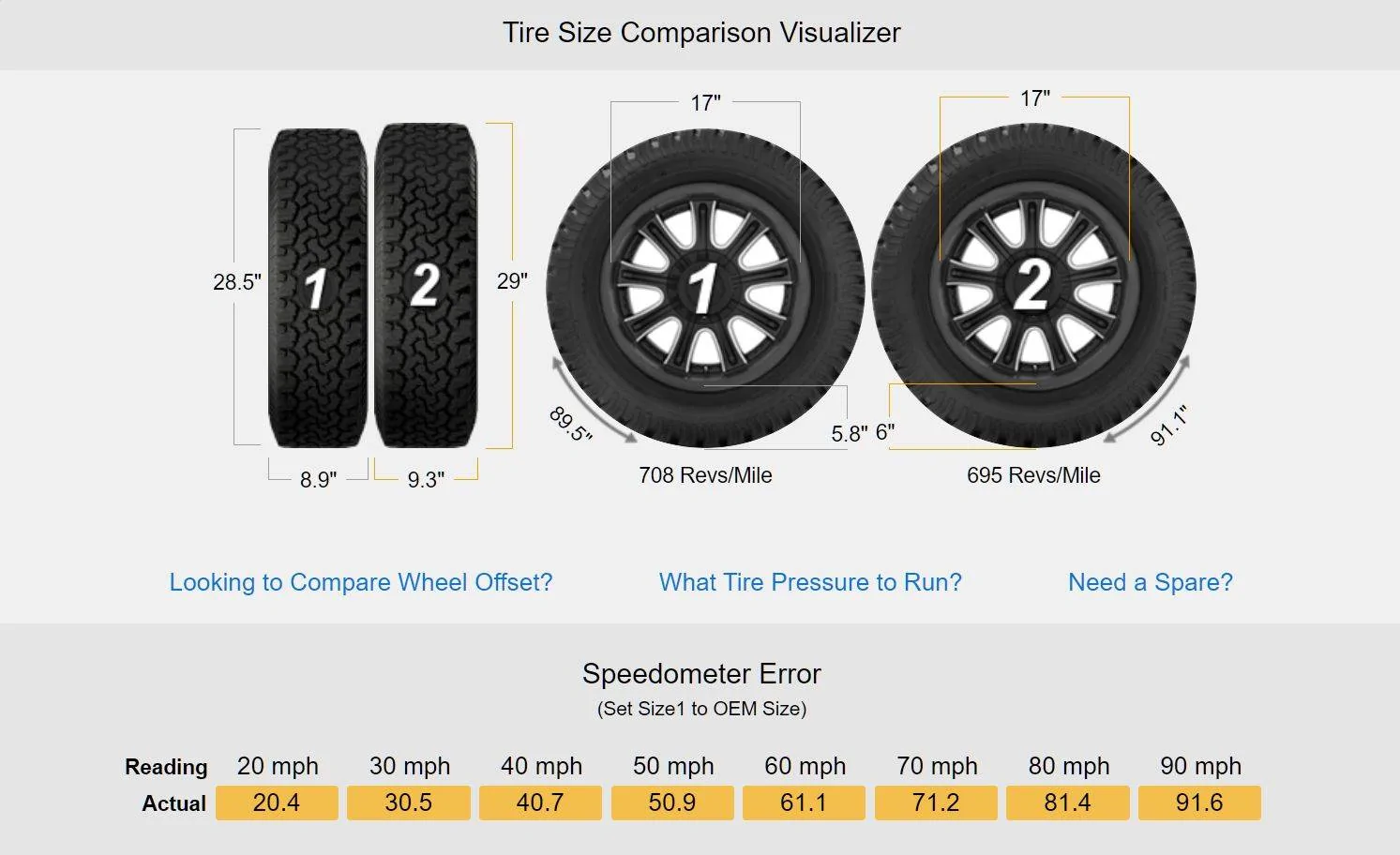

The speedometer got slightly off the faster I drove, comparing it to my GPS reading, going from the stock 225-65-17 to the 235-65-17 tires.
Your data comports with expectation according to the computer at tiresize.com.
Ford Bronco Sport Installed Falken Wildpeak 245/65/17s on the Badlands today -- no rub and ride great TireCompare

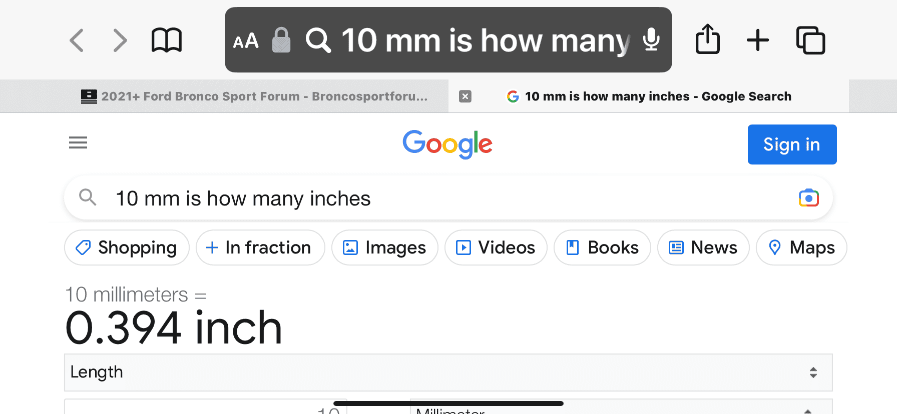

Actually it is .393701 inches or
Ford Bronco Sport Installed Falken Wildpeak 245/65/17s on the Badlands today -- no rub and ride great 6E5D2A4A-4B7E-4A8A-8E0D-AC0570C217D8
Metric tire measurements work differently, the first number is tread width, the second is the ratio of sidewall to tire width. so the difference between 235/65 and 245/65 is 65% of 245 - 235 which is 6.5 mm, which is .255 inches, so the math works.

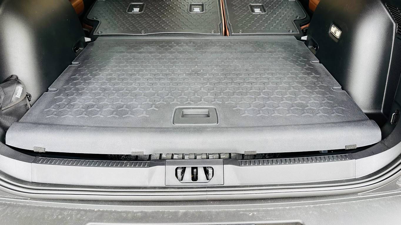

Falken Wildpeak 245/65/17s fits as spare tire, not need to remove any paddings.
But the lid doesn't stay flat. Airing it down helped a bit, but still not perfect.
Ford Bronco Sport Installed Falken Wildpeak 245/65/17s on the Badlands today -- no rub and ride great IMG_2437
I dunno, I kinda like that tire peeking out at you, as if to say, "Hey, why don't you put me on for a while?" :bandit:
If you take the padding out it will drop down so you can lay the lid flat.

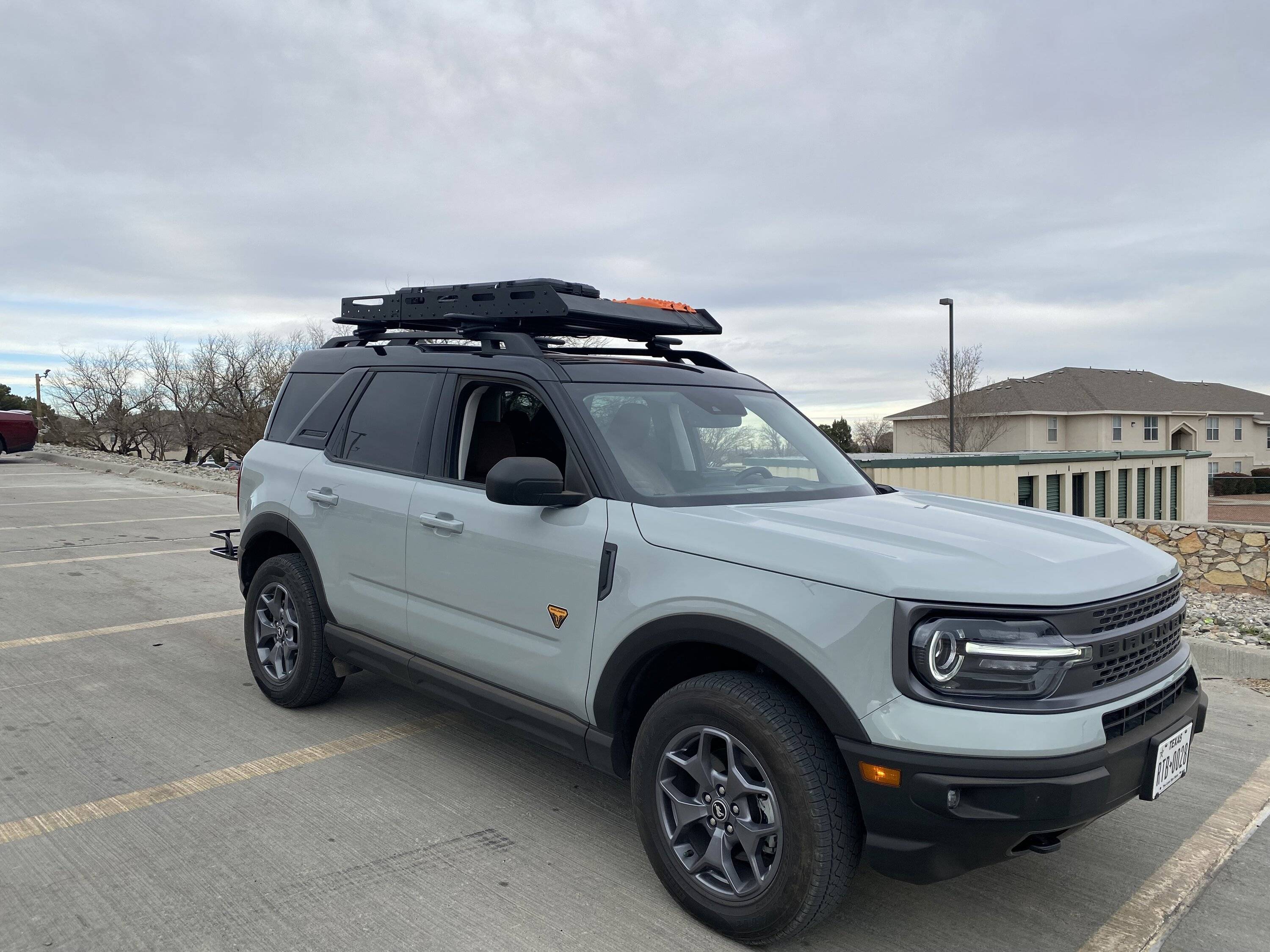

This is the route I'm thinking of taking in Brand and Sizing... with those 245'x65x17s... I just do not want to contend with a lift kit if possible... so question?
Is yours a STOCK BL's ? I know others say yes... but I do a lot of off roading with mine and its dinky stock Perilli 225x65x17's.... ugh. I guess I shouldn't be too hard on them... they have pulled me through some off road trails... but always 'icy"...
However, as soon as they wear down she more replacing with a better AT tire.
Ford Bronco Sport Installed Falken Wildpeak 245/65/17s on the Badlands today -- no rub and ride great IMG_8323
I am in the same boat, looking forward to the 245's!

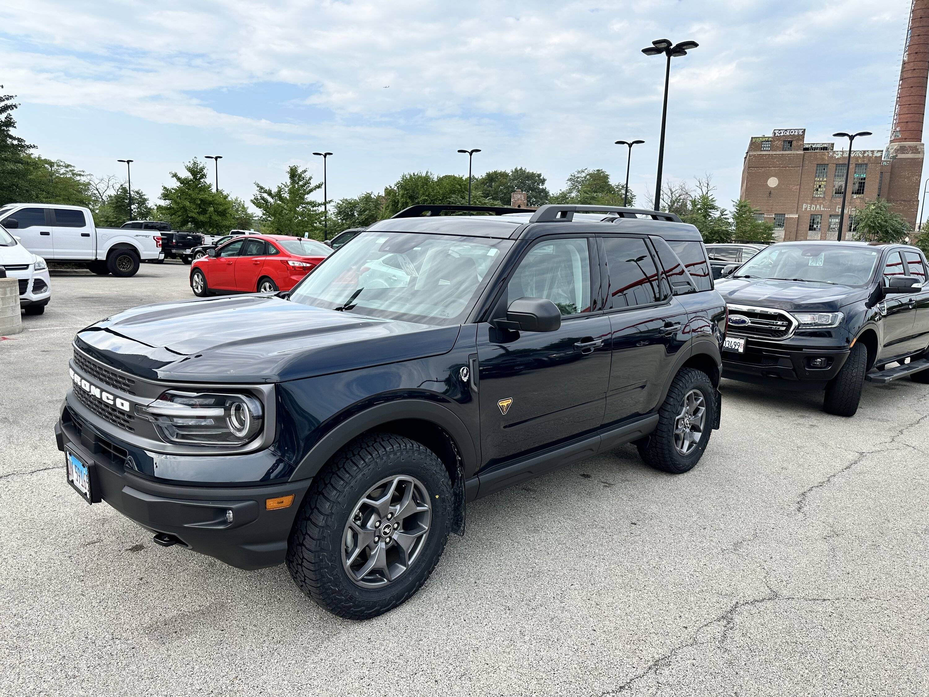

245/65/17s added. They look great and cannot wait for my road-trip next week
Ford Bronco Sport Installed Falken Wildpeak 245/65/17s on the Badlands today -- no rub and ride great IMG_5338
