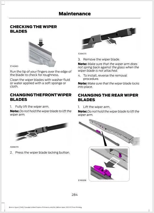

SSM 50200 - 2021 Bronco Sport, 2022 Maverick - Front Wiper Arm(s) Or Wiper Blade(s) Replacement Service Procedure Tips On 2021 Bronco Sport and 2022 Maverick vehicles, when replacing wiper blades or wiper arms, damage to the wiper motors may occur if the following steps are not followed prior to using the Workshop Manual (WSM) procedure in Section 501-16. To remove the wiper blades: 1. Place ignition key in accessory position (vehicles with keys) or key inside the vehicle (vehicles with intelligent access), press the Start-Stop button without applying the brake pedal. 2. Activate the wipers using the stalk switch. Do not manually rotate the wiper arms and blades. Damage to the wiper motor may occur. 3. When the wipers are at mid travel, move the key to the off position (units with keys) or press the Start-Stop button again to leave the wipers in a service position. Service the wiper blades once the wiper arms are at the mid travel position using the procedure in the Owner's Manual.
By the way, this is a total cop-out. If this is an important step, then it should be IN the owner's guide. It is not. Here is the detail presented in the guide for changing the wiper.
