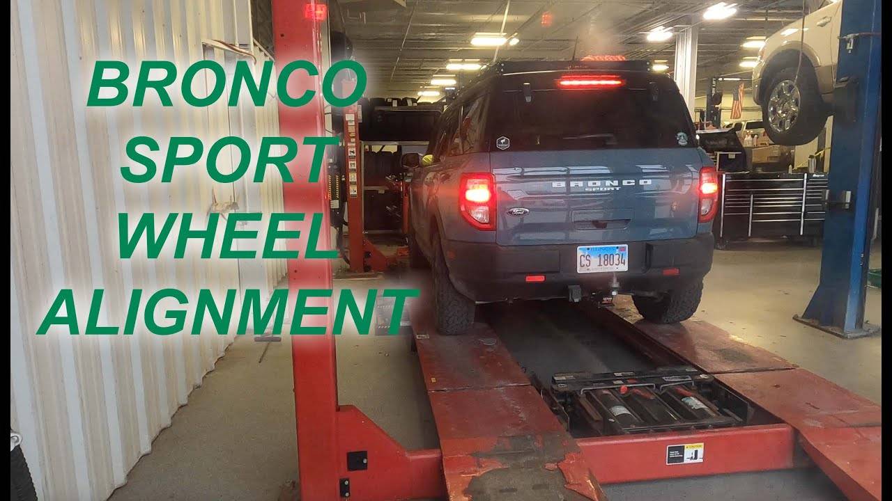

Did you use the camber bolts? I purchased them but will probably take them to the alignment shop if they are needed
Yes we used the Bolts. Once the tires get in we are getting a 4 wheel alignment and getting the spacers and tires installed.

How and where do the bolts install? Are the bolts necessary after getting an alignment, or would they be required first to even get an alignment after installing the lift? I've seen that they are an accessory with the HRG lift but am wondering how critical they are.

They are cammed bolts installed in the strut mount to allow camber adjustment. Camber is the vertical angle of the wheel/tire, i.e. top tilted inward or outward. I've not heard anyone mention the need for a camber adjustment following the installation of a lift kit, but if you take it for an alignment and the shop cannot get the camber adjustment within spec then you'll need the camber bolts.

Thanks for the information. I knew they were for camber adjustment, but I had never heard of using special bolts to do it. I also wasn't sure where they would even be installed to help in making the adjustment.

This video explains how they work.

So just got back from my alignment. Went to Firestone because of the life time alignment but they did not have the software for the bronco sport. So ended up at ford quick lane and indeed the camber bolts are need to get it aligned.

There you go. Frankly, I was surprised anyone was able to lift one of these cars without inducing a change in camber.

Did you use camber bolts?
Yes the front we used the camber bolts. the rear has 2 adjustable bolts simliar to the camber bolts to get the wheels aligned.

Are these factory or did you purchase them? My front camber is fine but the rear is so bad it has destroyed my new BFGs.

I've had the same thing happen. When I had it aligned after the lift they told me they didn't have specs on the vehicle yet but they could do it. They did a good job on my ST so I trusted them. 15k miles later my rear tires have worn on the outer edge bad. Front is fine. Don't think they adjusted the back at all, it wore exactly how you would expect with a small lift.
