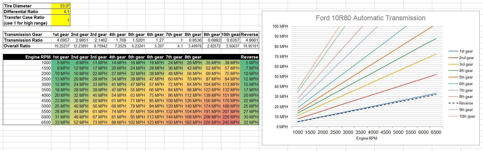

Some of the ratio distribution seems uneven for the 10R80. Do you imagine that would be more even for the 10R140? Something would presumably shift toward the lower end.
Ford Bronco Sport HP and torque specs new 6.7 powerstroke Ford 10R80 base

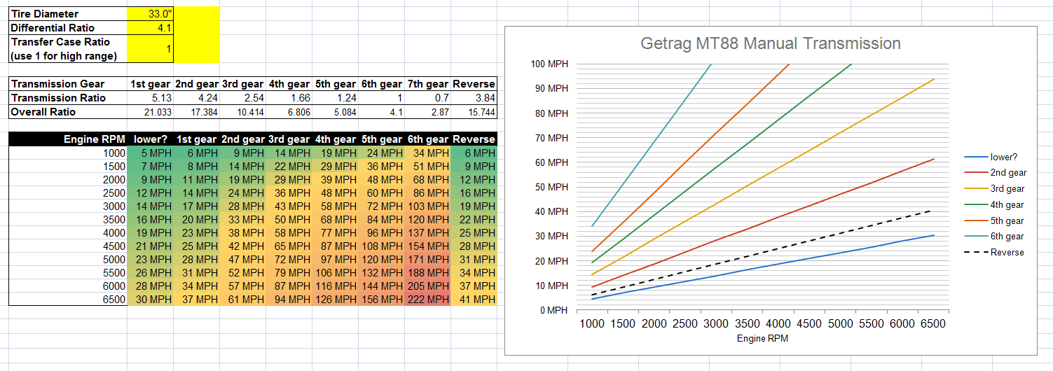

eta: for giggles here's a 7sp manual getrag MT88 ...
Ford Bronco Sport HP and torque specs new 6.7 powerstroke MT88 7sp Manual Hypothetical

I think dieselhub has all the ratios for all the transmissions in the "big three" trucks the last couple decades

I don't think the 10R140 is a known quantity yet. The 2020 superduty and its 10speed are still listed as a future vehicle.

True, but you can reference GM's HD 10 speed for a good benchmark. These are very similar architectures, obviously each OEM is handling their own manufacturing and calibration but the core design is shared. I wouldn't be surprised if they tweaked the ratios a bit, but overall they should be very similar.

Hmm, the little I can find would suggest the low gears are getting taller. I suppose if you're expecting to put 1000+lbft of torque behind it you don't need to try so hard with the gearing. It would also be less necessary to electronically torque limit the low end so you don't peel out every time you took off.
