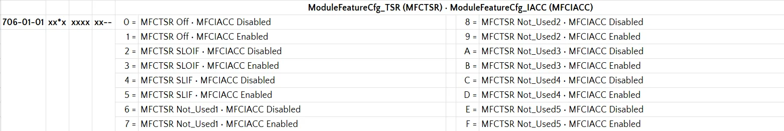

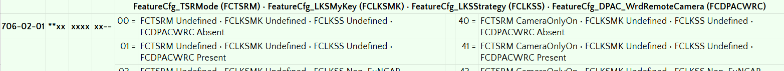

I tried this earlier today on my 26 BSBB and ForScan didn't have ez mode for my IPMA. I checked the spreadsheet for the 26 Maverick and found 2 addresses that look promising. For the first address I've got a 0 and the second I have 2A.
Could anyone with TSR or someone who has enabled it with EZ mode check what their values are and report back please? I plan on testing it as well tomorrow but I'd like to know for sure before messing something up.

i can probably take a look this evening...
Alright Thank You! I'm about to test it out, I'll report back after if anything changes/works.
Update: It does show a limit sign on my speedometer now. Nothing in the driver assistance menu though. I can't test it until later though. I don't believe I have the tech package but I do have Copilot.
sounds like you have the core function working. overall the menu options are controlled by the APIM edits, so be sure you do that if you want them (it's not required tho from what i recall). FWIW i have the "Menu - Speed Limit" and "Chime for Speed Limit Change" turned on but neither work.
for reference my IPMA (706) values:
Ford Bronco Sport How to enable Traffic Sign Recognition and Speed Sign Recognition in 2025 BS Badlands? 1783394779266-14
Yup same values I changed mine to. I enabled all of the changes you listed as well. After a few starts the menu finally showed up. It has worked fairly reliably and well so far. It misses a sign here and there but it sees most. The speed alert works for me but the chime doesn’t.

excellent, glad it worked, happy to help.
I'll go in and see what i had the tolerance set for on the speed warning - maybe i just didn't have it set right and that's why i thought it didn't work...
I’m not sure what the tolerance was set at on mine but if I did a 1/4 mile over the speed limit it was flash at me. And again thank you lots 🙏!
