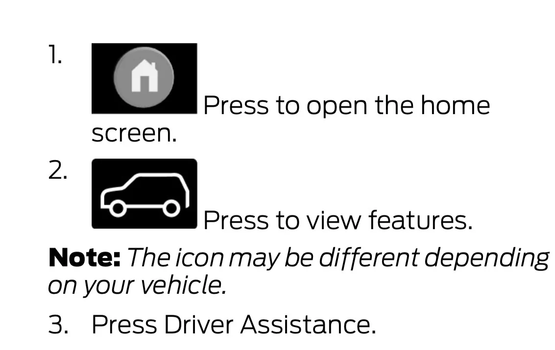

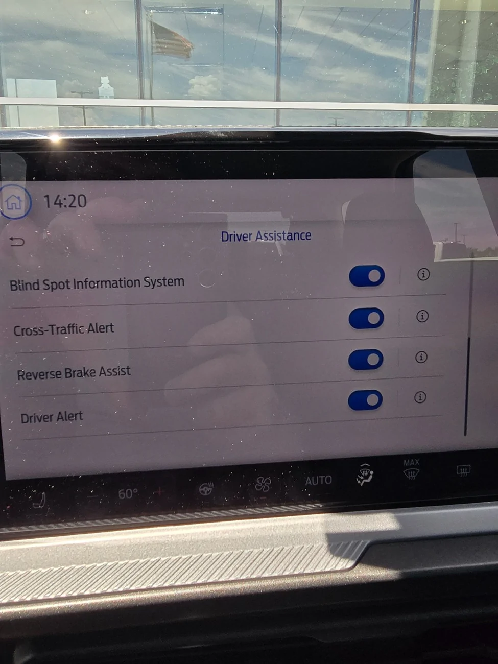

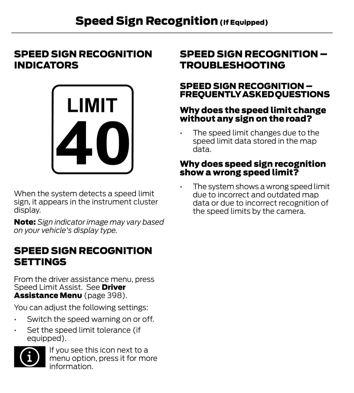

I recently purchased a 2025 BS Badlands. I understand Speed Sign Recognition and Speed Limit Assist should be included with this package. The online owner's manual for my vehicle indicates they should be under the Driver Assistance Menu but, I have not been able to find them there.
Could someone tell me if it is hidden elsewhere and how to enable the alerts? (I can't afford any more speeding tickets!)

might be under the cruise control menu...then you would want to activate the intelligent mode to be able to set the tolerances for the speed limit recognition

No, from everything I can find itsounds like it SHOULD be included in the Badlands even without the tech package.

Thanks! My Badlads has the Co-Pilot360 Assist 2.0 package but, Settings > Driver Assistance > Cruise Control does not include an option for Intelligent.

Thank you! I love the adaptive cruise control feature. Unfortunately, I can't find anything about Intelligent Active Cruise Control or Speed Sign Recognition in the Driver Assistance screens, even though it is listed in my owner's manual.
