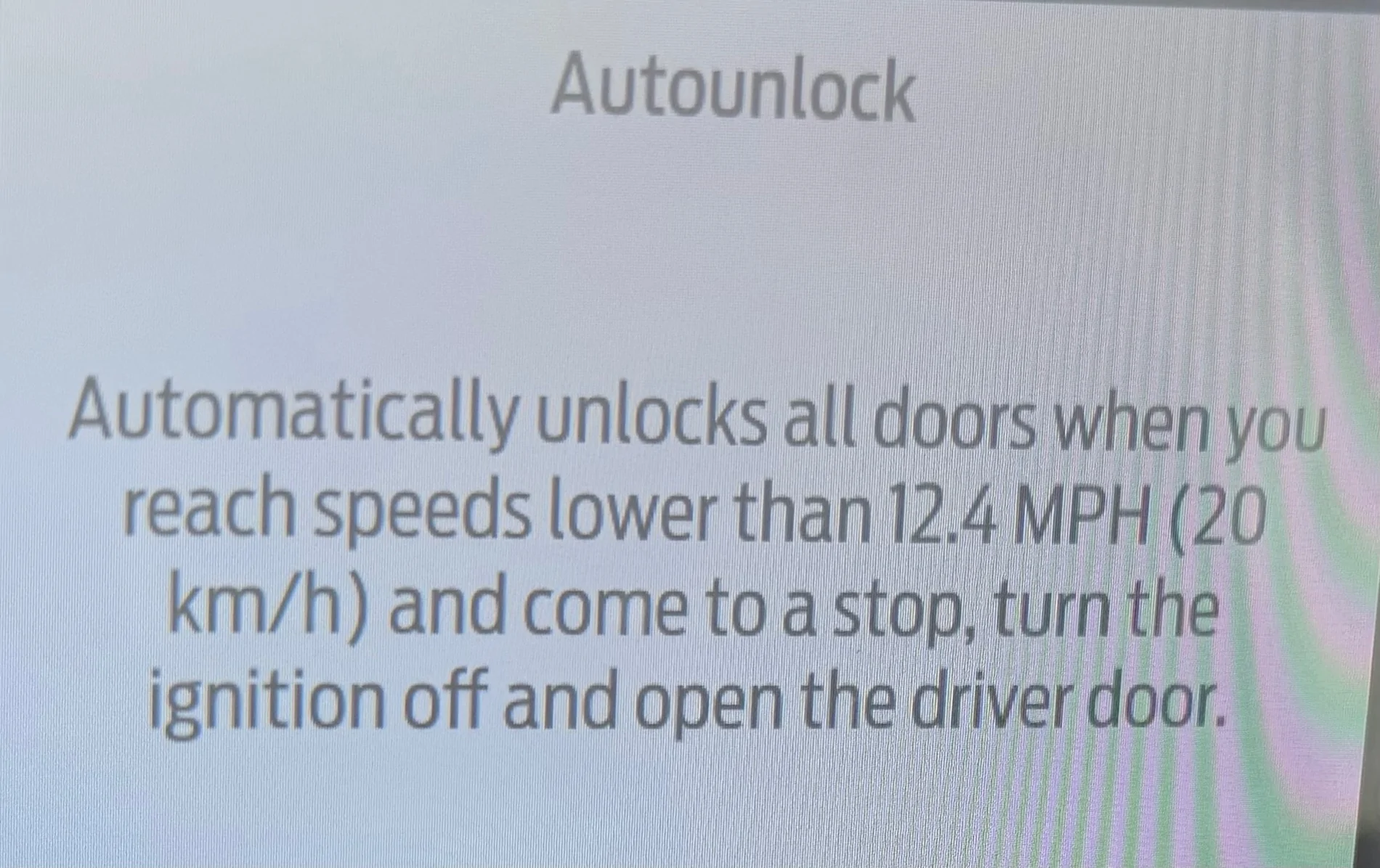

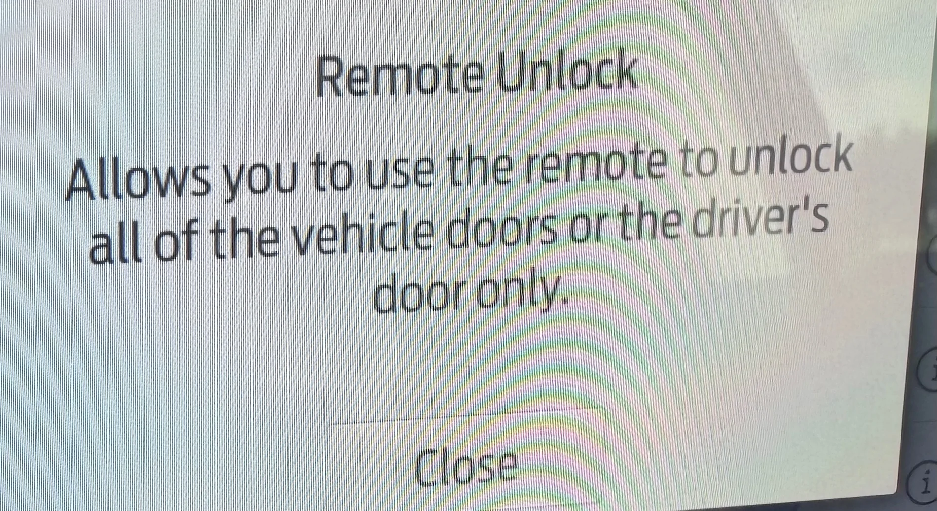

There is a setting on ‘21-‘24 models to “Automatically unlocks all doors when you reach speeds lower than 12.4 MPH (20 km/h) and come to a stop, turn the ignition off and open the driver door.”
On the 2025 look for settings similar to these:
Ford Bronco Sport How to disconnect driver's side manual push/pull door lock? IMG_9019
Ford Bronco Sport How to disconnect driver's side manual push/pull door lock? IMG_9018

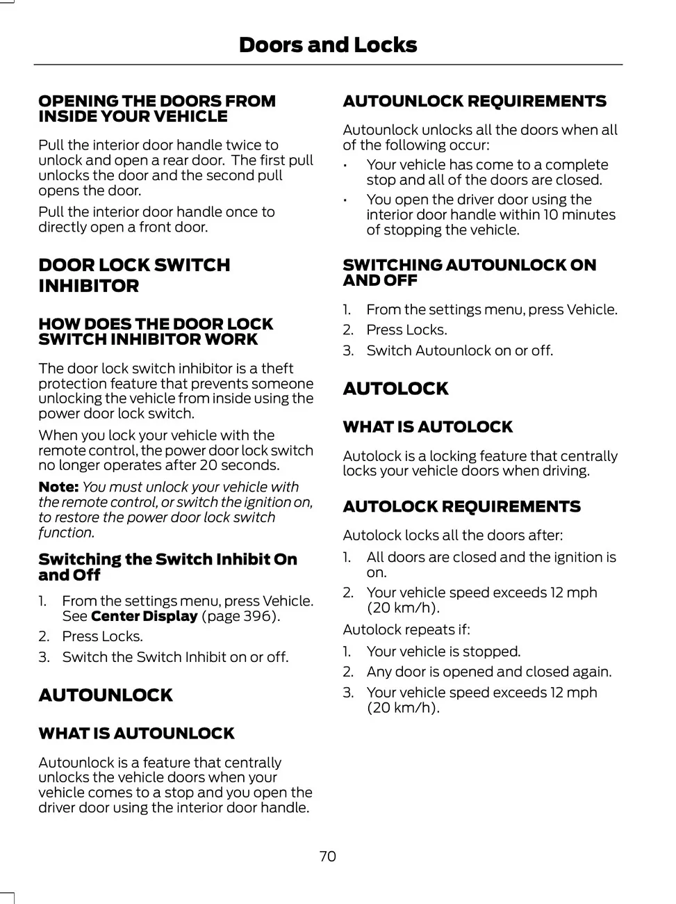

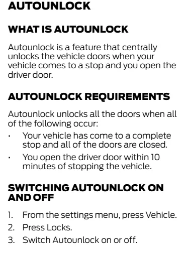

Please refer to this page from the owner’s manual.
Ford Bronco Sport How to disconnect driver's side manual push/pull door lock? IMG_0409

Thank you for the suggestion. When I saw the Auto Unlock in the owner's manual I thought "who would ever want to do this". In hindsight it now makes a lot of sense, since when my daughter presses the exterior lock, with the lines, it would re-lock all the doors.
I'm a little hard headed, so I would like to thank you and all of the other people who offered suggestions for all your advice and patience!!!

Auto Unlock seems to be the best option for my daughter, at this time.
