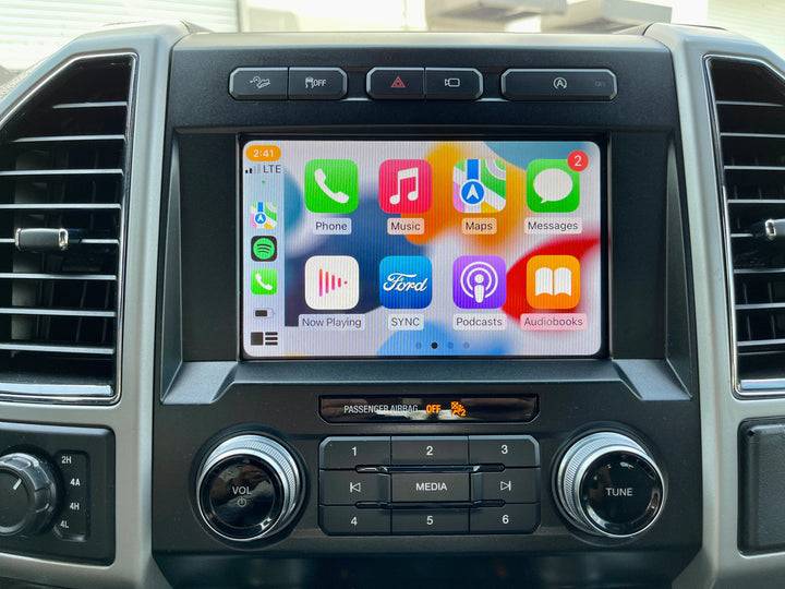

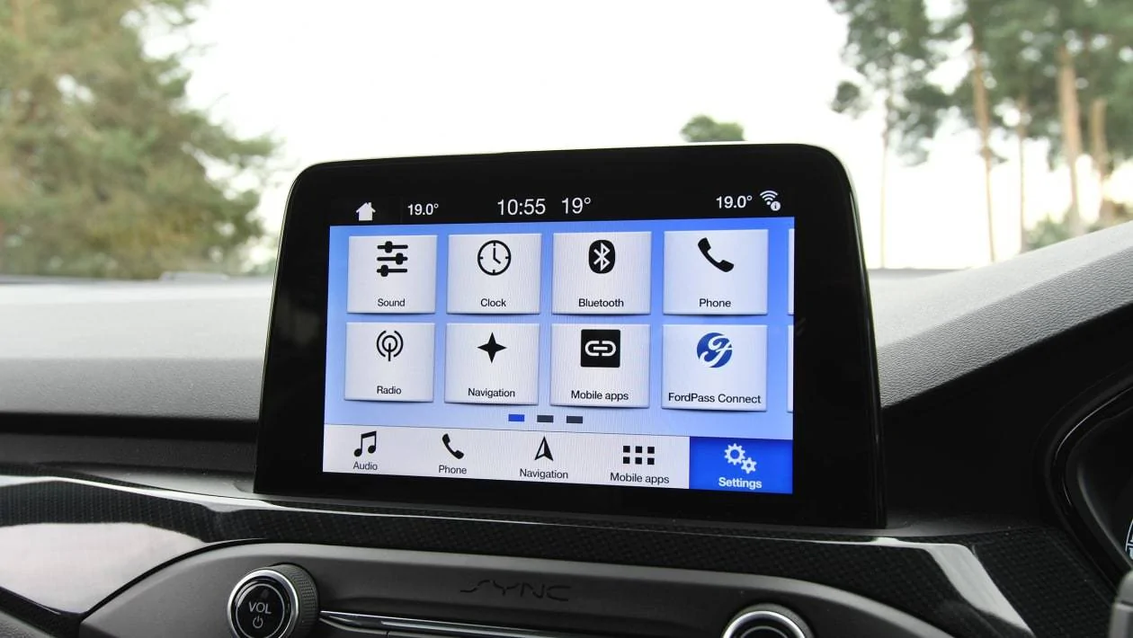

SYNC works the same with Apple CarPlay; it sends all voice commands to Apple instead of to the SYNC system. Depending on how the phone is configured, Apple CarPlay will activate automatically when you plug the phone in. The screen in the car will reconfigure to CarPlay rather than displaying the SYNC screen.
This is how the screen looks running SYNC:
Ford Bronco Sport How many apps have you had to download to utilize Ford Apple Carplay or Android Auto? dsc_2754
This is what it looks like running Apple CarPlay:
Ford Bronco Sport How many apps have you had to download to utilize Ford Apple Carplay or Android Auto? IMG_5028_720x
You cannot access SYNC commands with CarPlay running. If you want to switch to Sirius XM you must exit to SYNC by touching the Ford button. Once there, you can use SYNC voice commands to turn on Sirius, or use the screen interface.
Alternatively, there is an app you can load on your phone to access Sirius XM from CarPlay. You can read about it here.

I owe you a beer or beverage of choice should we ever meet.
I worked in the phone business for 39 years when it was electro mechanical, then digital, then VoIP, and now cellular. It's all apps/SW now. I figured it was an app, if the phone was plugged in.
