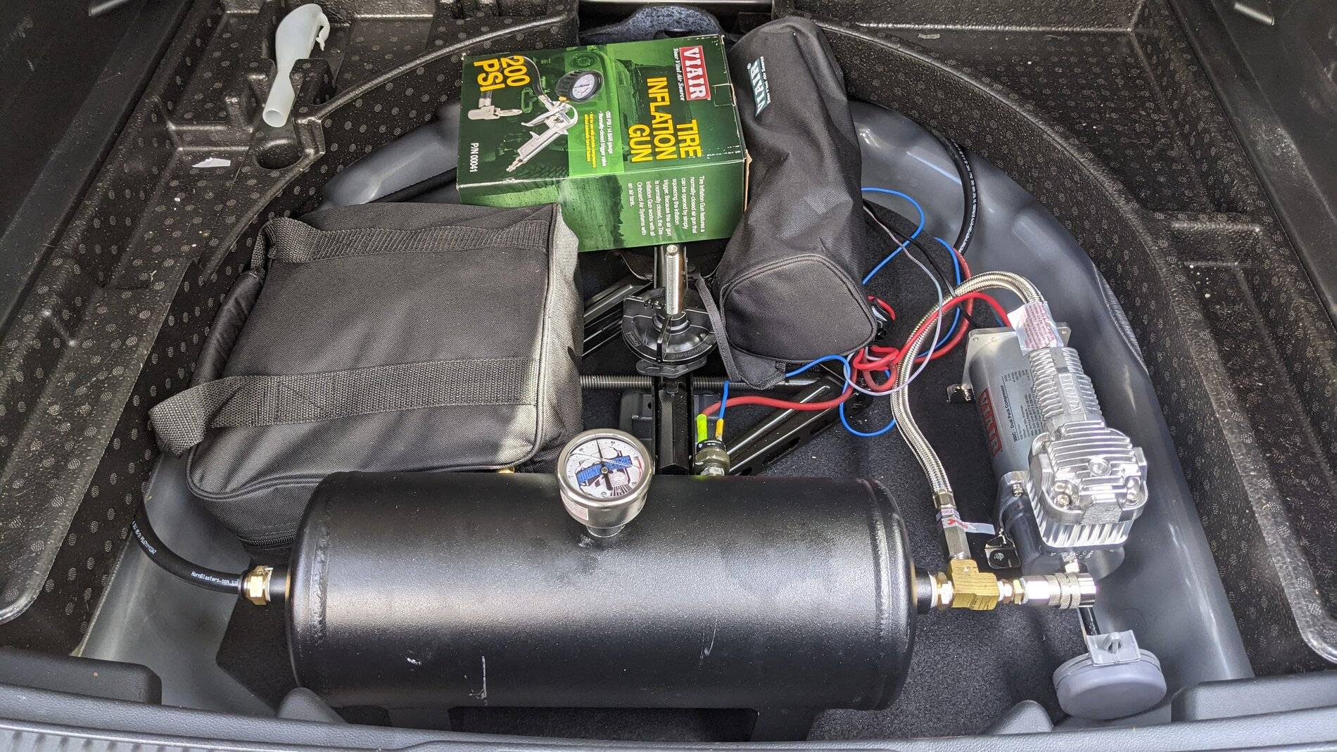

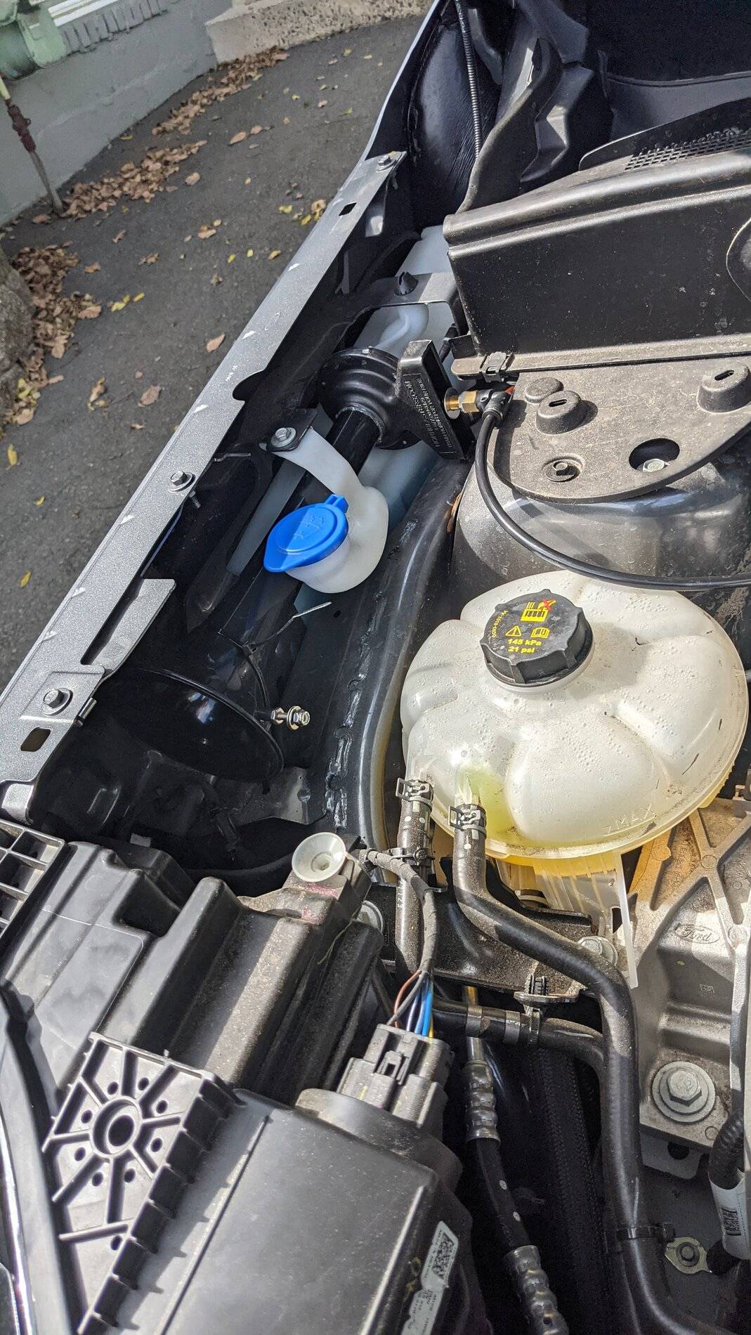

Horn Blaster Train horns with air hose adapter. Tank and compressor installed in spare tire area. Air line and wiring thru the pillars up and in split horns to each side. I wire tapped the main horn so it goes off even for the alarm.
Ford Bronco Sport Horn Replacement PXL_20210921_180832815
Ford Bronco Sport Horn Replacement PXL_20210921_181323204
Ford Bronco Sport Horn Replacement PXL_20210921_181326051

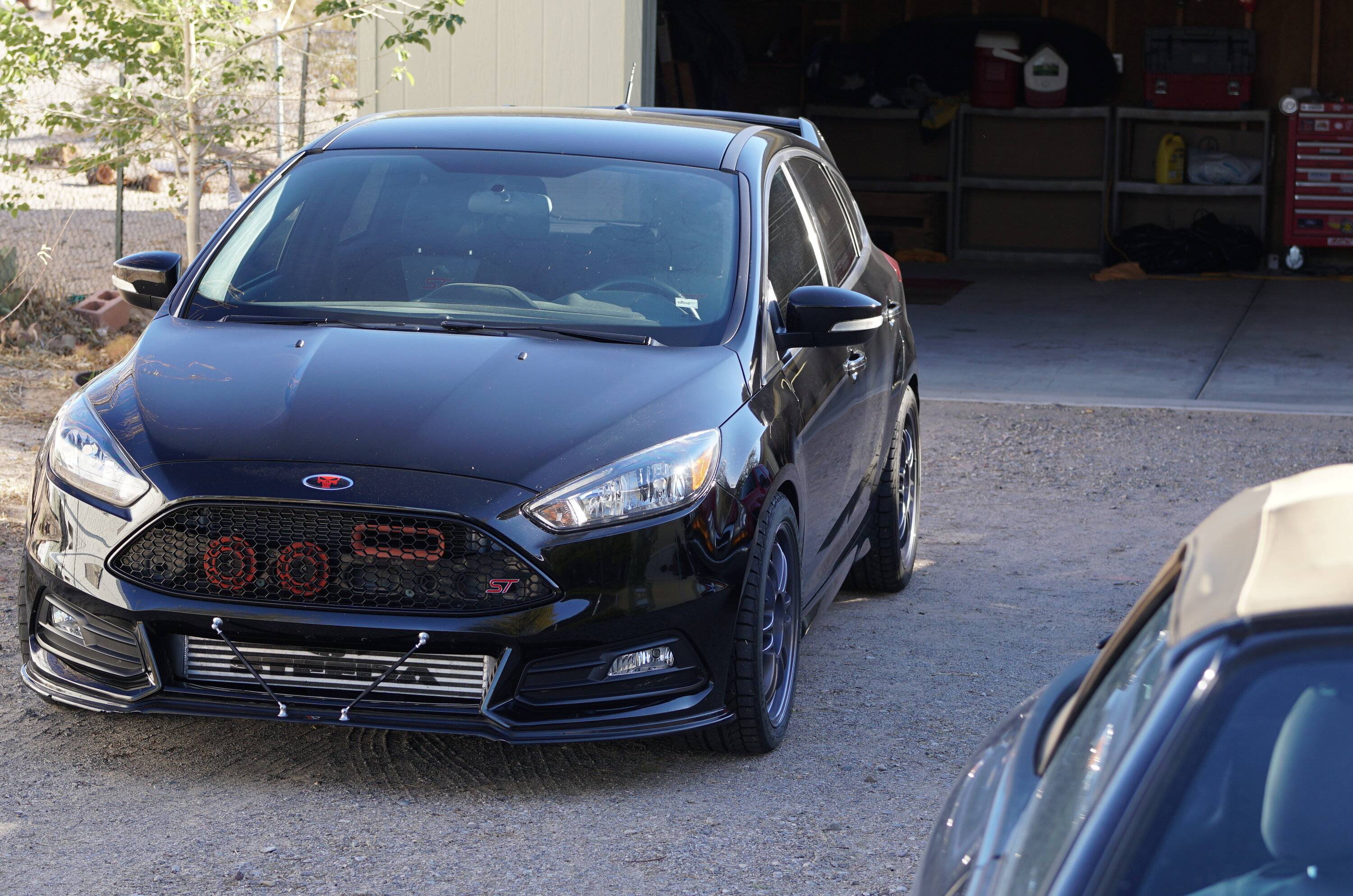

I always like Hella horns. I just wire directly to factory wiring, but I believe using the relay may make them louder. I haven't put any on the bronco. They make different styles and sounds. Supertones on my ST.
