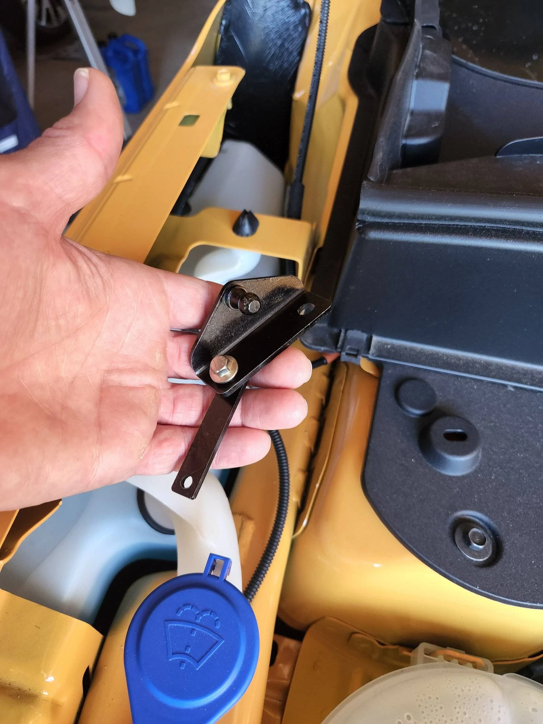

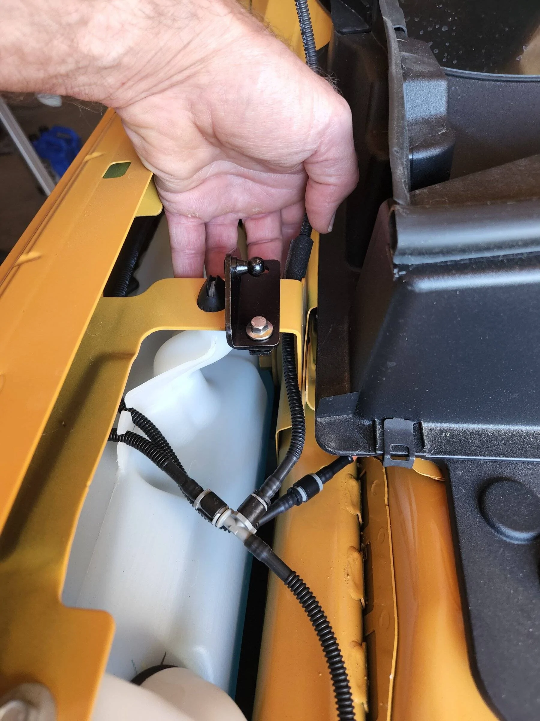

They appear to be decent quality, but only time will tell. They came with the wrong instructions, but it wouldn't have really mattered because it was such a bad quality photocopy they wouldn't have helped anyway. Luckily, it's a really simple product, so after a bit of noodling even I was able to figure out how to attach them. Here's what I did:
NOTE: Don't tighten anything more than finger tight until ALL the mounting assemblies are in place.
The mounts that attach to the hood are self explanatory. The mounts that attach to the bottom of the strut are two-piece assemblies. The photo below left shows the part of the assembly with the ball you snap the strut to, and the mounting position on the fender support for the left (driver's) side. The photo below right shows the two bolts and the threaded plate they screw into. Once tightened, the bolts pinch the fender support between the top and bottom pieces. Nifty!

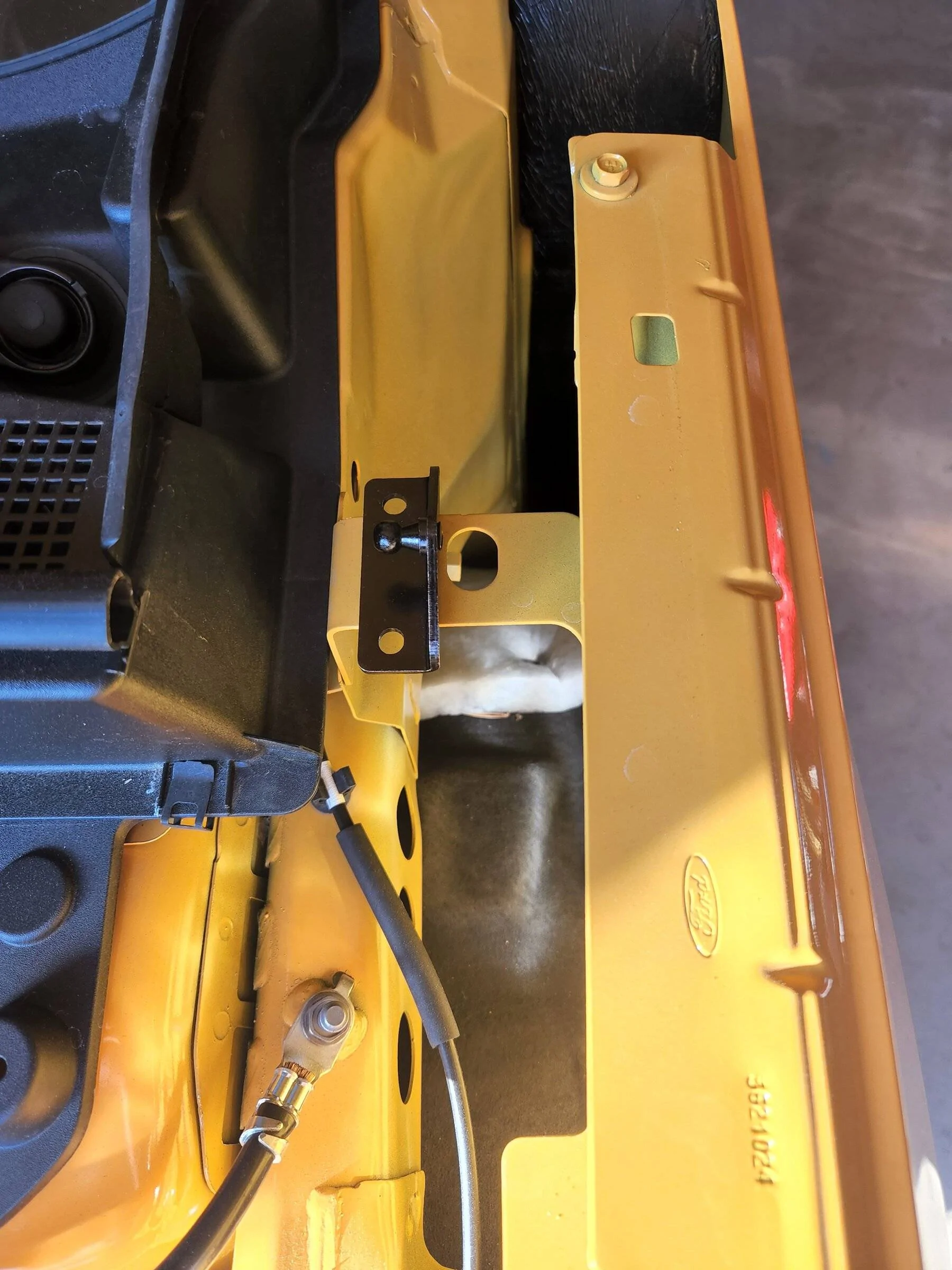

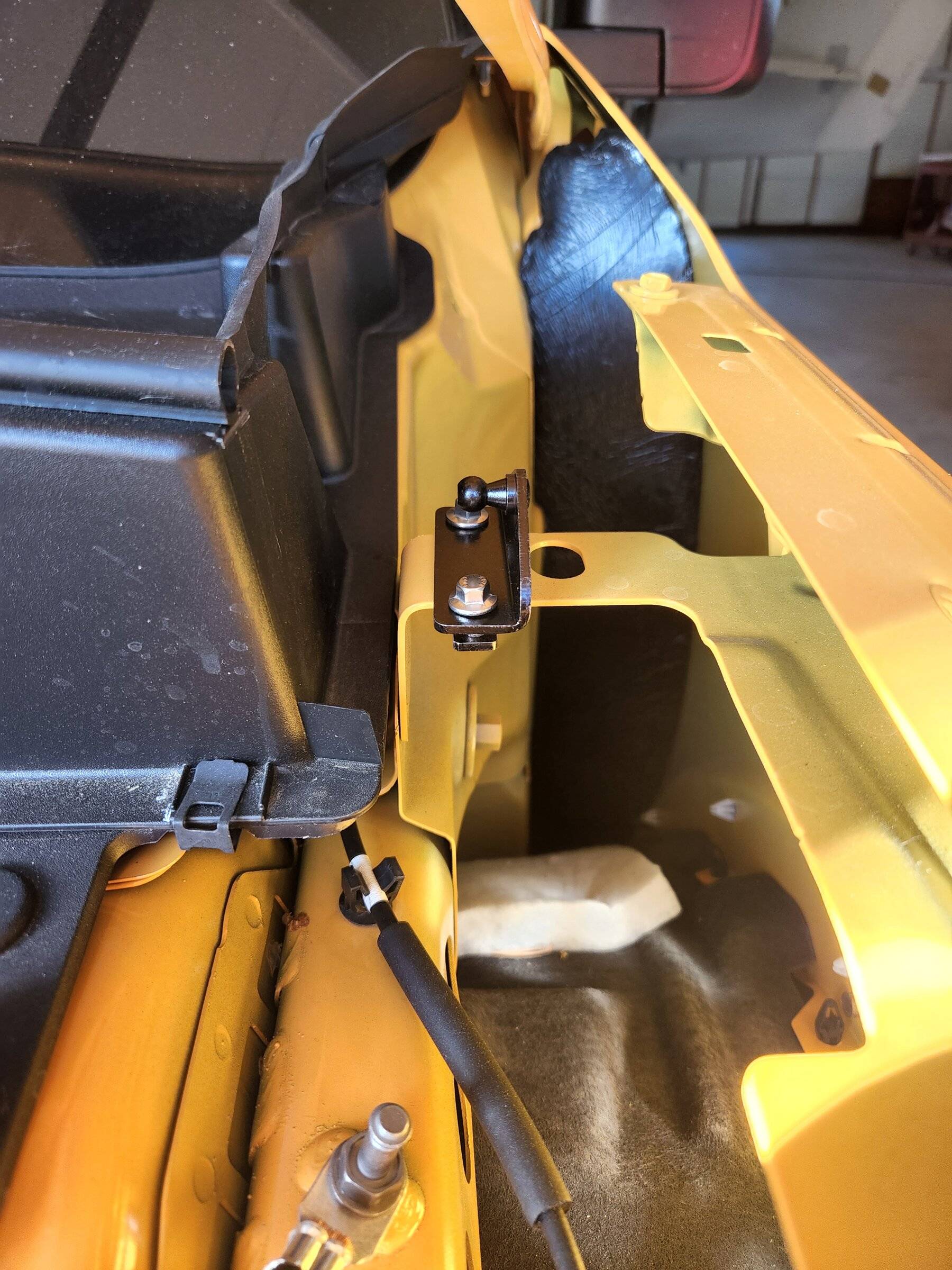

Recommendation: Don't try to hold the two pieces in position while threading a bolt into the bottom plate. It would be very easy to drop something, and who knows where it might end up. Instead, thread the bolt that goes in the front hole into the bottom plate a few turns, THEN place the assembly in position. The front bolt will assist in holding the assembly together while you thread back bolt into the bottom plate. The two photos below show the assembly and mounting position for the passenger (right) side

After all the assemblies are in place with the bolts finger tight get your tools. You'll need a 13mm wrench or deep-well socket for the top brackets, and an 8mm wrench or socket for the bottom assemblies. The instructions do not list torque specs for the bolts, so use your judgement. Be careful with the bolts on the top assembly. You'll see when you install them there isn't much metal for them to brace against.
CAUTION: Do not tighten the bolts holding the top mounts too tight. The sheet metal they brace against is thin and you will pull the back plates right through the holes.
The bolts on the bottom assemblies should be quite snug. You don't need blue torque (that's where you crank until you're blue in the face), but they should be a good deal tighter than the bolts on the top assemblies.
Once you've tightened all the bolts it's just a matter of snapping the struts in place. It should be readily apparent which end attaches where.
