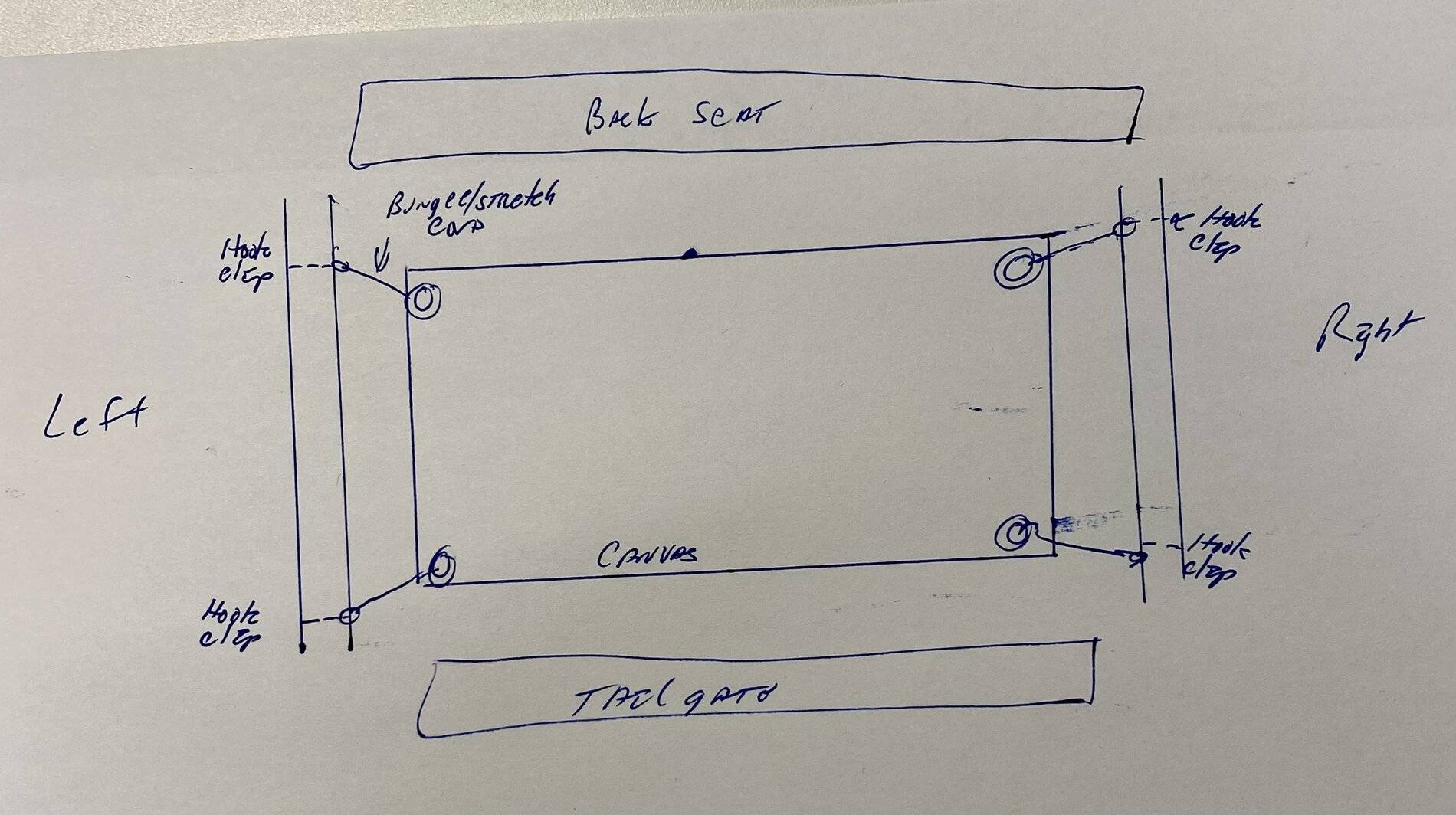

Has anyone tried to use the hook-clips in the rear cargo area to make a cover?
I put together the following (very crude) drawing of something that I think will work with some further engineering from the group. Essentially, use a thick canvas rectangle, put a grommet in each corner and suspend it between the hooks using stretch type cords with removable hooks. This could be easily put up, and taken down, within seconds and keep prying eyes from seeing what is in your cargo space.
Any help bringing this idea further with suggestions, materials, construction techniques, would be great. (Please also pardon me if this idea has already been posted.)

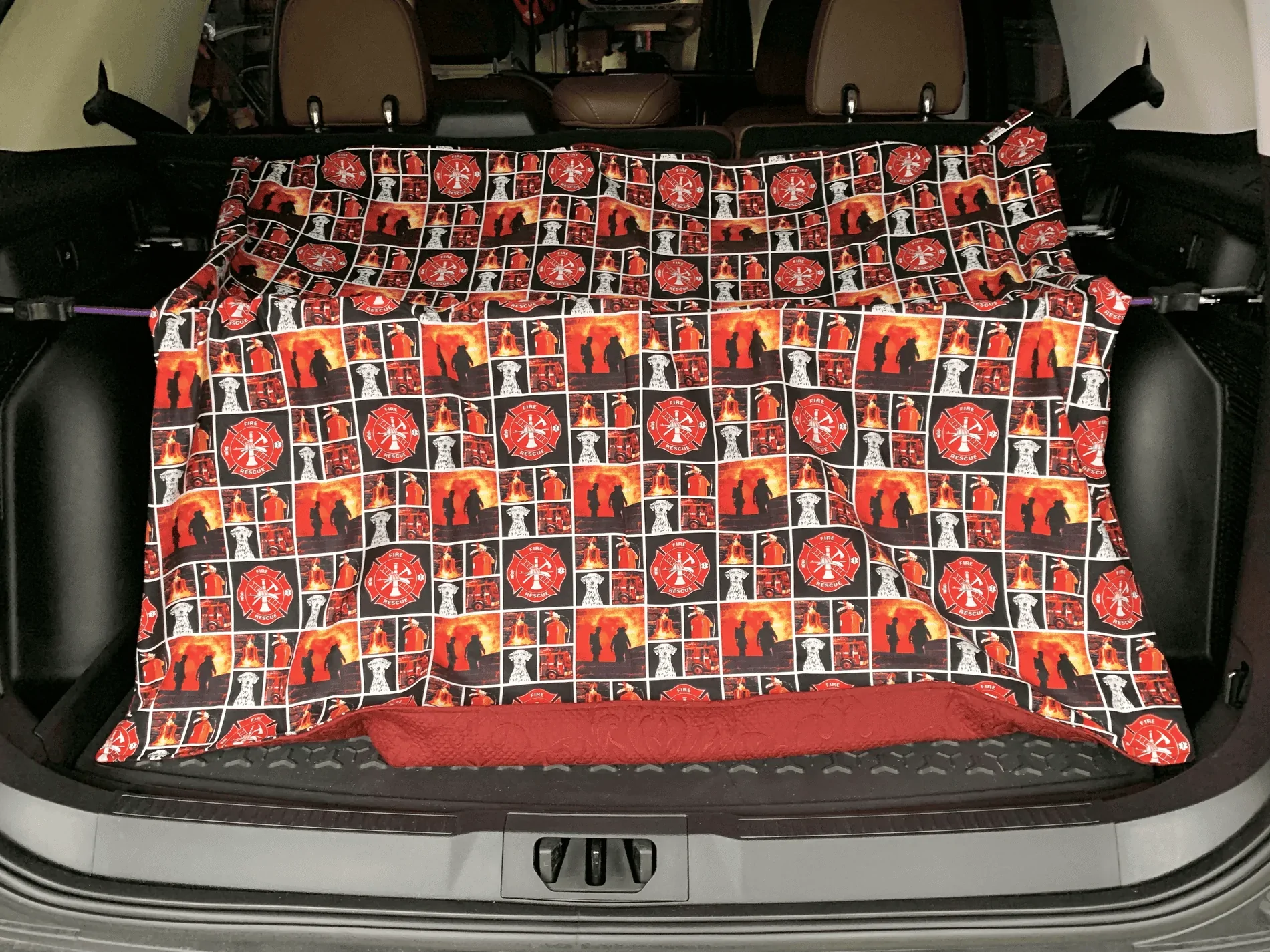

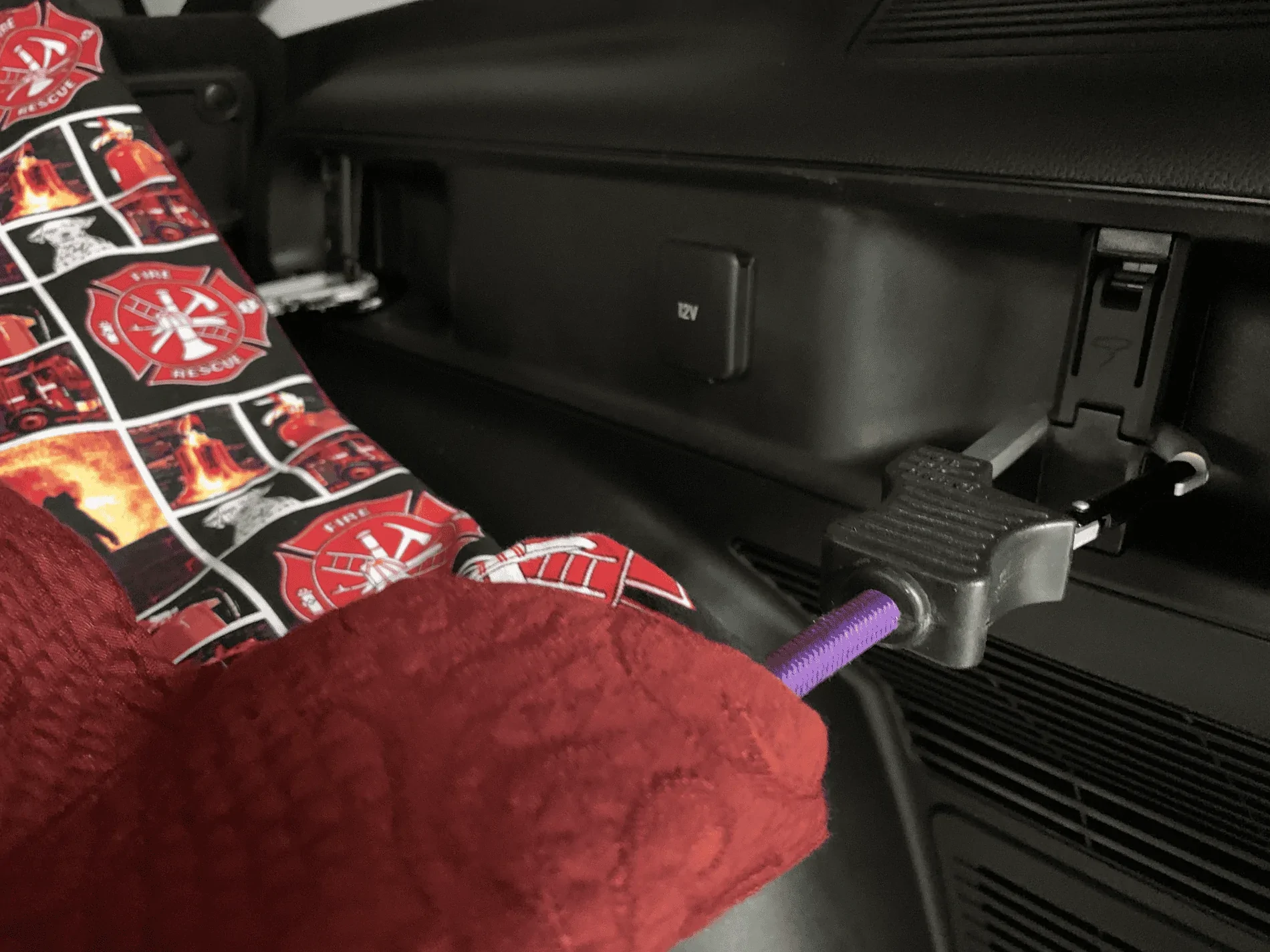

We put this together using bungie cords sewn into the cover. On the seat side we just tucked it into the seat back on our OBX, we tried velcro but it wasn't strong enough. I like to think of it as a temporary fix.

WOW! The last week I've been trying to come up with a concept like this myself! Amazing. I don't have my Bronco yet... So I haven't been able to take measurements, but it looks like you're on the right track.
That being said.. I have a few sample swatches of different materials coming in the mail.

I've got the cargo mgmt system but I have some thoughts on a cargo cover.
Yours looks good, one addition to suggest;
Sew in a dowel rod along the front edge and use elastic loops sewn into the cover and hook them over the back seat headrests. Leave one end open so you can remove the rod of you need to.

I'm going to prototype this design this weekend...probably go to Home Depot and just get a canvas painters drop cloth, cut it to size, install the grommets, get some real small 'stretchies' and see how it looks.
I'm figuring <$15 in parts.

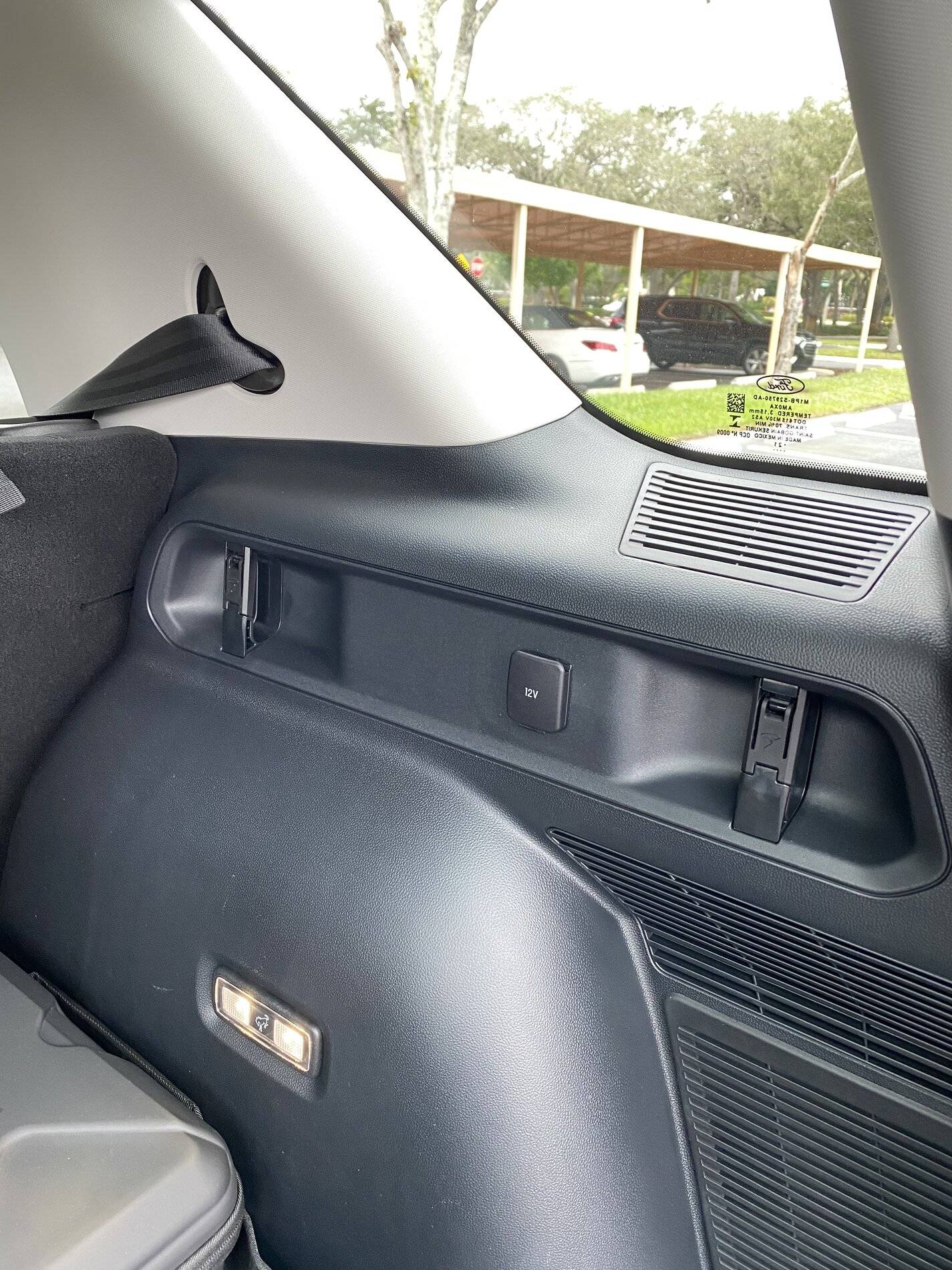

Do you have the dims between the clips?
Or can someone on the forums get me the dims between the clips? (I don't have my BS yet)
