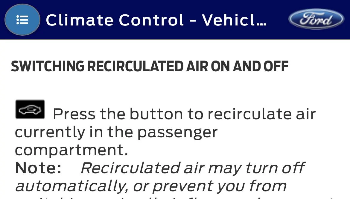

I think there is something else going on here besides setting the airflow to the windshield. The owner's manual states:
Note: Recirculated air could turn off or be
prevented from turning on in all air flow
modes
except maximum cooling to reduce
the risk of the windows fogging up.
This clearly says that directing airflow to the windshield does not prevent the HVAC system from controlling the recirc feature.
To OP, the HVAC system shuts off recirc to prevent the build up of humidity inside the car which can fog up the windows. It's probably not that much of an issue during the day, but fogged up windows at night can be dangerous. This is a safety feature, so I wouldn't expect Ford to change it any time soon.
