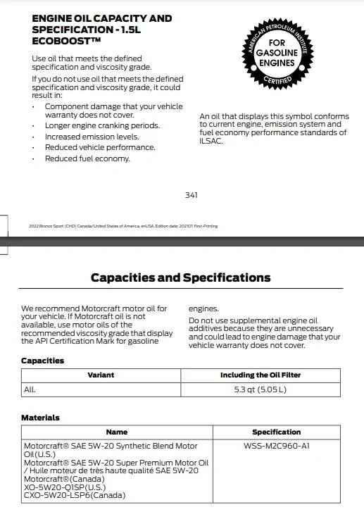

According to the BS owner's manual it's 5.3quarts for the 1.5L engine:

So, sounds like all yours take the 5.3 quarts stayed in the manual. Are any of your oil pans the plastic composite material? Or steel?

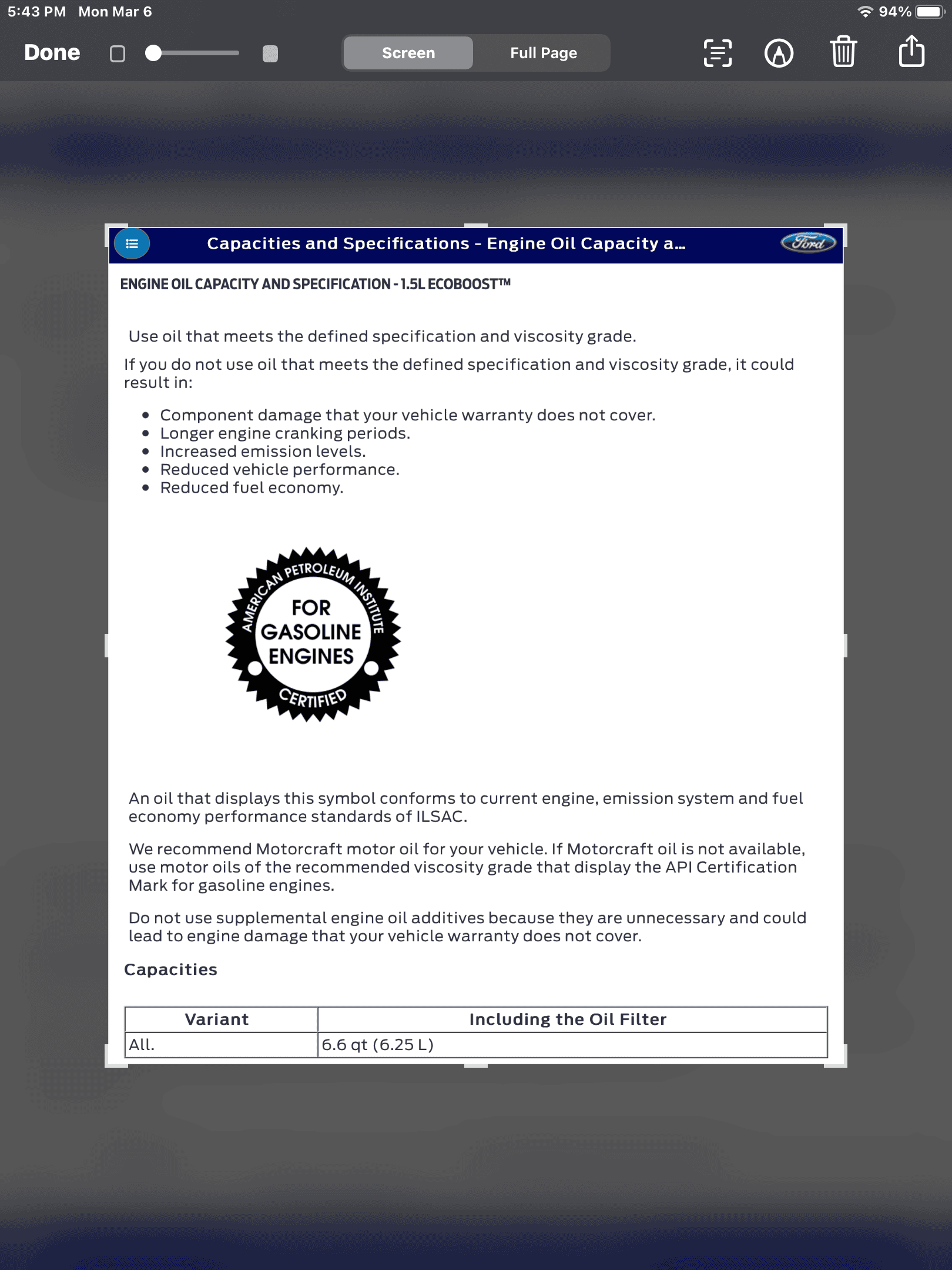

My 2022 Outer Banks purchased 1/13/23 take 6.6 qts. There was an addendum card in the owner manual packet.

2022 Bronco Sport owner’s manual addendum in
my Big Bend said 6.6 quarts for 1.5 cars built after
10/2021

Thank you Michaell for the information on the addendum card, I just found it and added the correct amount Of oil, now I know!

Yes I bought one this week and the card fell out of the paperwork....6.6 qts.
