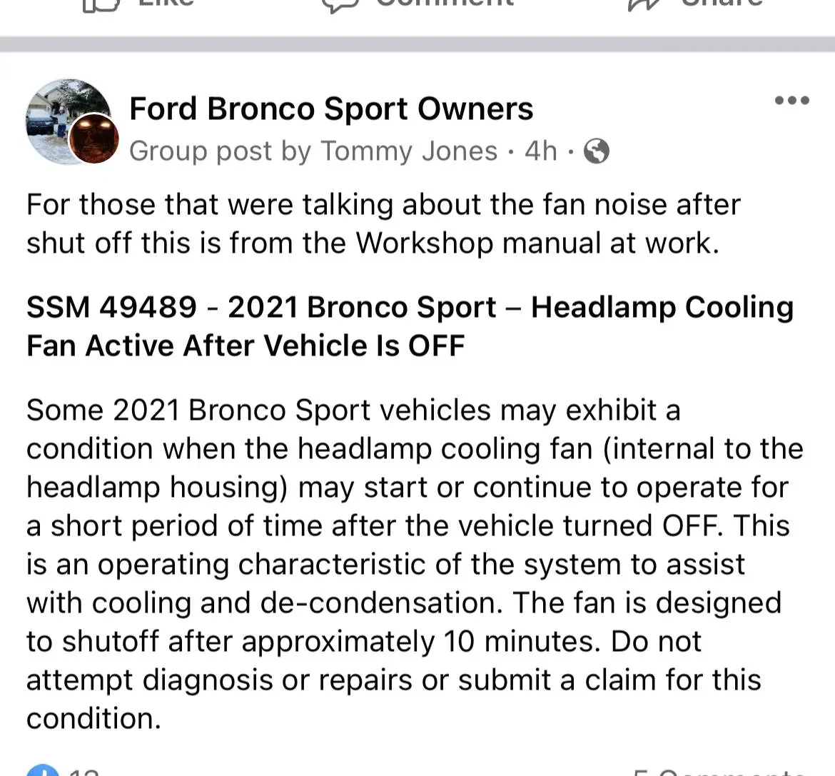

The Bronco Sport sits quietly in the garage. Opening the door triggers the headlights to come on. After closing the door you can hear a noise from the headlights for 10 minutes. What is that? My guess is the LED headlights have a cooling fan? Or is it something unrelated?

I think this is most likely what it is too. There was more discussion about this in another thread here.

I assume this is normal because it happens with mine too. The "whirr"/fan noise lasts for about 5-10 minutes then goes away. It does this even if I just unlock and open a door.

Yes. I noticed it when only opening the door. The noise is on a timer. It’s hard to believe that it would need to run for 10 minutes with just opening the door.
