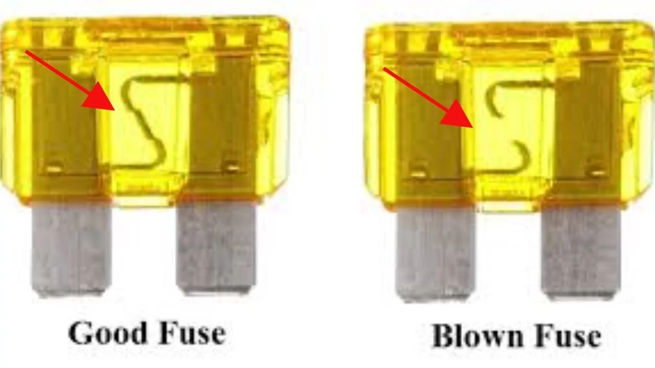

So both the hatch gimble lights are out on my badlands. I'm also having some washer fluid leakage somewhere in the rear so it's possible it's related.
Anyway, I wanted to confirm it was a blown fuse on the two lights, but I couldn't figure out which fuse was correct.
Fuse 57 is called "flood light", this is my best guess, does anyone have any insight on this?
Thanks

I believe the label is plural; "Flood Lights." That would appear to be the most likely candidate. Shouldn't be that difficult to pull it out and check.

Hey Mark,
Yea i ended up just giving it a go. I didn't want to bother without a spare fuse on hand but there was an extra 5A fuse in there so I switched them out and the lights came on.
So for future reference to anyone reading. "Flood lights" are the hatch gimble lights.
Now I need to sort the washer fluid leak cause I imagine I'll blow the fuse again otherwise :crazy:
Thanks for the input!
