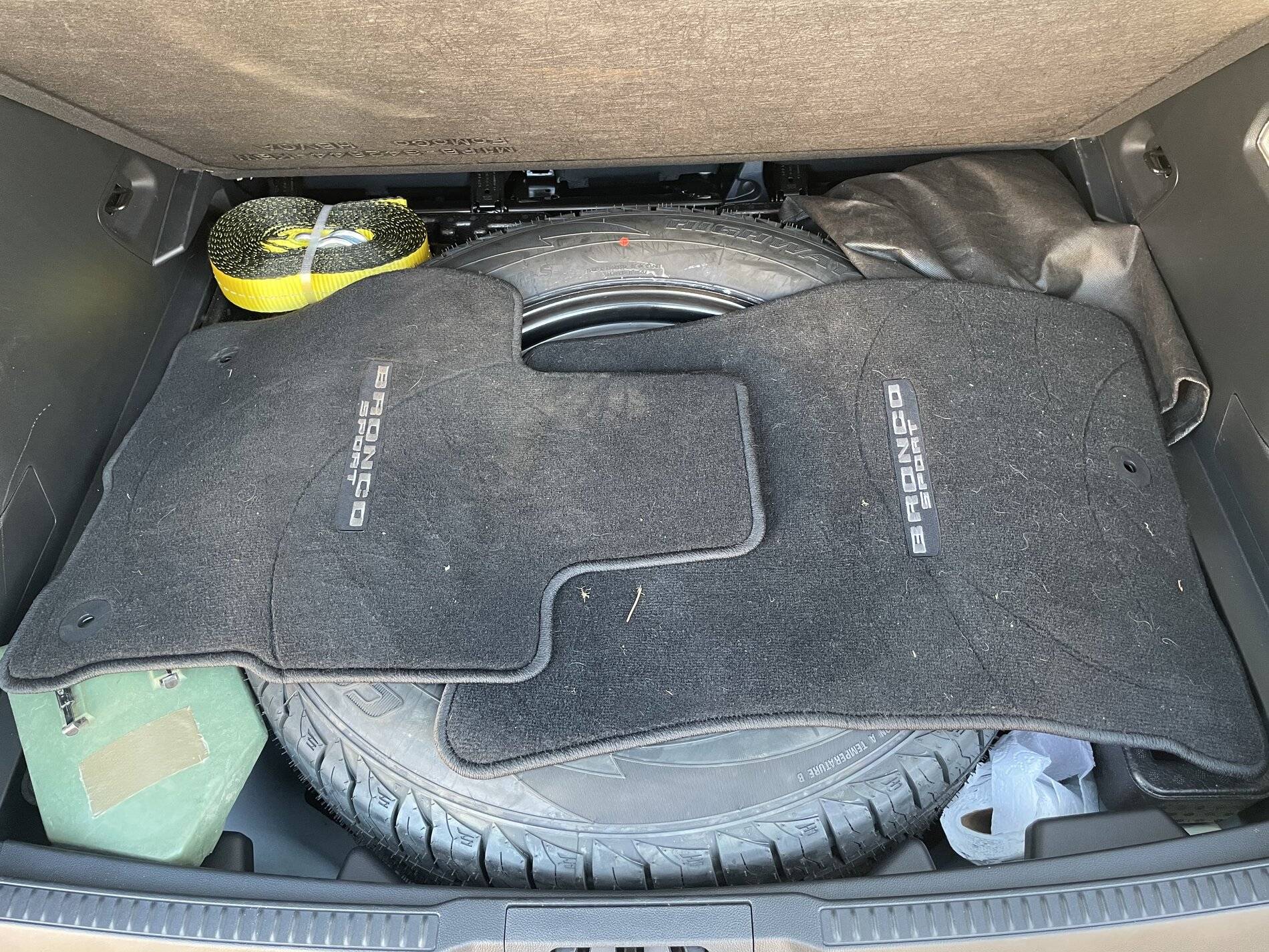

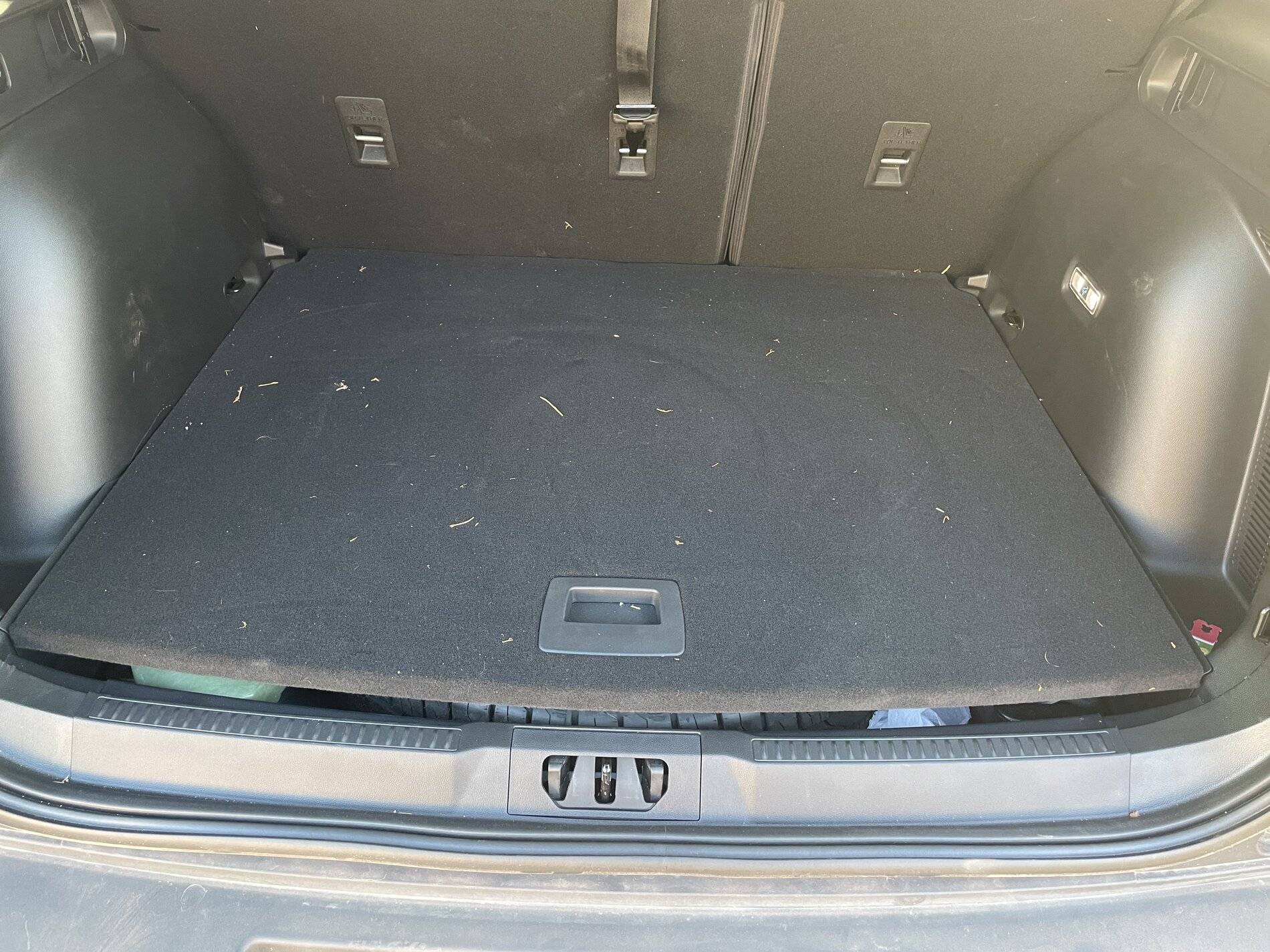

I did the toyo at3’s for reference on the stock rims . I was also able to finangle a steelie 17” rim with spare cheap tire in the back tire compartment. I can get you the eBay link for the rim if you want it’s the same backspacing. Called “pacer fwd steel rim 5x108 bolt pattern “ 17x7

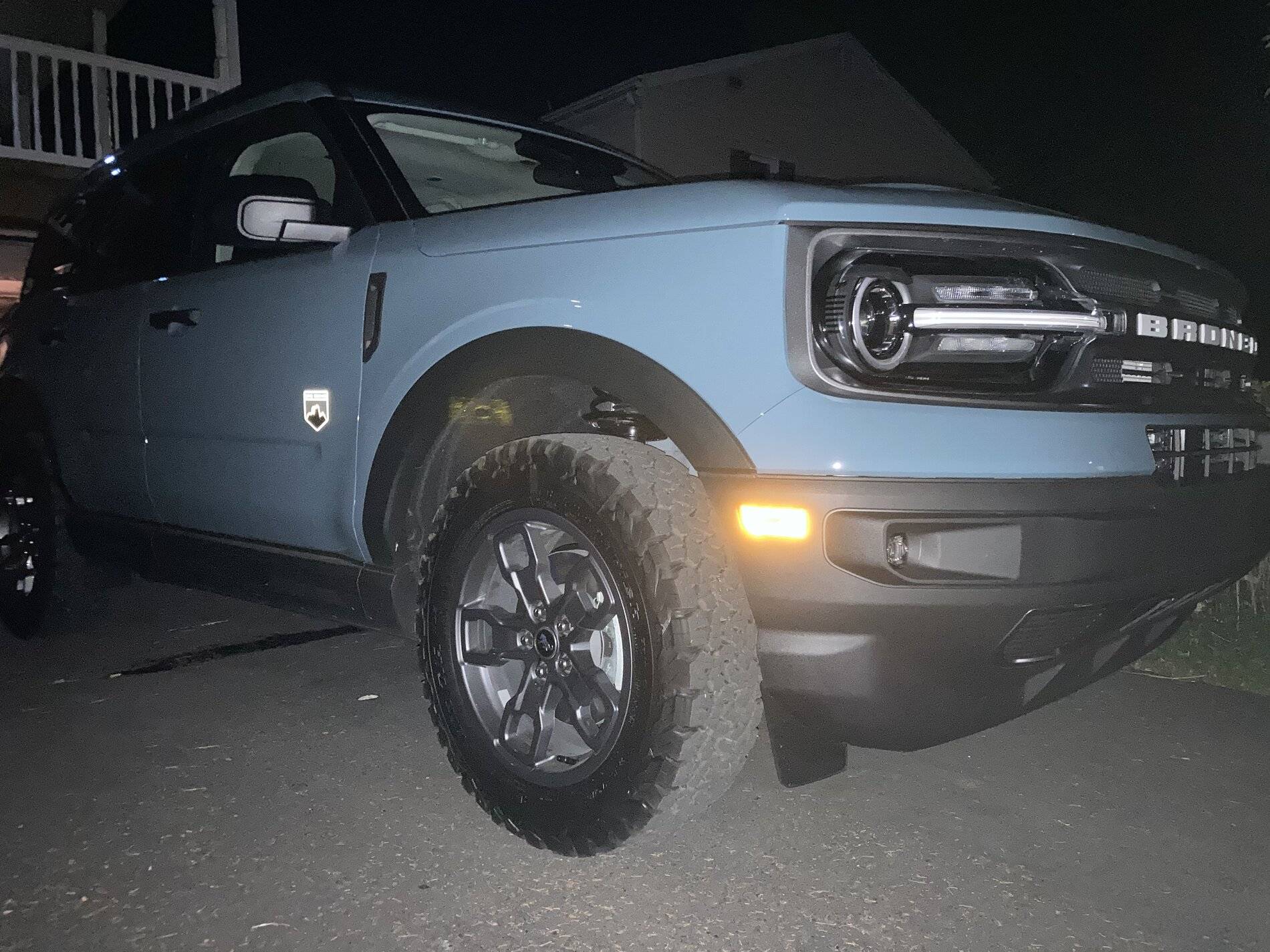

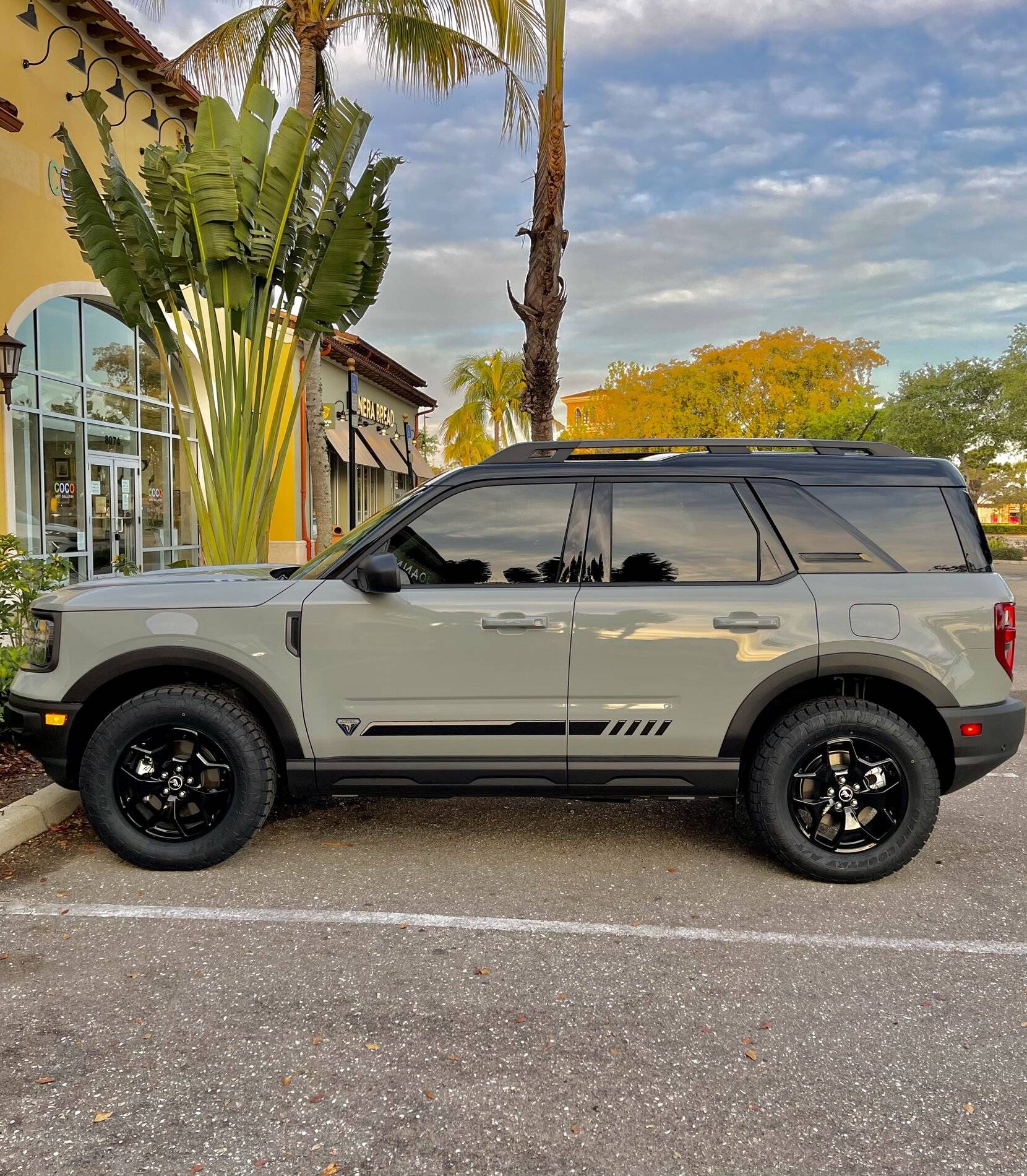

I did not wrap her handles. They are shadow black.
Ford Bronco Sport Has anyone kept stock rims but upgraded tires? 2A81FC61-366D-43D0-9A6F-67B86DE16F39
I love the cursive Bronco emblem. Where did you get it? I think it would look great on the side just past the gray vertical piece that's in front of the front doors (I have no idea what that thing is called, but hopefully you know what I mean).

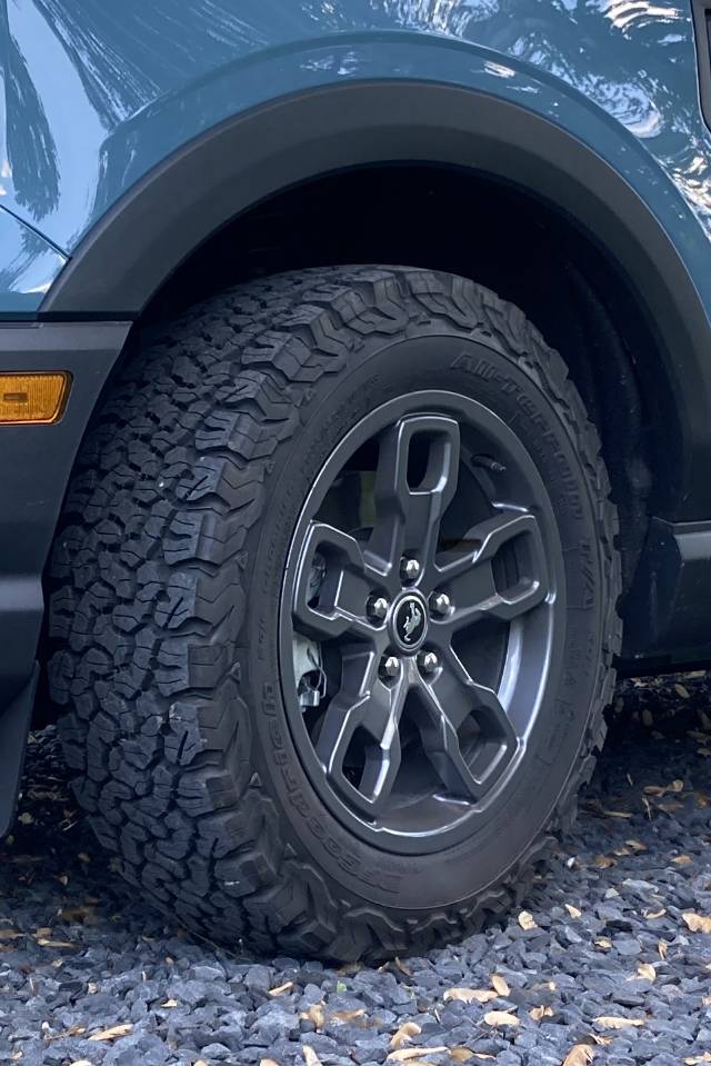

I went with 245/70R17 Toyo AT3 on my FE. I have small rub on the pinch weld on the rear of the front wheel well but I will be cutting and re-welding that soon.
I wanted to put LT255/75R17 K02 but it did not fit at all. The biggest factor in my tire choice was not putting an 8 or 10 ply tire on this light vehicle. I was looking at all options 4 and 6 ply. I cannot believe Ford is using the wild peak as an upgrade in tire... blah.

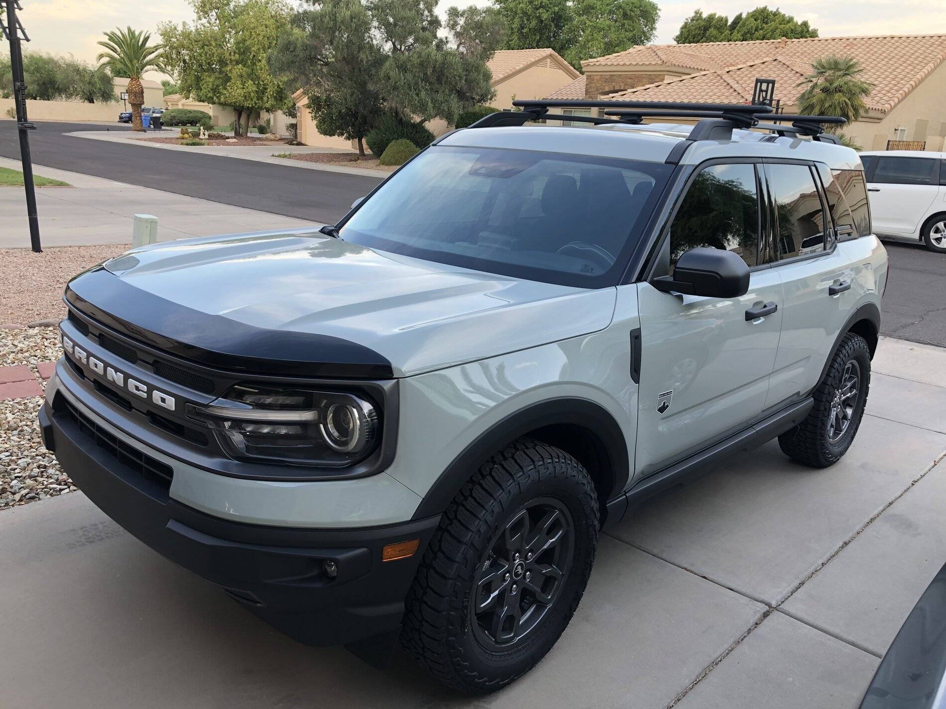

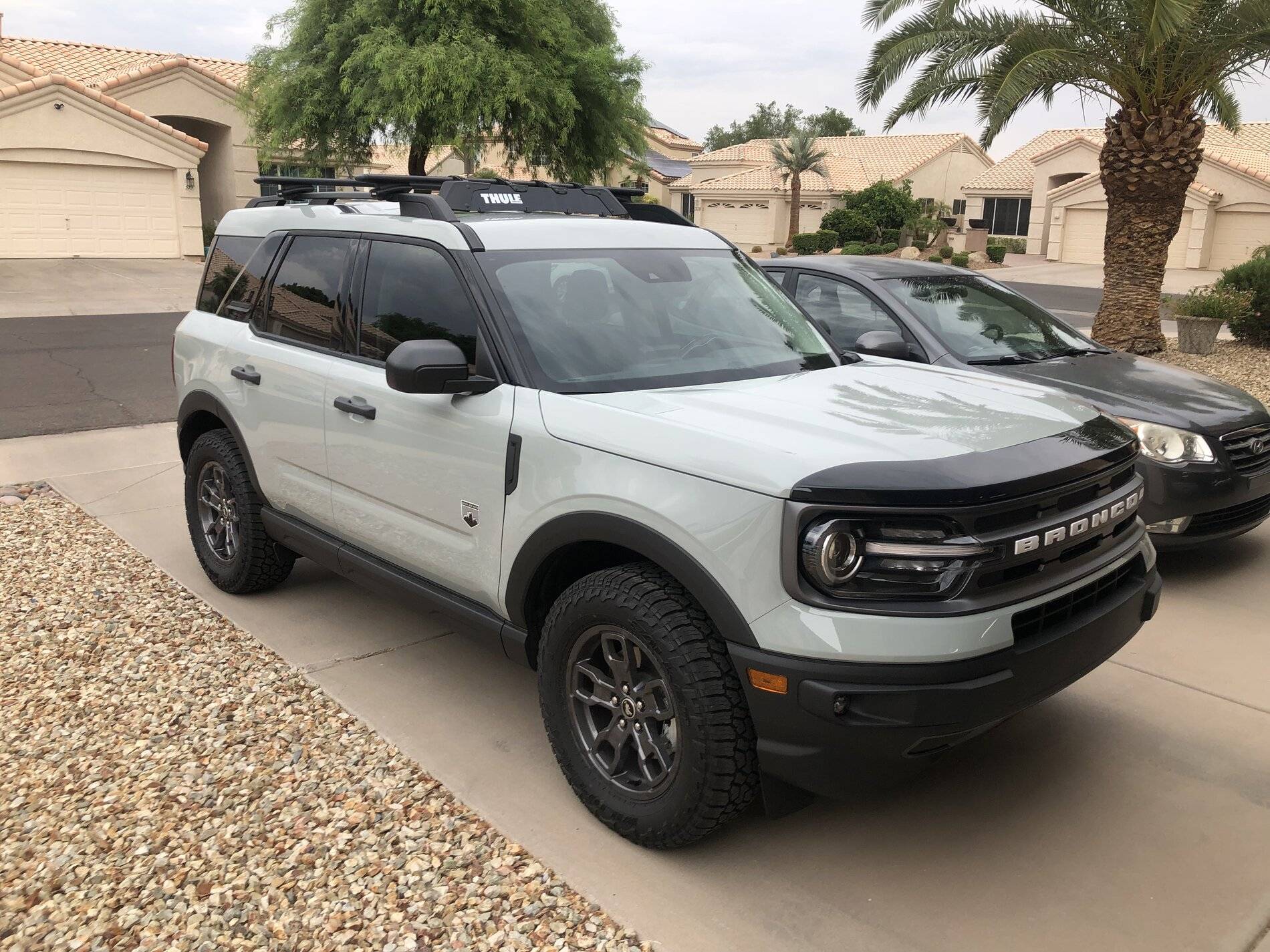

What’s the biggest tire size that can safely fit on the BL 17” rims? I’ve been wanting to upgrade to some 245/65s but I’m also trying to stay married and 2k on wheels/tires might just end that ?.
245/65/17 Falken Wildpeak AT3/W’s. Overall, pretty satisfied. Typical drawbacks of AT tires. Let me know if you have any questions.

Ive got a pretty solid rule of not replacing brand new tires with brand new tires.... this thread has me rethinking that rule
Haha. Makes sense. The stock tires are pretty garbage though. My plan was to eventually buy another set of cheaper wheels and just run the stock tires off season or in between. So as to not waste them. It got me rethinking as well and I caved. ? Glad I did.
