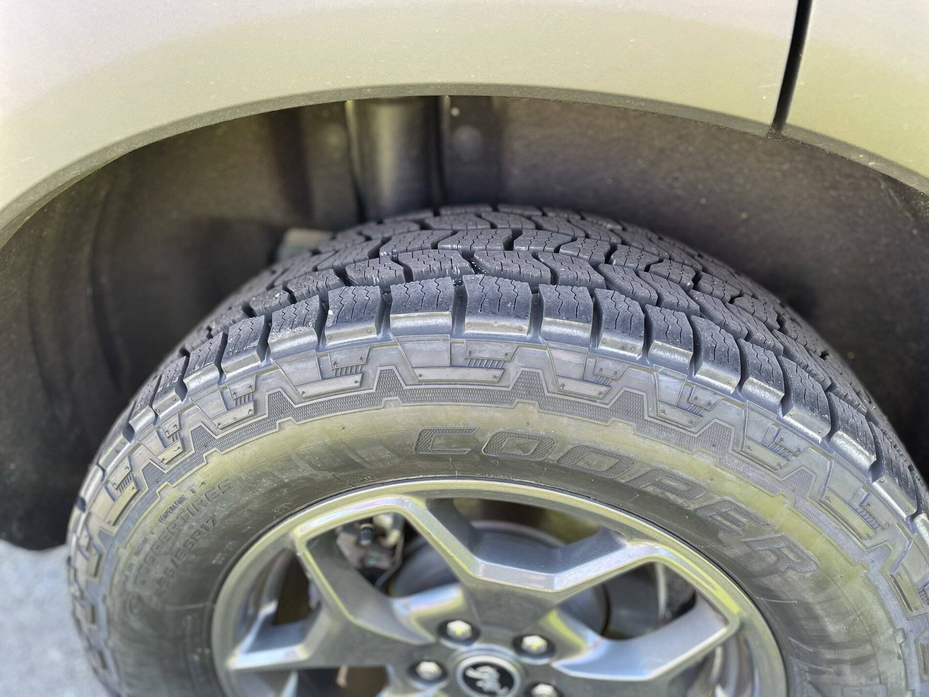

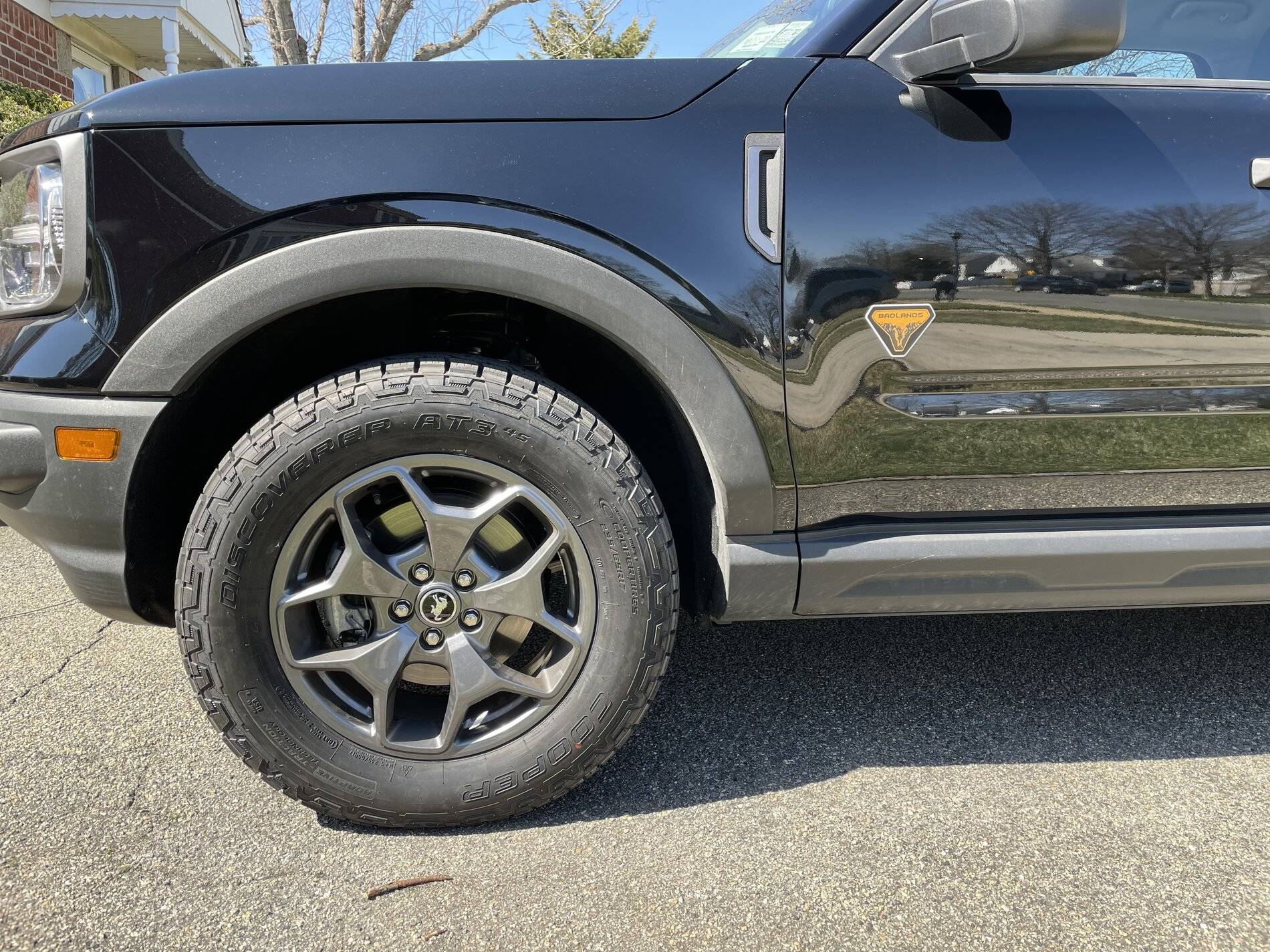

went with the Cooper Discoverer AT3 4S at 235/65/R17. kept the stock rims... for now. Love these tires
