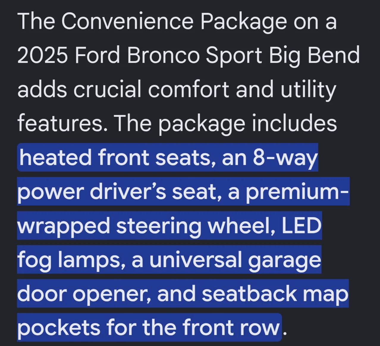

My 2025 big Bend with black diamond package has the home link buttons in the visor. I also have the convenience package which included fog lights. I am almost certain the homelink buttons are included in the convenience package.
Edit:
I thought I would Google it out of curiosity and this is what I got. I was right about the convenience package.

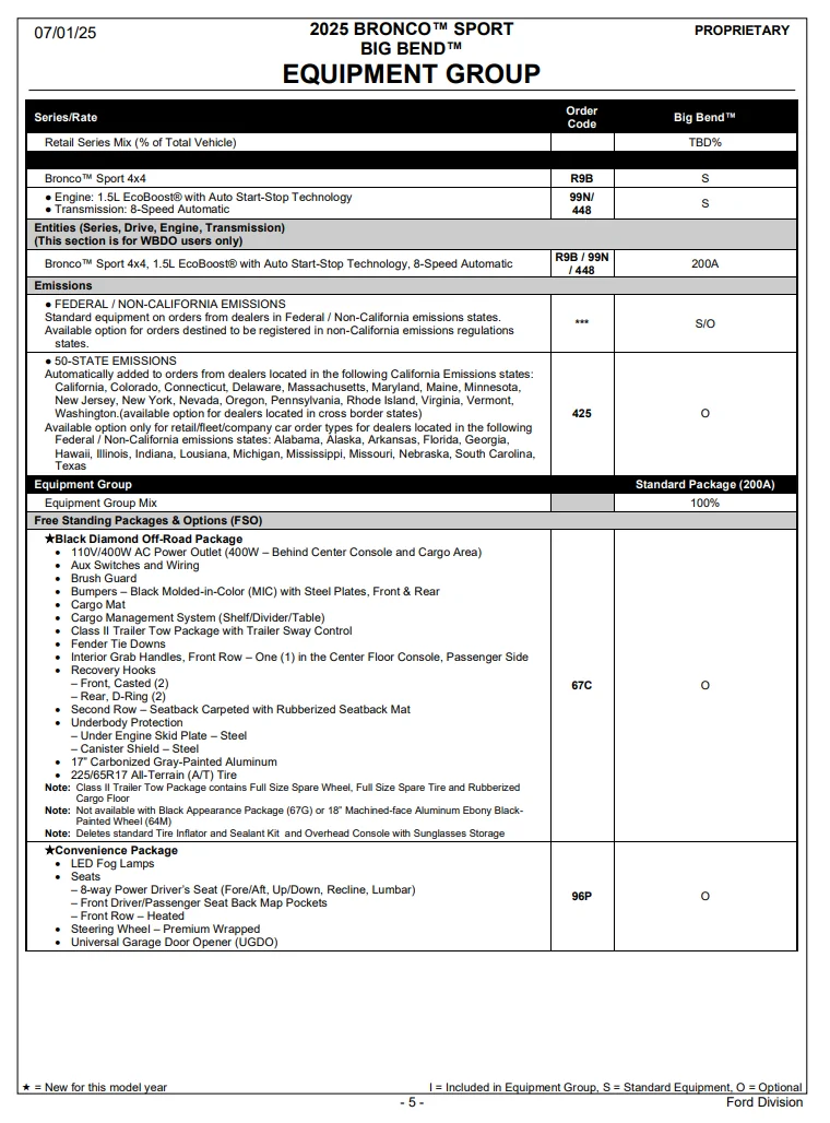

Correct. According to the Ford Order guide for the '25's, they were available on BB and OB as part of the Convenience Package (96P), standard on the BL.
