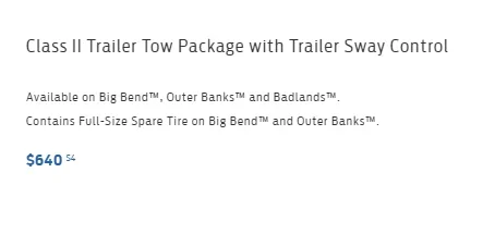

Confusing as the "full-size" tire was part of the $640 Class II Tow Package. See attached:

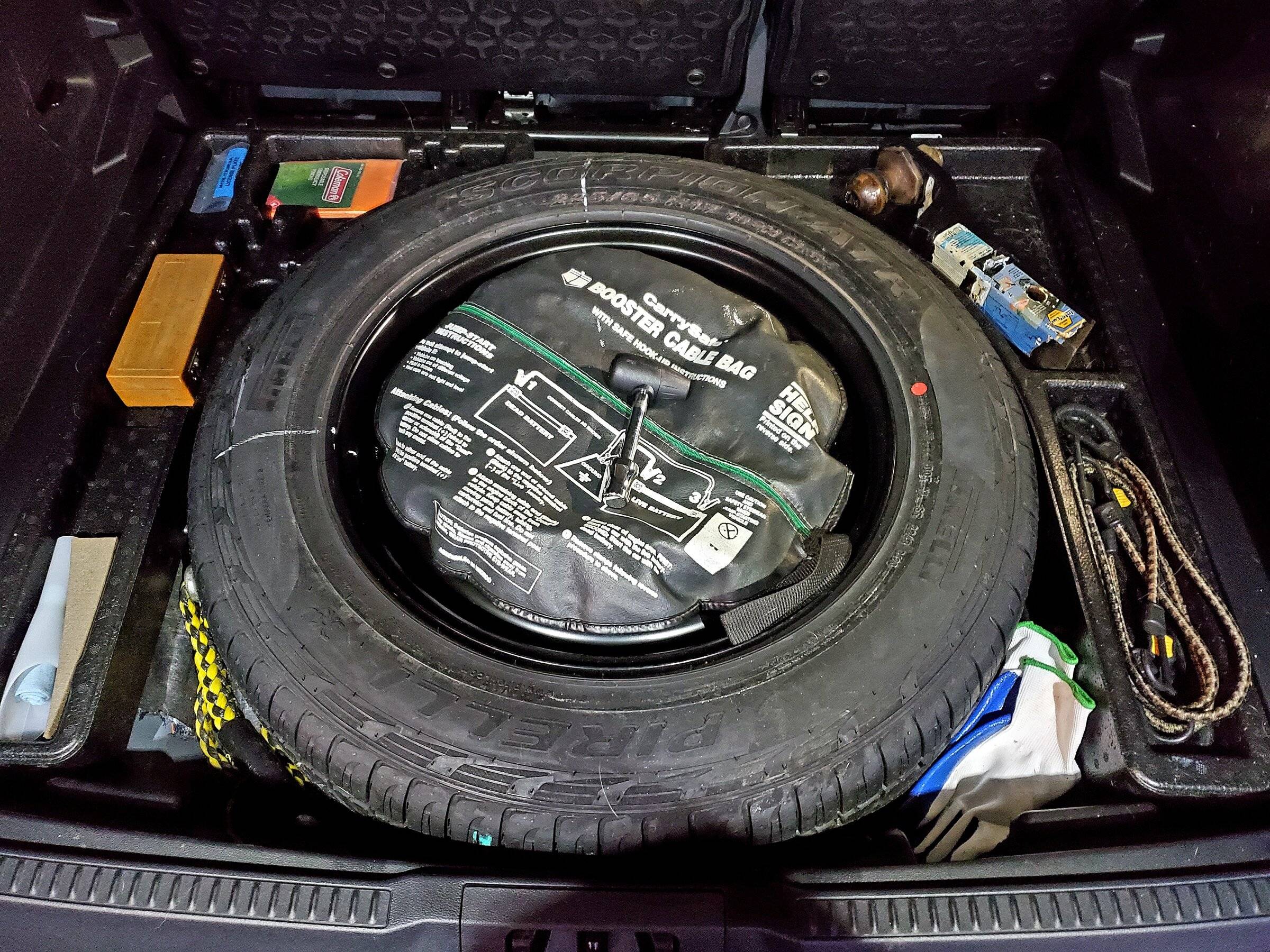

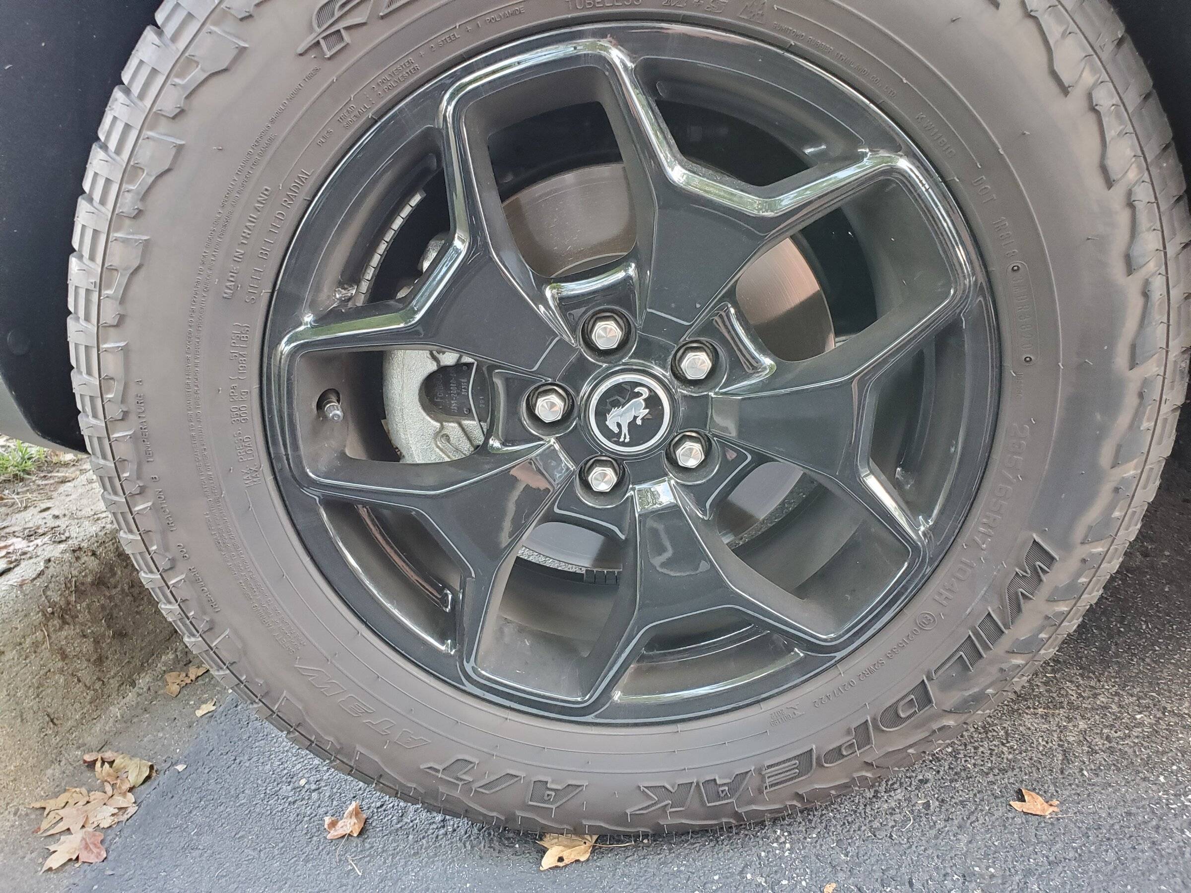

FWIW, my BS FE has 4 Faulkin Wild Peak, but the full size spare is a Pirelli Scorpion ATR.
Also, the wheel is the same size but doesn't match.
