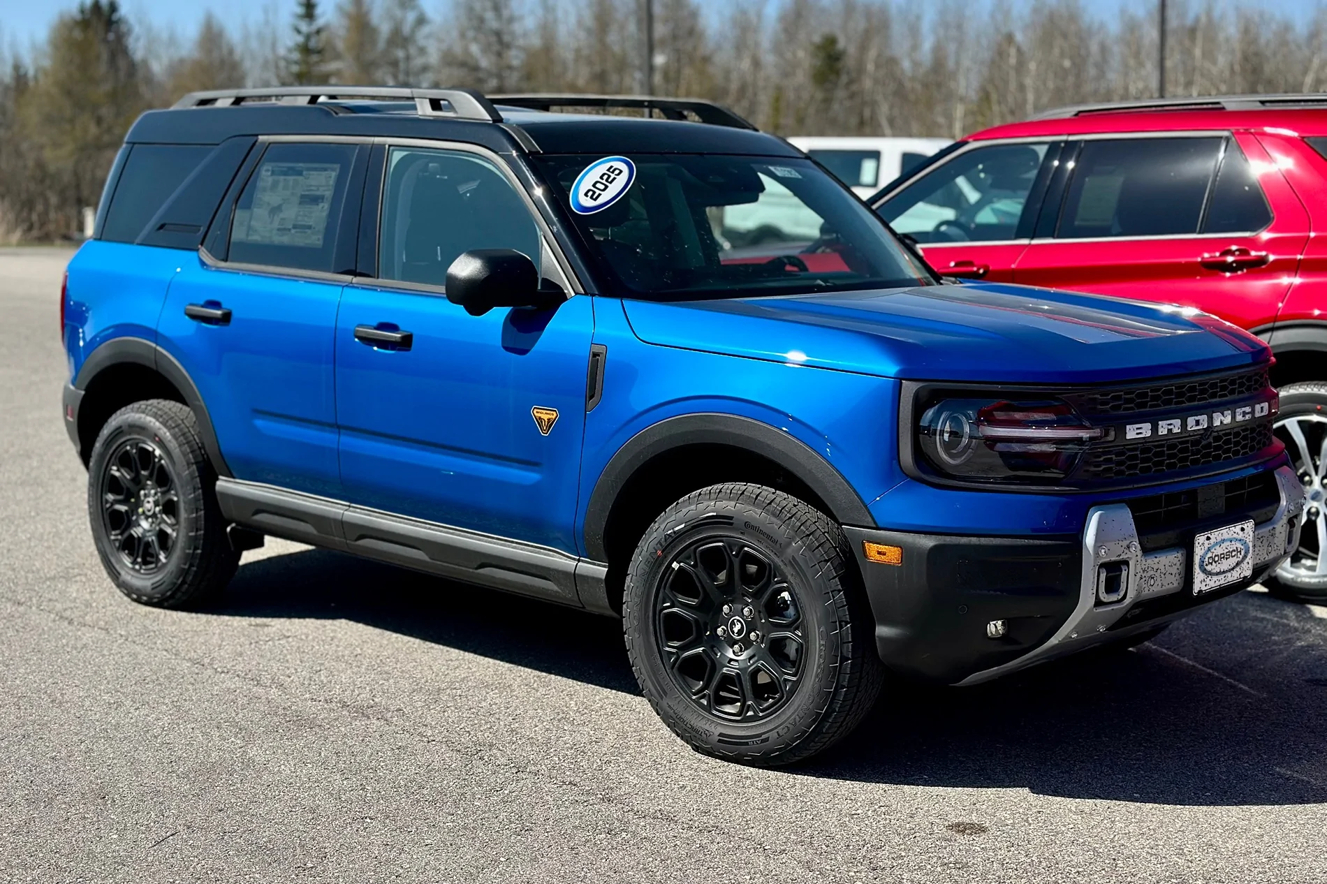

Here’s a couple pictures. First one is the day before i took delivery. I know the dealer plate covers the bolts. However, in your photo, you can see in the plate bracket, there’s a recessed area for the bolts. Behind it sits flush to the bumper. You won’t be squashing anything. Promise.

Here's a picture of mind the day I bought it. I zoomed in on the front bumper so you can see the plate holder was installed before the license plates on there. So yeah those four bolts lying right up perfect.
