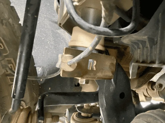

Ford Bronco Sport Frankenstein lift idea 1671725938430

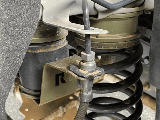

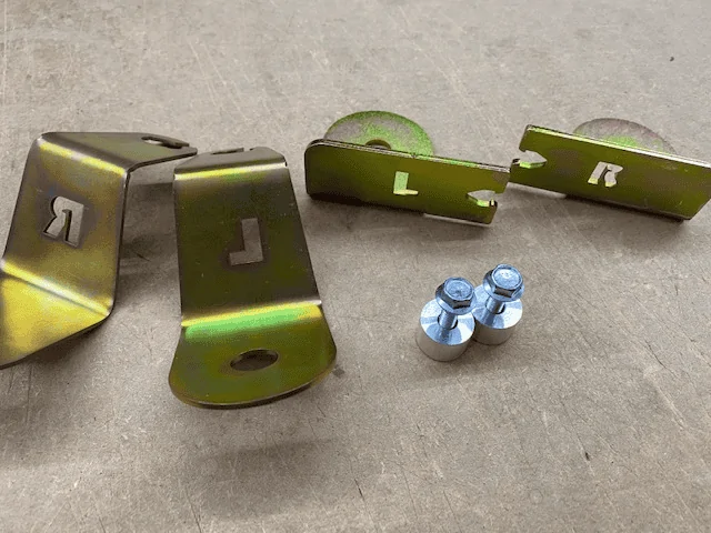

HRG's Brake line relocation kit pics.
Ford Bronco Sport Frankenstein lift idea 1671725977330
Ford Bronco Sport Frankenstein lift idea 1671726015211
