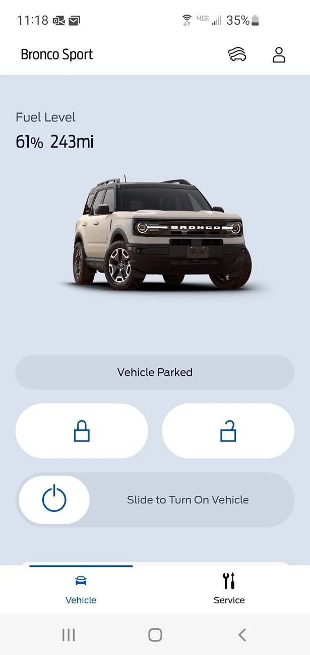

Is this something new for the Bronco Sport? I don't see that feature in the version of the FordPass app on my Android device.
This is on my android app.....ETA I'm on Android 12

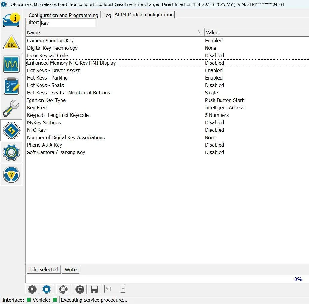

I wonder if it is simply a matter of enabling the required PIDs using Forscan, and maybe removing and adding your vehicle from the FordPass app.
Or is there some additional hardware required?
Seems there are several pairing methods (BLE, NFC, UWB) from some of the PID options.
Ford Bronco Sport Ford Says Phone As A Key May Not Work For Some Owners (with Android 14 devices) APIM KEYS

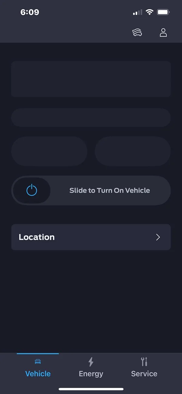

I tried changing the following PIDs, and removed and re-added my VIN to FordPass.
Digital Key Technology: NFC+BLE+UWB
Phone As A Key: Enabled
Was hoping to see a FordPass option to add my phone as a key. :sadface:
After I jumped through some of the FordPass screens, the FordPass app displayed an Energy tab at the bottom and some greyed out buttons. Unless it's a bug in the FordPass app itself. I seem to recall seeing this in a prior FordPass app version.
