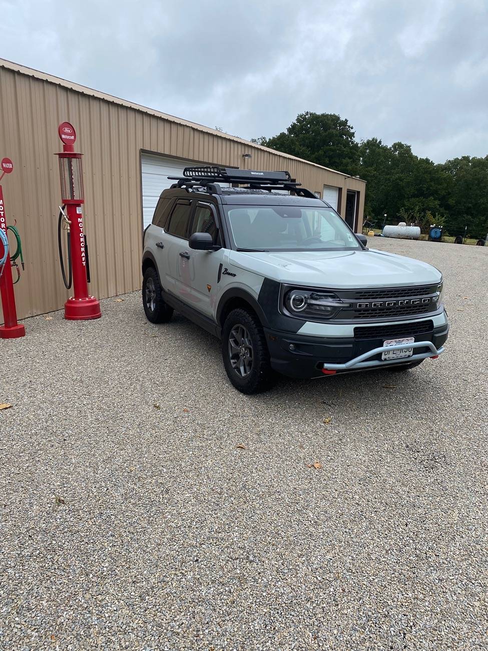

I did this and have D ring as I need them when I need them

Looks great. How/where do the D-Rings attach?
they hook under my frame front and rear I only use them when I am playing and attach the tow lanyards when I am there but I have never had that much mud or water to affect my play time I have all of Fort Hood now Fort Cavazos witch is the largest Military Post in the US so many Tank trails to play on.
