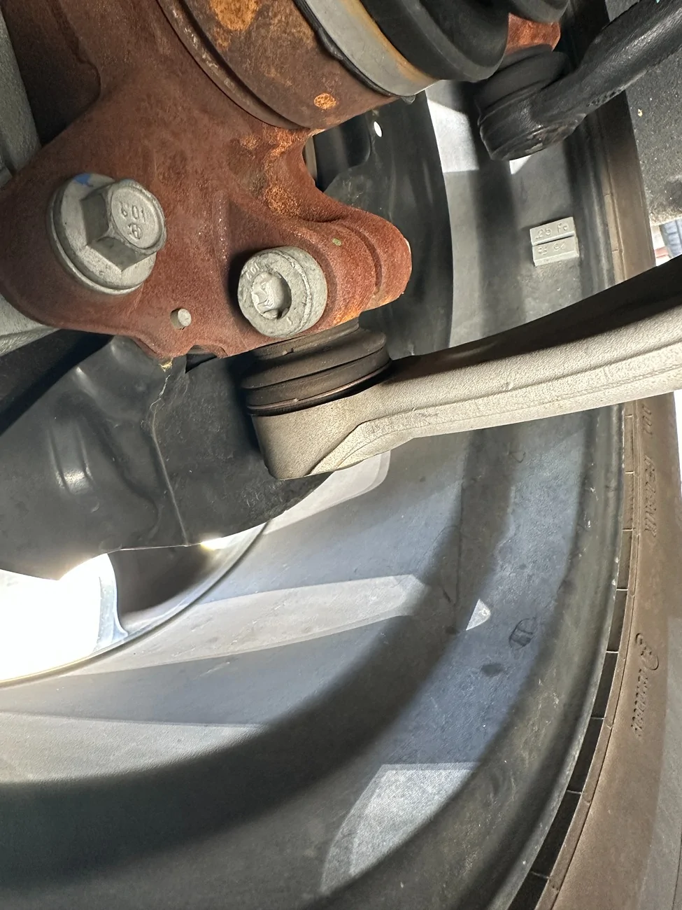

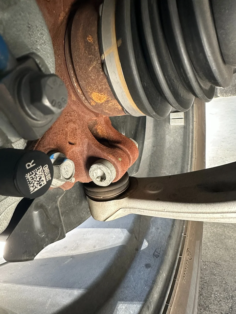

Here are a couple of pics of the passenger side lower ball joint.
Ford Bronco Sport Ford Issues Do-Not-Drive Advisory for Certain 2021-2026 Bronco Sport; Owners Urged to Contact Dealerships Immediately (June 1, 2026) LOWER BALL JOINT 1
Ford Bronco Sport Ford Issues Do-Not-Drive Advisory for Certain 2021-2026 Bronco Sport; Owners Urged to Contact Dealerships Immediately (June 1, 2026) LOWER BALL JOINT 2

So odd. I wonder if this might be the tip of the iceberg. There appears to not be a problem with design nor a defective part. Solely a sporadic assembly issue, a process issue. The sporadic part doesn't seem logical to me. Time will tell.
It's a QC issue.
